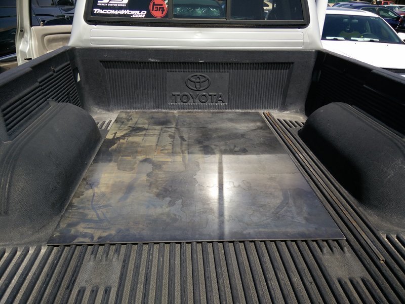

    :eek: Either you got the deal of a life time or you go a bunch of scrap? Where did you go to get steel for that cheap? :confused:
  2. May 13, 2016 at 8:31 PM
    #642
    Delta00
    Delta00 ᕕ( ᐛ )ᕗ
    Sep 16, 2013
    #112633
    4,139
    Troy
    Chandler AZ
    2002 Toyota Tacoma 4WD
    Check Build
    It was a 5x4 sheet of 3/16. I saw it sitting in the welding shop I go to school for just gatheing dust... Asked if I could buy it and how much. $30 was the price haha

    Lucky deal then. Wish I had that sort of deal around hear :pout:

    I dont think ill get as good a deal when i get my 2x2 and 1x1 tubing...
  5. May 13, 2016 at 8:55 PM
    #645
    cbechtold
    cbechtold [OP] IG: @corybechtold
    Jan 19, 2014
    #121010
    4,034
    Cory
    Pleasanton, CA
    2001 DCSB SR5 TRD 4x4
    It shouldn't be much more expensive. 2x2" in 3/16th is something like $14 per foot and 1x1" in .120 wall (1/8") is like $5 per foot, if I recall correctly.
