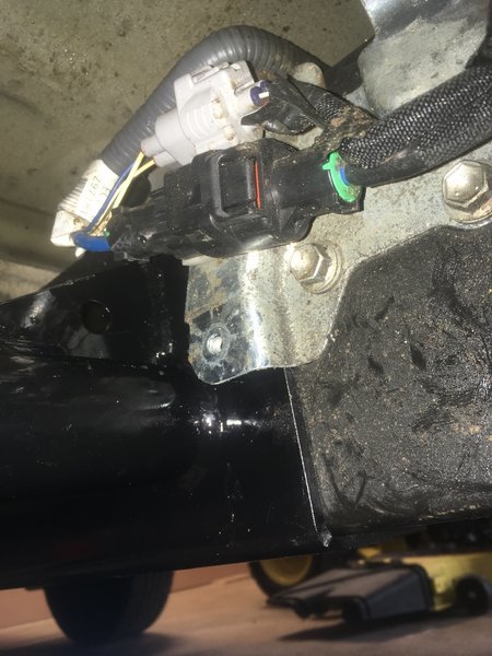

    Update: Cbi sent me the wrong style of sliders. I ordered ones with a kickout and these were straight/standard. After some frustrating back and forth emails I finally got the return shipping worked out with them. They then relatively quickly shipped out new sliders with a kickout. However, now I'm at a standstill with the installation since they seem to have fit issues. (I'm encountering obstacles that the instructions do not mention for my 2016 DCLB). I'm nearing the end of day 4 with no response from them whether these sliders were fabricated correct or not.

    That's interesting you're having fit issues as well. I don't recall seeing any instructions on their website regarding drilling for their bolt-on sliders (that's why I bought them!) My issue was on the passenger side; there's a wiring harness bracket and plastic cover that clearly need to be trimmed/relocated to make the sliders fit.

    Problem area

    The 2nd gen versions on their site say some drilling is required, but the ones I got are the 3rd gen specific ones they show (which say no drilling required). I emailed them and it sounds like they are shipping the same model out for 2nd and 3rd gen together now. I wish I could help about the wiring harness.. are you able to unbolt it to pull it back and work around it?

    Our solution was move the metal bracket one hole forward. The metal bracket is bolted to the chassis using two M12 bolts. Remove the bolts, move the bracket forward so now the bolt hole bolts into where the front hole was bolted. Tighten and put plastic cover back over. It's a tight fit because of the wire loom going into the cab, but it does work.

    Seams like a viable solution. Wish I had some direction earlier from the company regarding this. I also wondered if it was a problem specific to double cab long beds (that's what I have)
