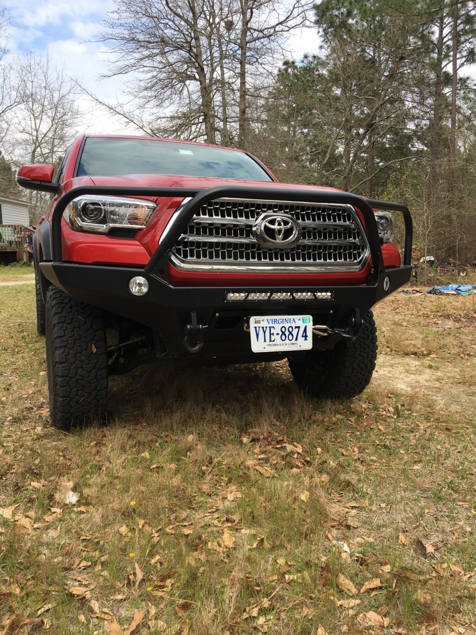

    I had the same CBI or ARB dilemma when I was deciding which bumper to go with. Like you, I really liked the look of the ARB bull bar, but it just sticks out too far in front of the vehicle for my liking. I do a moderate amount of off-roading, so I felt like the T-3 was a better choice. I also have to use parking garages for work, so I really didn’t want to add that much length to my truck since my DCSB already takes up a lot of room. The CBI looks great in my opinion and it’s plenty stout. I don’t know if it will offer as much protection against deer/other large animals as the ARB would, but I guess that’s why we have insurance.
    I’m running a Smittybilt XRC 9.5 in mine, it fits perfectly with the solenoid mounted over the winch motor. Accessing the solenoid through the cutouts in the bumper is pretty easy as well.

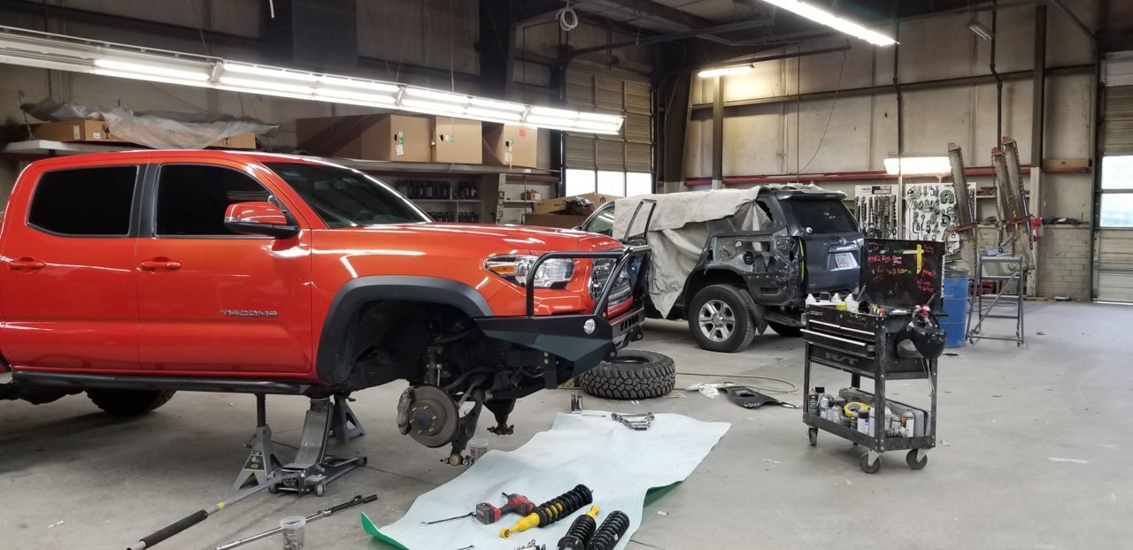

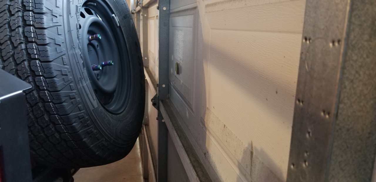

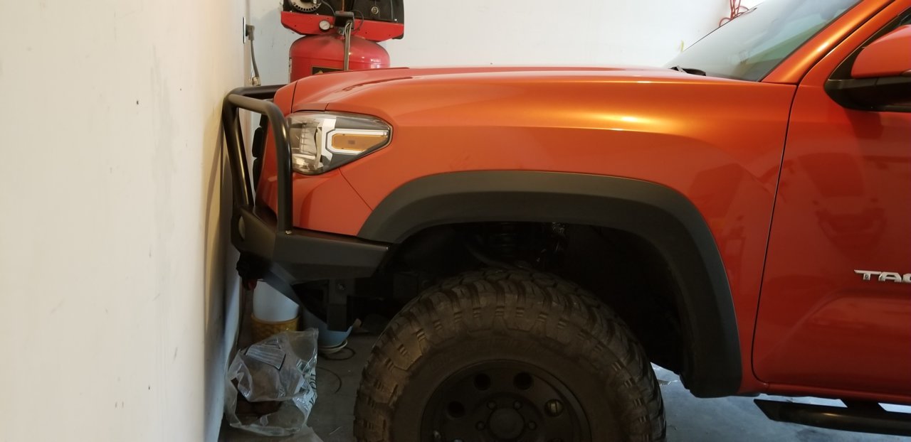

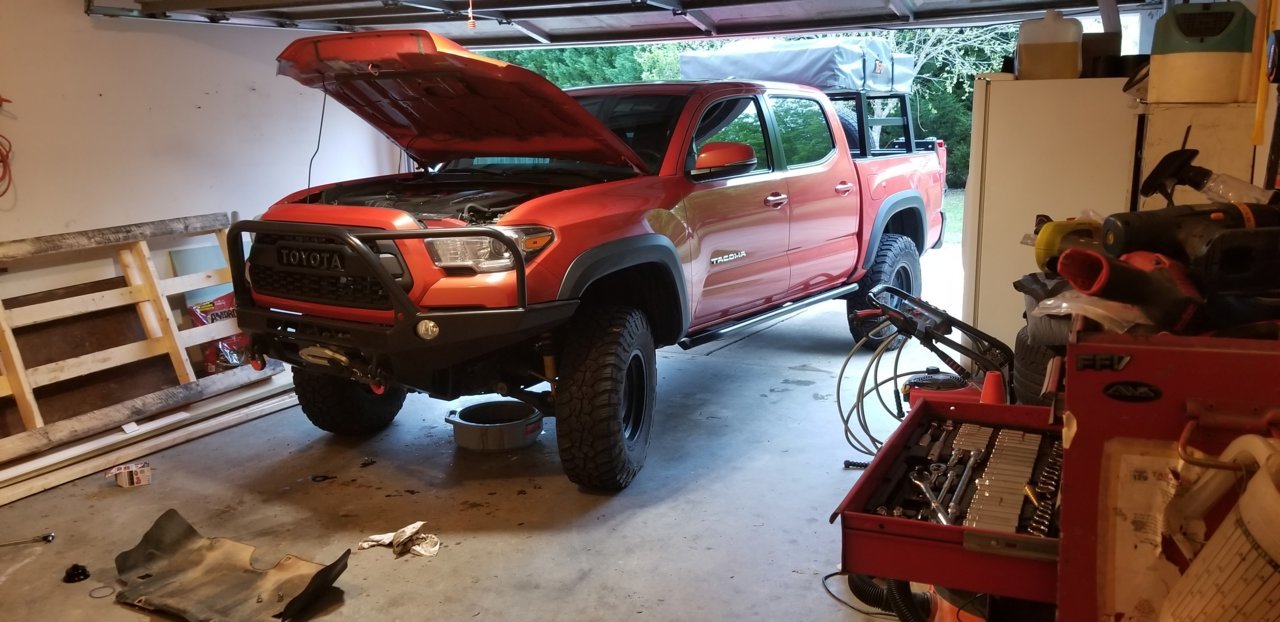

    I went with the t3 . I'm a collision tech and I know that impact sensors work with g forces. They would work even if you took the bumper off . They are not mounted to the bumper. I had issue with the aluminum pedestals that bolt to the end of the frame rails on the arb . They can bend and didn't want to have to replace them after bumping something off road or after winching although to be fair it could save your frame in an accident . Me personally if my truck was in a bad front ender I'd rather it total repace the frame myself so it wasn't an issue for me . I'd rather have that strengh.
    Then again I also never tailgate no matter what i drive. I'm also armored out back and that is where it would happen if it did. Dcsb and I can still fit in the garage sideways but I have to push it in by hand .
