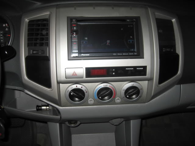

    Performance mods: TRD CAI, AFE throttle body spacer, Doug Thorley headers, TRD exhaust. Cosmetic mods: HID 10k head+3k fog lights, BHLM, T-rex 2 eyelids, billet grill (5 piece), 20% front window tint, 4% back window tint, tinted 3rd brake light, altezza tail lights, LED license plate lights, door skid protectors, slotted drilled rotors,plasti dip rims,painted rotor and drums. Interior mods: TRD seat covers, LED map and dome lights, 2 kicker 10' w/ 500 watt amp, pioneer door speakers,and Pioneer AVIC X930BT.
    sounds like your factory one is finally crapped out..same thing happened to my 00 land cruiser. There is 6 cds stuck in there and it doesnt even recognize cds in there..It time for a nice new deck for you op!
