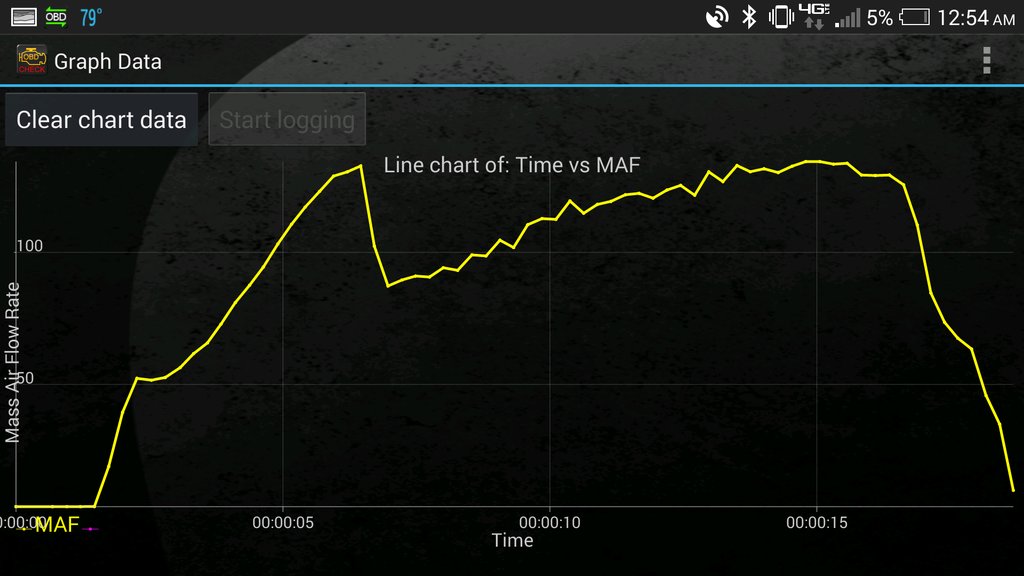

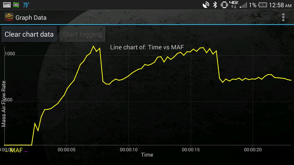

    Not sure if this will really show anything. (And hope I'm not hijacking here but seems you've settled on a new maf) But I've been messing with torque app, tried a couple line charts of maf readings at wot from a stop up until 3rd gear. Here's the two tests I did..
    First is in grams per second. Drop off was after shifting into 3rd and letting off
    Second is cfm per second. A few seconds after 3rd.
    Anything look abnormal?

    I'm not much of a mechanic, but since you don't have hesitation at WOT or near WOT I am not sure the MAF will help you much. My hesitation at WOT got worse over the years and eventually became hesitation at >75% throttle then I started getting CEL for P0171.
    Your grams/second MAF looks pretty good (similar to what I was getting after installing the new MAF). Here are my before and after new MAF screen grabs.
    Before new MAF.
    The MAF went just over 88g/s at approx 4600RPM.
    After the MAF, the hesitation was gone.
    I went a little higher in RPM in this test (since it was running so much better and wasn't hesitating). At about 4900RPM, the MAF showed 120 g/s. Even if you try to eyeball the MAF reading for 4600RPM for apples to apples, the MAF was showing around 110g/s. The old MAF was definitely reporting too low.
    After this, I replaced the K&N "cold air intake" that was put on by the first owner with a used stock intake setup that I bought from someone locally and the truck runs outstanding now.
