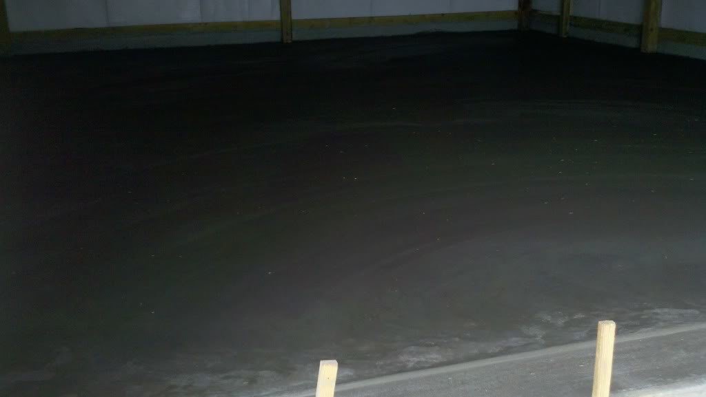

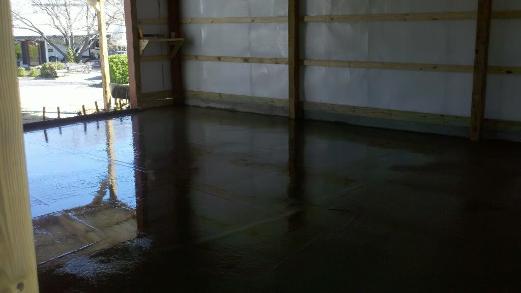

    This.. I LOL'd when I read it.. OP if you get someone to lay your floor, its gonna cost you, but it gets done right. From the sound of it you don't have a whole lot of experience with this and doing a shop floor is a pretty good sized job.. And one you really don't want to screw up... No offense, just some advice.. Concrete work is a little harder than most think..
    Here's mine after getting poured....
