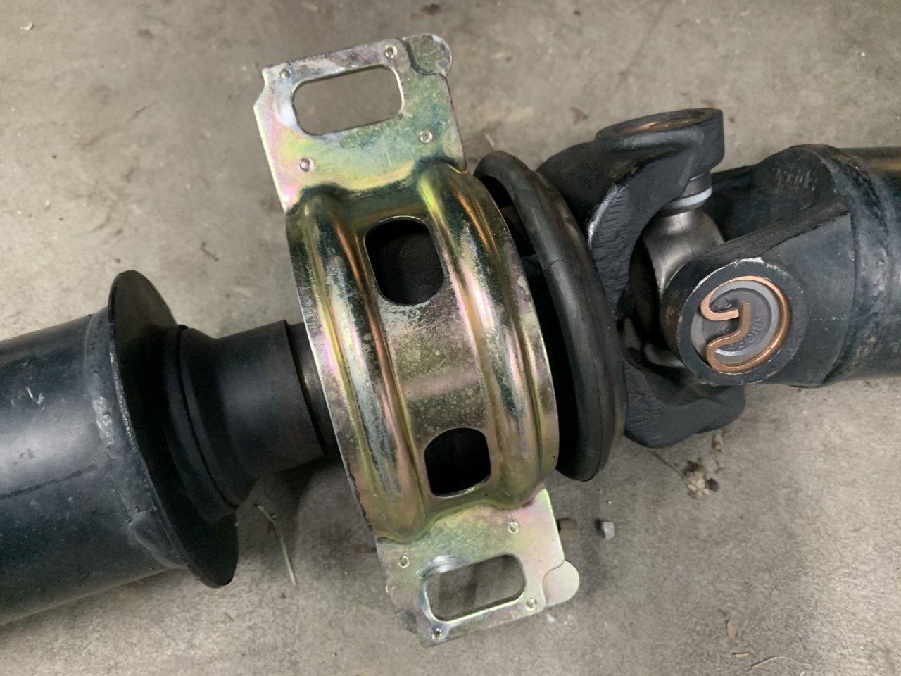

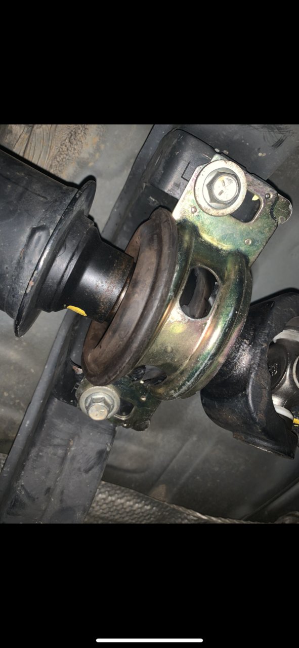

    Yes, it’s a 2WD prerunner. The new bearing is torn to pieces and will not stay seated in the metal bracket. A local driveline shop performed the rebuild, but they’re blaming it on the “lift”.

    The inner part of the bearing is pulled forward, while the outer (steel) housing of the bearing is mounted all the way back. Those slots are there to allow the allow the CB to mounted in a neutral position so its not pulling on itself front to back.
    Seems like a pretty good guess thats the culprit

    Do you think it’s the wrong bearing as it’s not mounted in the correct location? I’m assuming the bearing can not be adjusted as the bearing remains in a fixed position once the driveshaft is mounted to the diff/transmission?

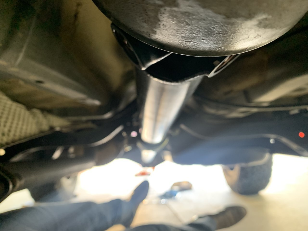

    Can you post a picture showing your driveshaft from the slip yoke at the transmission , all the way back to the rear differential .
    A new carrier bearing to start for sure , but something happened to your driveline in the past couple weeks that caused your transmission to bind up .
    I have seen this happen on high horsepower applications where the slip yoke splines twist . When the splines twist , your driveshaft no longer plunges at the slip yoke and is basicly a solid tube from the rear diff to the transmission . The carrier bearing is the weakest point once the yoke no longer plunges . Another issue can occur when a yoke is over greased and a hydro lock is produced .

    Bro your carrier bearing was installed incorrectly. I get 100k out of OEM spicer carriers with a 3” lift. The bushing material getting sucked is abnormal.

    Thats what I tired to say before... :rolleyes:
    No offense to Gearcruncher, but the shop that did the CB last year installed it wrong. It fought itself for 10k miles and now its finally pulled itself apart.
    It probably not even worth trying to fight the original shop to cover it. Just get a new one in there and keep truckin

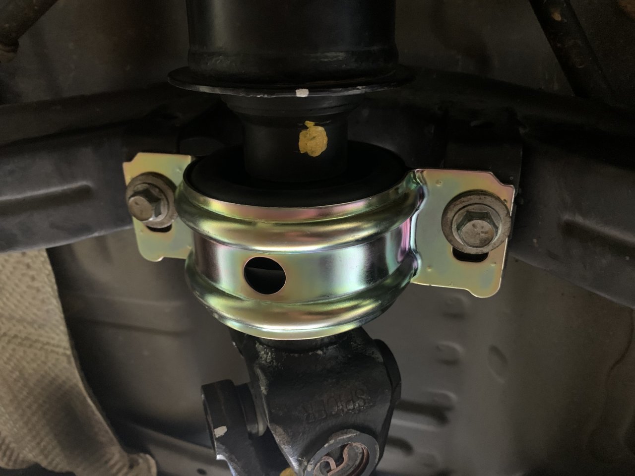

    @gearcruncher Just got it reinstalled. The bolts appear to be in the proper tolerance when compared to the old pic. What do you think?

    gearcruncher Well-Known Member
    Nov 1, 2012
    #90305
    7,176
    Canadain bumper technician
    Great white North 51.0333° N, 93.8333° W
    2010.TRD.SportDCLB4x4Limited leather package
    TRD Sport Rally -5 speed automatic Limited ,Factory heated leather seats ,chrome package,Super white with front windows tinted to 35 % Dick Cepek DC-2 wheels Summer tires - Good year silent armor P265/65R17 Winter tires - Good year P265/65R17 Ultra Ice studded Illuminated 4x4 switch TRD 3rd brake light cover ($20) TRD seat belt shoulder protectors (5). ($50) TRD ...B pillar emblems ($20) TRD rear slider sticker with devil horns ( $6) TRD summer floor matts ($60) TRD steering wheel emblem ($20) TRD floor pedals .($95) TRD shorty antenna ($14) TRD front Windshield emblems ($17) TRD head pillows .($60) TRD head rest protectors TRD door scuff protection $20 TRD floor matt emblems ($40) TRD tow plug emblem . ($40) TRD cigarette lighter with LED.($35) TRD tissue dispenser ($12) TRD front bezel emblems ($9) TRD door emblems ($6) TRD lanyards($9) TRD lisence plates with TRD bolts($50) TRD fender emblems TRD center caps Part Number:PT904-35070-CC ($80) TRD cd

    I replaced it awhile back! That’s just the residue from when I pulled the driveshaft out haha
