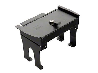

    Boy…. My memory is good for about 2 minutes, so I don’t have the details. But the tuffy box has 2 sides that divide into 4 legs. Like this one, but the legs are on the front and back, not the sides. I couldn’t find a picture of the Tacoma one.
    If you look at the bottom of those legs, you see the holes for mounting. Now, like I said, I don’t remember crap for details, so I am just making up numbers here. But let’s say those legs are 6” long, with the bottom foot being 1”, and the mounting hole centered. If I wanted to make it 2” shorter, I would measure the legs out to be 4” plus the 1” that will get bent. I’d mark it at the bend point and the 1” past that. Then bend the legs in that same 90° (I used a pair of pliers for duct work. It wasn’t that hard to bend) then drill the holes in the same location (centered in our example). The one thing I don’t think about at first is the usb. So I had to go back and cut the space between the legs for the front side (so 2” in this case). I hope this makes sense? I should have taken pictures I suppose, but I am horrible about doing that.
