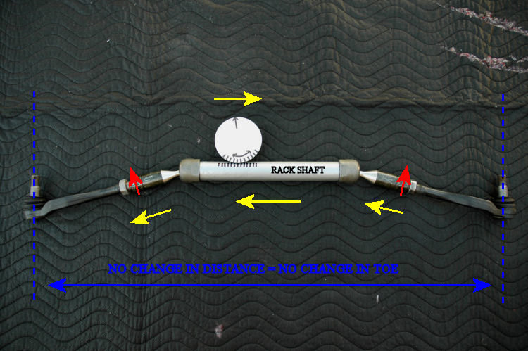

    At this point you can fine tune the steering wheel position (or leave it to the alignment shop) by turning the ITRs in the same direction the exact same amount. "Same direction" in this case means, if one side screws in the other side should screw out" see pic below. Don't get carried away here, try a half turn first to get a feel for what it does. These guys are very sensitive. I mark one of the flats on the ITRs and use the flats as index marks. Turning them just one "flat" (1/6 turn) will move the steering wheel a noticeable amount.
    For quick ref this is how turning the ITRs moves the steering wheel with out changing the toe setting.

    Well sure it would be safer to do the whole process it but you got to figure it has to be close (with in 1 or 2 splines) because you secured the wheel. Moving it a spline or 2 is quick and will likely make your day.
    If you don't do it, a shop will likely just center the wheel using ITR adjustments. I suppose you could tell the shop what you did (the whole story) and what you want done in addition to the standard alignment. It may cost a few more $ but not much.
