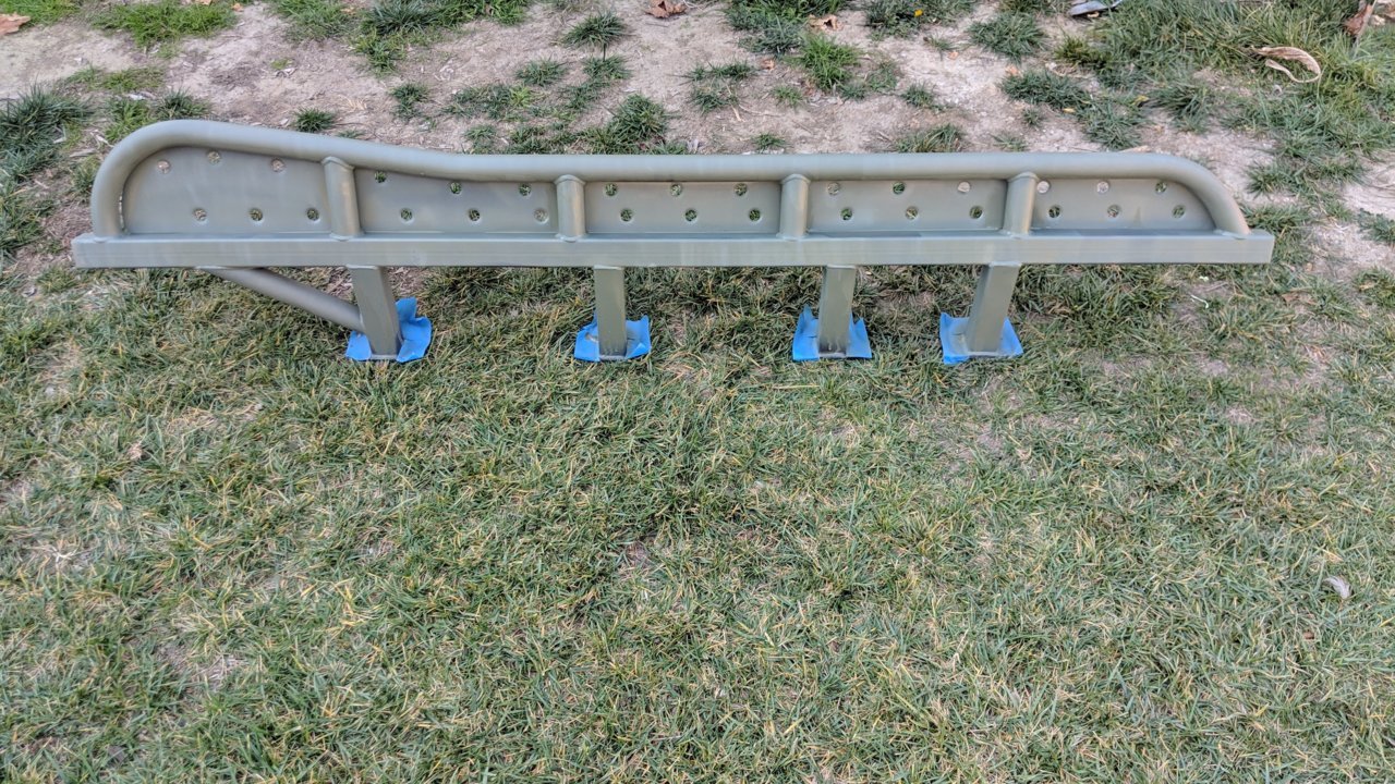

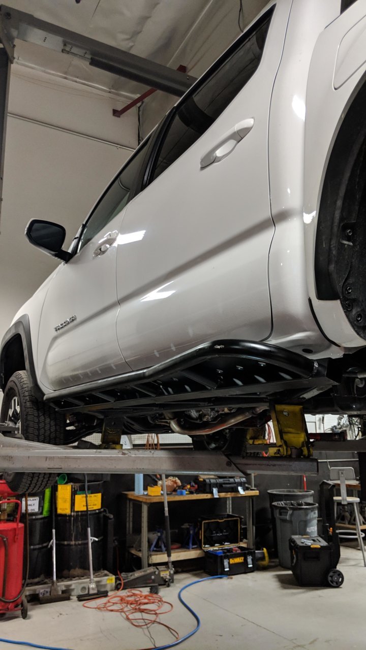

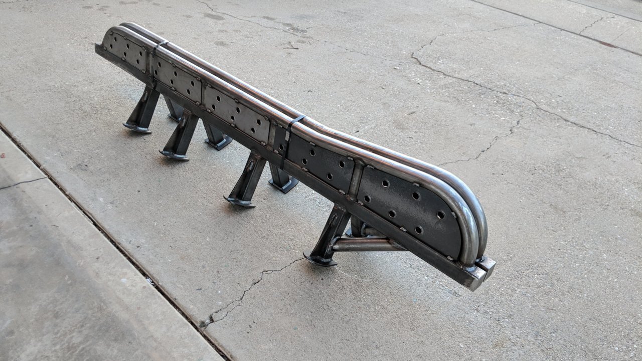

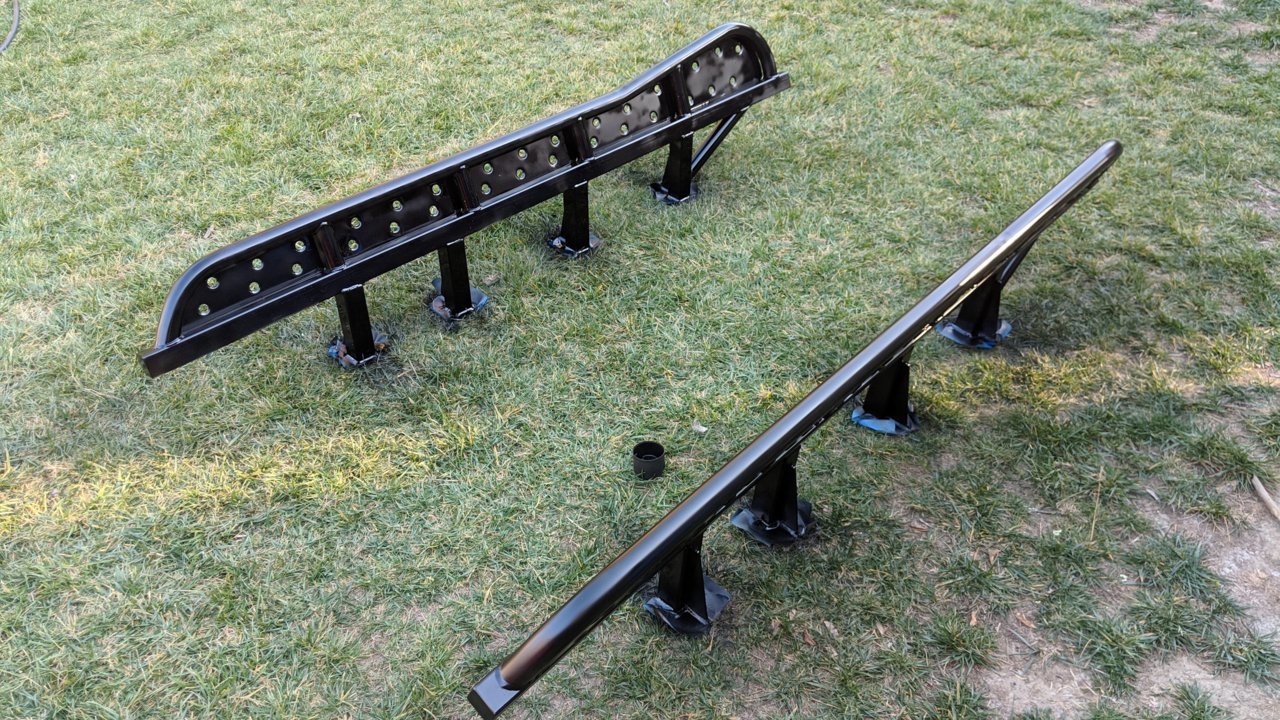

    Rattle can is the most economical. That's the route I took with my sliders.
    If your sliders do not have fill plates, figure on about 1 can of etching primer and 1 can of paint per slider.
    I used Krylon self etching primer and black with Satin finish. Satin finish looks very glossy at first but it'll dull down.
    My Mobtown sliders have fill plates and took 1 can each. I really stretched the cans. To be really comfortable I would have used 1.5 cans per slider but I was lazy and didnt want to get more paint.
    IMG_20190102_164125.jpg IMG_20190104_130112.jpg IMG_20190104_150559.jpg IMG_20190105_154359.jpg
