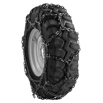

    WARNING. There is a "feature" to our 2nd gen Tacos that you should be aware of. The clearance between the back of the tire and the control arm is less then an inch. Any standard chains will hit and damage that arm and cause some expensive and vehicle debilitating damage.
    I run chains.. they rock over cables. Much better performance. They turn my truck into a snowmobile!
    You have to get the low clearance type. Just ask for them. Also, you'll have to check tightness of your chains more religiously then others.. loose chains, even the low clearance ones will still potentially case serious damage.
    Also I recommend Diamond brand alloy chains.. they don't rust and are stringer and lighter then the basic steel ones truckers use. Of course they cost more :)
    Chains are unstoppable. Cables are smoother riding and better for on-road applications, like icy roads. Also cables are easier to put on and take off your tires.
    However, you aren't likely going to need them anyway so ease of putting them on/off is irrelevant. I am comforted on each and every winter excursion knowing they are behind my seat ready to save my butt.

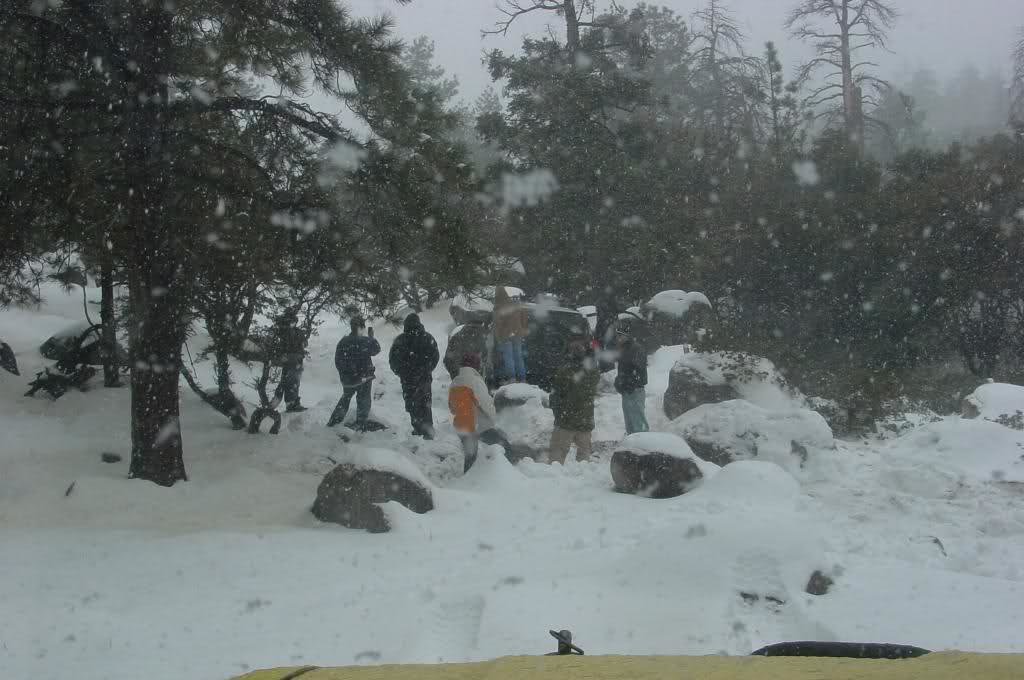

    we were up there on saturday..my buddy in his FJ with front/rear lockers on 35's made it maybe 15 feet up from the trail head..approx 5 feet further from another group who was up there before us..judging by the tracks they left behind. just way too slippery haha...so, we're gonna see if chains will help :p
    John Bull Trail at the "Gate Keeper"
    breaking trail on 3n12..
    here's some more pics of our snow run...http://www.tacomaworld.com/forum/southern-california/65233-big-bear-snow-run-12-12-09-a.html

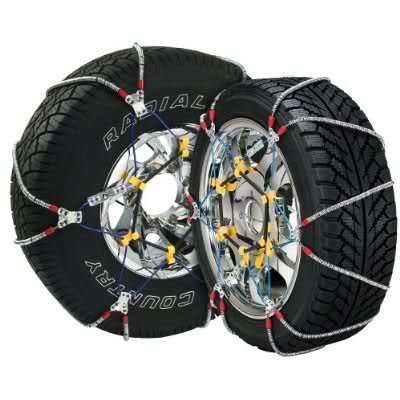

    We're thinkin the same... I love cables and love their clearance. I've ordered 4 of these:
    May need to run some spacers! ;)
    Nice design - we'll see how the clearance is. May have to go to the cables!
