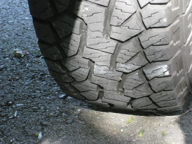

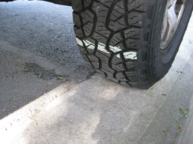

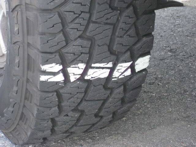

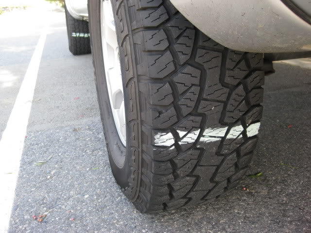

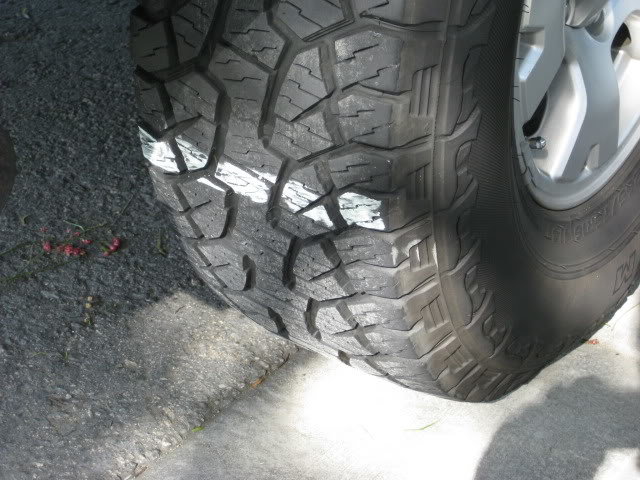

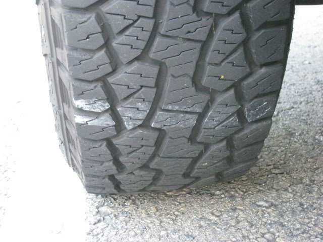

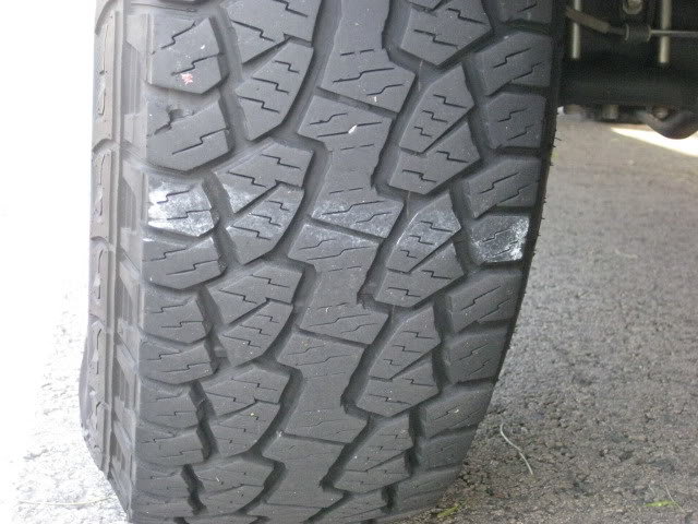

    Step 1, check that your tires are all at the pressure you assunme to be correct.
    For my Dynapros, they all are at 37 psi. I have (by feel) determined 36-40 psi to be a good range for these 44 psi max. tires on my lightly loaded to unloaded 4 door Tacoma.
    Step 2, with big sidewalk chalk, make a one inch bar across the tread.
    Step 3, drive for approx. 100 feet and then see how the chalk wears off.
    If it wears mostly in the center, too much air. If more wears on the outsides, then too little air. If wears is even across the tire, you are gold!
    Right Rear Before and After:
    Right Front Before and After:
    Left Front Before and After:
    Left Rear Before and After:
    There you go.... looks pretty even, yes? Maybe just a hair high? What do you think?
    FYI, these tires have 16,000 miles on them. Hankook Dynapro ATm 265/75-16.
    OH, and after doing the test, I have lowered the psi to 35 on all 4... soon I will re-test and see if we have improved wear even-ness...

    A hair eye high. I'd leave them the way you've got them though.

    Thank you, however, as I said these photo were taken last April and because it showed a bit over-inflated at 37 psi, I dropped to 35 psi. It has been 4,000 miles... everything is doing great. I may do a new Chalk Test at 5,000 miles to see if the wear is a bit more even.

    I'd say you're good - the edges of front tires wear faster than the centers anyway due to the act of turning, so it might be perfect to offset that a bit by a pattern that your tires exhibit.
    I would venture to say that the chalk test is a good test for overpressure, but tires inflated below pressure would still wear the chalk evenly, yes? The only way that you could tell would be if the tires are so low they exhibit "cupping", which I believe would be a drastic level of underinflation and not be evident at, say, 30 psi.

    If the tire is underinflated, you'll notice the edges wearing faster than the center.
    Cupping can be caused by a lot of different things and it's not always clear what causes cupping. For instance an unbalanced tire or blown shock could cause cupping.

    Eventually, yes - but my hypothesis is that this would not show on the chalk test since a full contact patch would be maintained, even with underinflated tires.

    You're probably right in most cases unless you were severly underinflated (in which case just looking at the tires should tell you something is wrong).
    What I meant though was by the time you see the tires cupping, the outter edges will be worn if they're underinflated.
    I guess you're better off starting a little higher and backing pressure off until you get an even wear patch.
