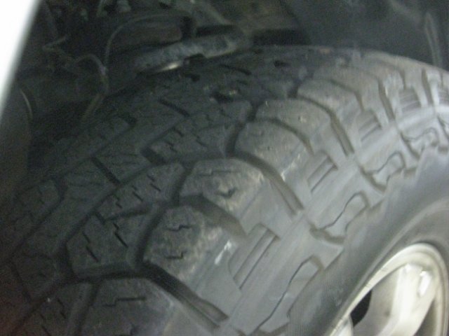

    So, 15,500 miles... I bet they still look new (mine did)?
    I took photos of my tires just now, I will post in a few seconds...

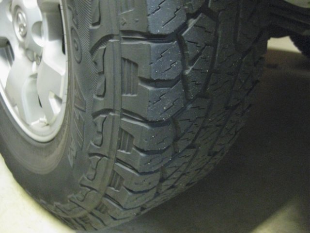

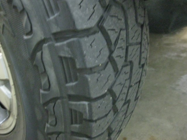

    Ran at 38 psi first year (when brand new tried 32 psi for a couple days, but was way squishy), then 35 psi after chalk test...
    REAR:
    FRONT (slightly more worn than rear, maybe will rotate one more time before replacing?):
    Passenger side tires above... driver side looks the same.

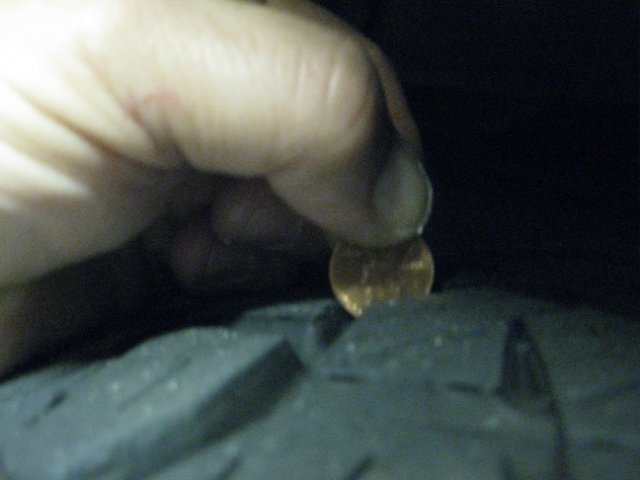

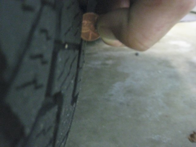

    So, what do you think, am I over-reacting to the amount of tread left, and I can go another 5,000 miles? I really can't afford new tires yet...

    Those look fine to me, they still have the sipes in the tread blocks. Maybe think about new ones before next winter but you've got miles to go on what you've got now.

    1/4" is still a decent amount of tread left! But, understanding that you're concerned about off road traction, you could probably sell those tires off to someone looking for a cheap set. Someone who doesn't off road could run them easily for another year.
