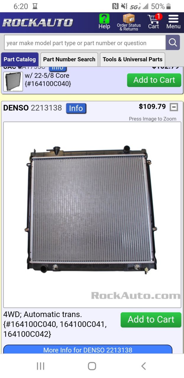

    My bad, I missed that bit of information. This is what I used on my 4runner before I massacred it in the name of my tacoma. Held up to basic forest roads and thousands of miles in the almost year and a half I had it installed Screenshot_20200705-182023_Chrome.jpg

    I just put vacuum line caps on the cooler lines cause I had a manual trans

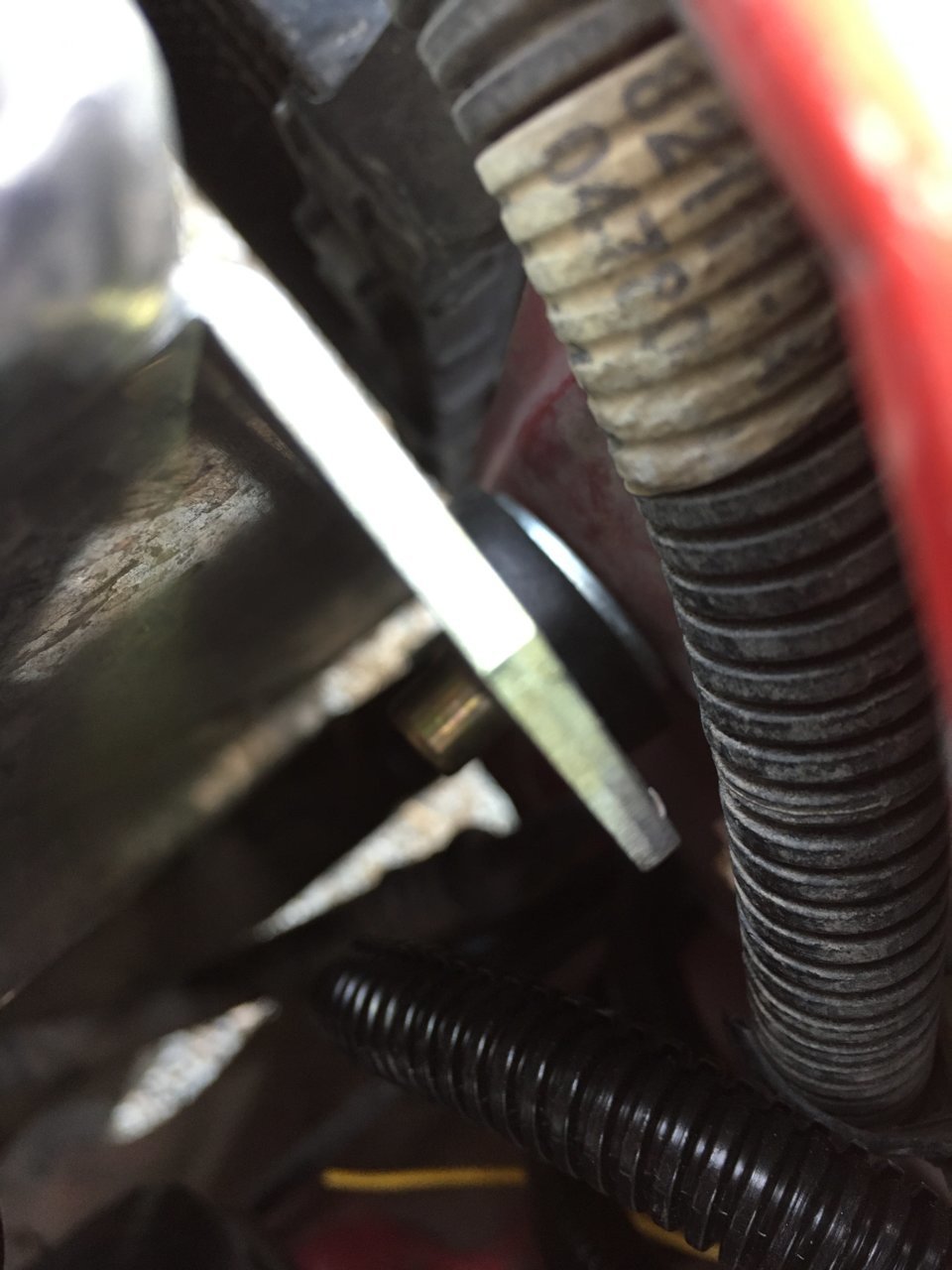

    I have a Champion CC1778, for the 2wd 4 cyl. So far so good, I have used the rubber bushings to fir it out about 1/4” from the core support. About 10k miles with out issue. However I haven’t done a lot of wheeling with it, and in consultation with a couple of wrenching buddies and mechanics, they suspect the quality (Lightweight) of the material and the rigidity of the core as the likely cause of leaks.

    What rubber bushings?
