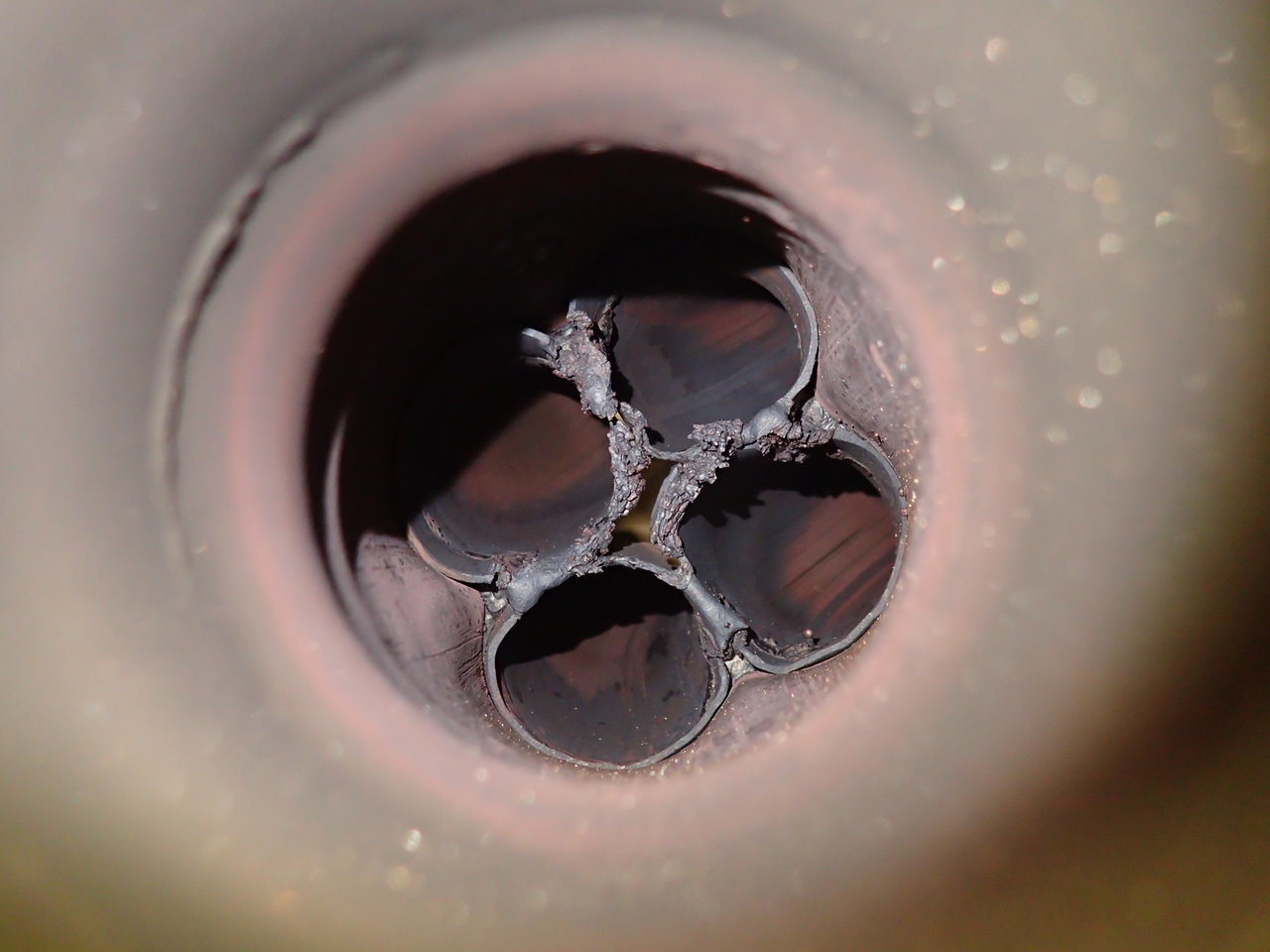

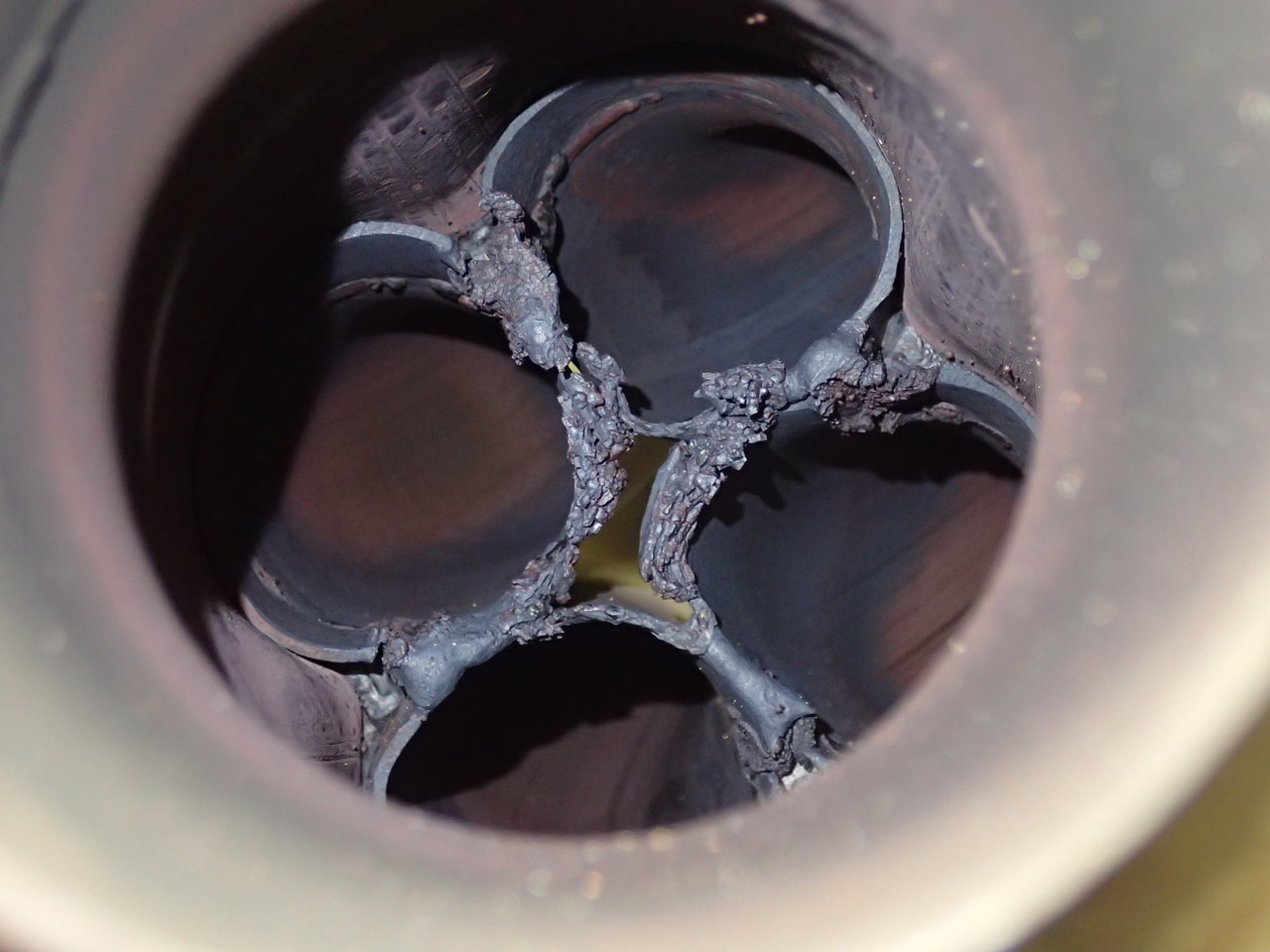

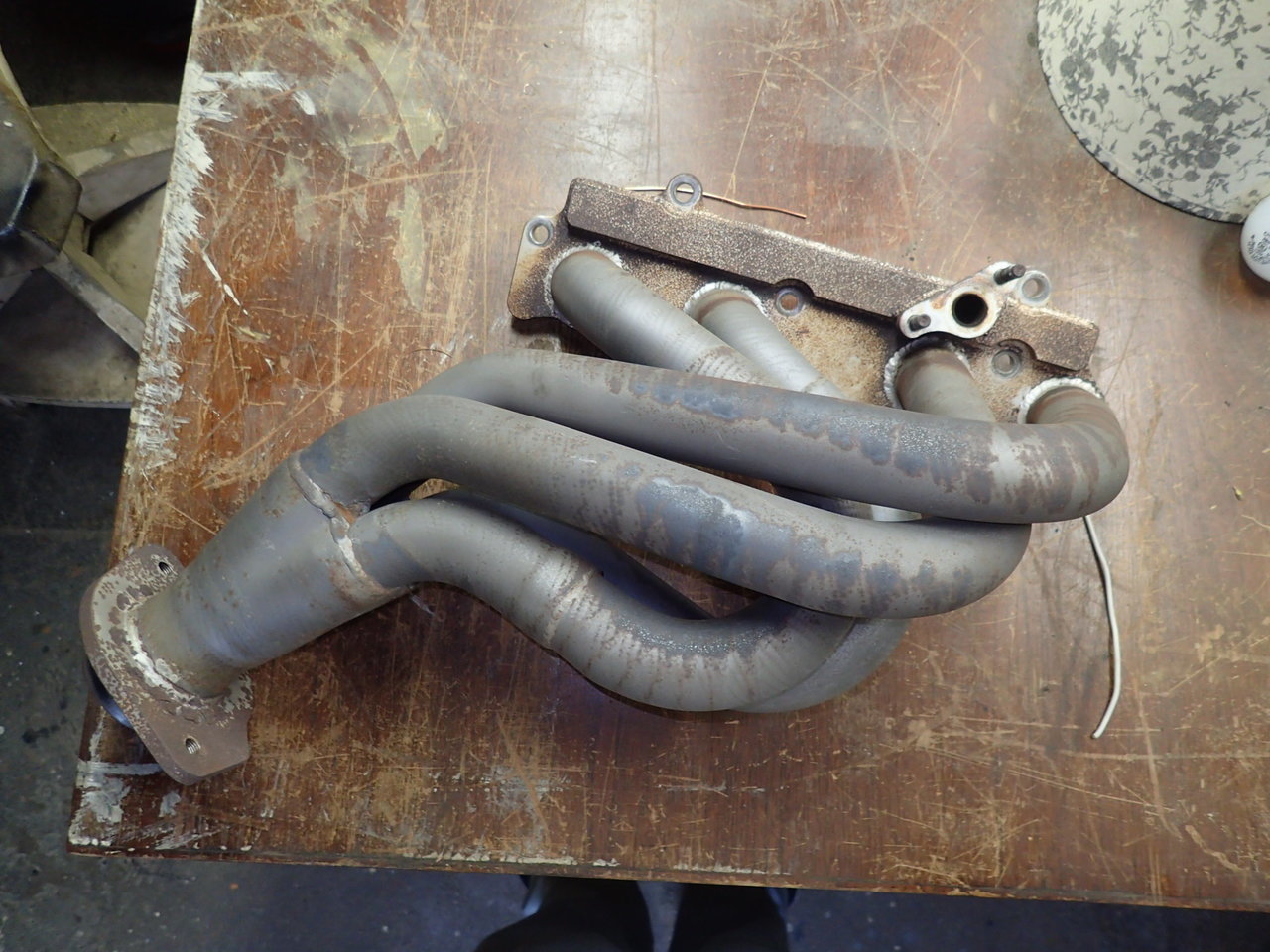

    Well, I can report some good news and bad news. Good news is I found the problem. Bad news is that my LC header is effed. Some pics to explain...
    Here's the header after 2 years. Now I did have it wrapped in fiberglass header wrap because I thought it would lessen under hood temps and I liked the look. I didn't think I'd have to worry about corrosion because the tubes are stainless. They appear to have corroded slightly anyway. Also I'd like to say that I really wish LCE would use stainless for all the parts, flanges included.

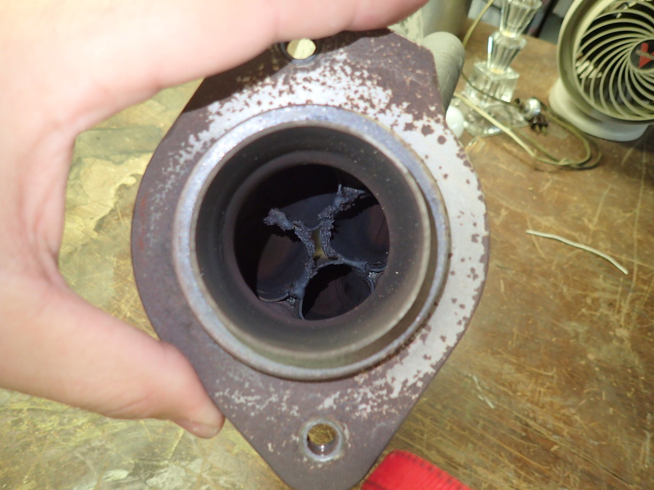

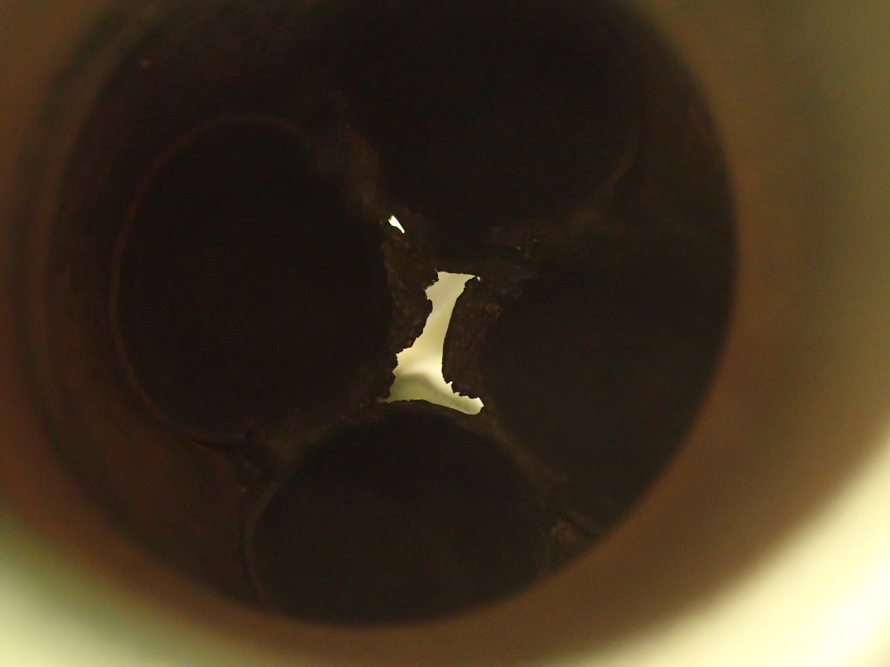

    Here's where my leak was. The area where the four pipes converge was completely rotted away. Makes me wonder, is this really stainless?
    The darkness allows the light to come through.
    Some more close ups...
    I'm gonna try and call or email LC and see if there's anything they can do about it.
    I think I can fix it by cutting off the collector and trying to patch up the hole and welding the collector back on. My only concern is getting a decent weld to the crusty nastiness in there.

    Please keep us posted, was looking into purchasing one of these. Definitely looks like a quality issue, I don't think rust or corrosion is to blame entirely, those welds do not look very good on the inside of the collector. It's possible whoever made it made a second pass and welded partially on top of some slag which would explain why it blew out.

    That's very possible. That said, I wouldn't have any qualms about buying the part. In my case the header wrap probably screwed me over. If I could do it over I would not use the wrap but I would probably send it out for a better ceramic coating, both for corrosion protection and heat mitigation. Been looking at these guys but haven't gotten an estimate yet. https://www.jet-hot.com/ I think with some of their coatings they can even do the inside of the pipes, and it's supposed to last a very long time. LC's "ceramic coating" has pretty much all worn away on my header.
    My best guess as to why it corroded is that maybe it's possible that because of the insulation of the wrapping on the collector, that portion of pipe got to the point of being red hot causing the stainless to oxidize. If you've ever TIG welded stainless it's a very common problem that the backside of your joint, if it becomes sufficiently hot, can become gray and crusty if not properly shielded by gas.

    Header wrap is a often blamed cause of pipe damage. Iirc more than 1 company puts a 'void if wrapped' note in their warranty.
