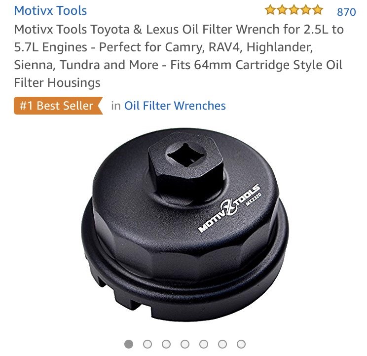

    For $20 that seems a good insurance policy. Thanks!

    While at the dealership, show them your knuckles. A breaker bar is probably what they used to put the filter housing on.

    Toyota did a free oil change at 20K for me. I know how the OP feels because they put it it on too tight. I had to use a box wrench on the filter tool to get it off. Sometimes free is not a very good deal.
