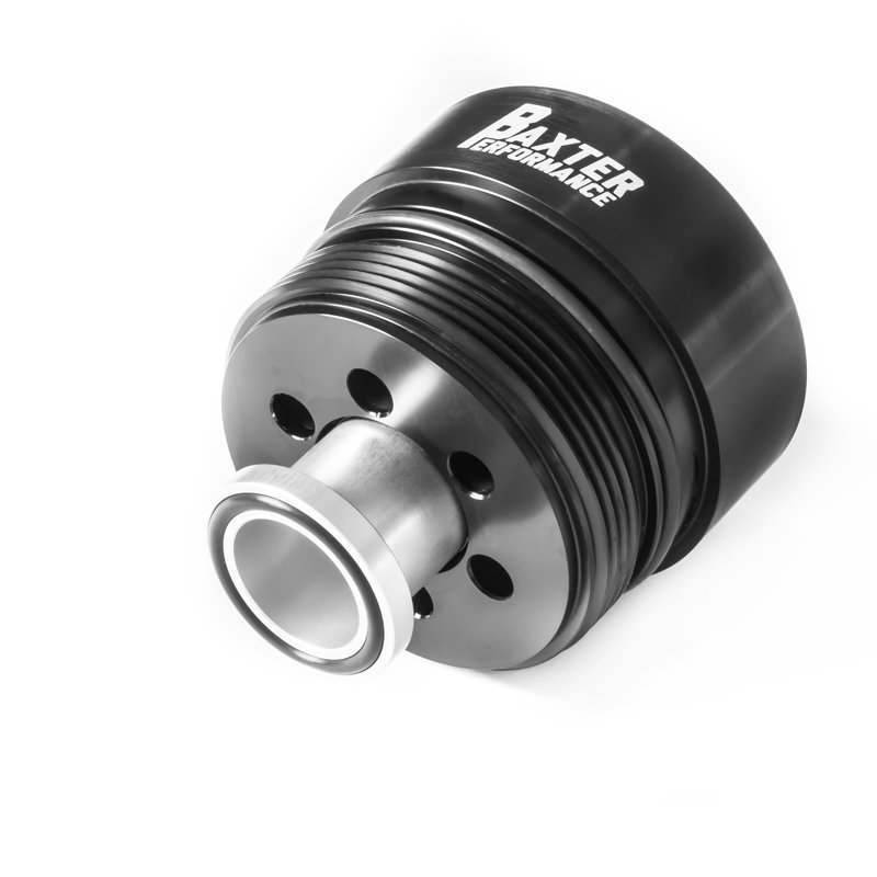

    Many you have bought the metal ones say they have leaked. Just something to keep in mind.

    $199 for the spin on adapter... I choked. I'll buy 10 plastic housings and throw them away every oil change before I'll ever pay that much for an adapter. It's probably a very nice product but costs exponentially too much.
    loastad, beergeek, Ensemble88 and 2 others like this.

    Yes a bit pricy, but a very high quality part. You save a few bucks on the filter cost and get the benefit of an anti-drain feature of the spin on filter. I went for it to eliminate the hassle of the canister removal each time and all the associated issues mentioned in this thread.

    Well I bought a metal one and it leaked, just a little, but enough to notice. So I went back to the stock plastic, I’m doing all my own changes so I’ll tighten to correct spec.

    I use the metal one, not a problem yet. I can see someone not placing the o-ring in the correct location and having problems. I put a fumoto valve on it too :D

    Holy shite. $200? That's a lot of oil changes before it pays for itself, convenience included...

    What keeps it from spinning off while removing the spin on filter?

    I asked Baxter that same question. The adapter has 2 o-rings and it get torqued to 25 ft lbs. A spin-on filter gets hand tightened only. I never had a problem with mine but I am careful with the tightening of the filter and keep one hand on the adapter when I remove the spin-on.

    There is no benefit to the anti drain feature of the spin on oil filter when the open end of the filter is at the top.
    The anti drainback feature is a benefit if the filter is mounted sideways or open end down.
    As positioned on the Tacoma, the stock cartridge filter doesn’t drain out until you remove the drain plug and then insert the drain tube at the bottom of the cartridge.
    So, when starting the vehicle, if you want to pre-fill an oil filter when doing an oil change, with either spin-on or cartridge filter, it can always have oil contained within.

    Opinions are like a certain opening in one's butt. Everyone has one. For me the adapter has made oil changes easier and after 200K will pay for itself. So keep your cartridge if you wish, I was just giving others on this forum an optional way.

    How low do this cause the spin on filter to hang? Do you have to remove the skid plate? I would love to run one of these with a reusable oil filter.
