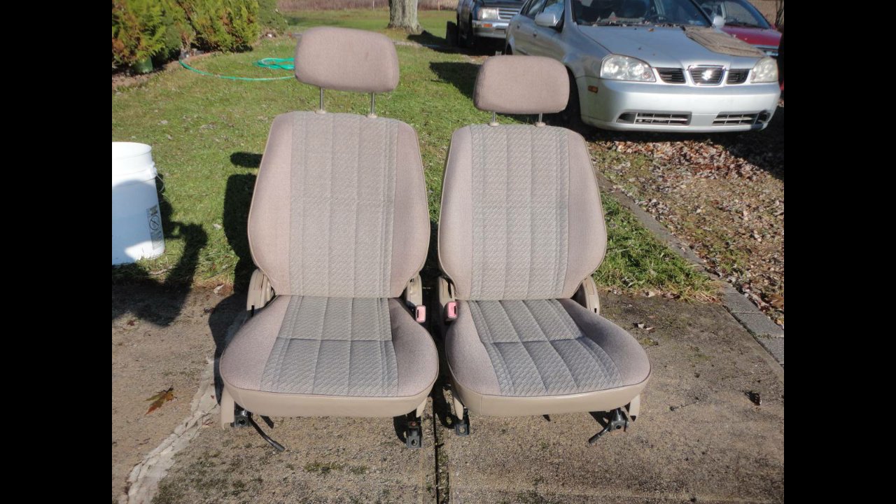

    It took 2 years of monitoring Craigslist, but I found these.
    Seats from other same gen Tacoma's will bolt in (obviously), and everything will be exactly right (height, fold forward, seat belt, etc.. )

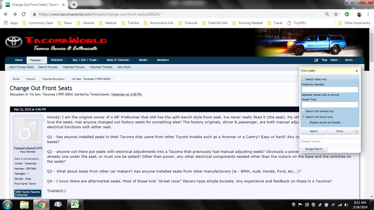

    Since it appears you just joined, I'll let you know the search feature in the top right corner of your page is your best friend. Use the "Search This Forum" selection.
    FYI, it looks for EXACTLY what you type, so you may want to be vague in descr, such as what I entered,...just "front seats" or "bucket seats", etc.
    You'll find many discussions of seat swaps.

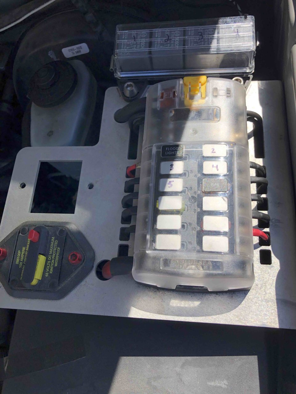

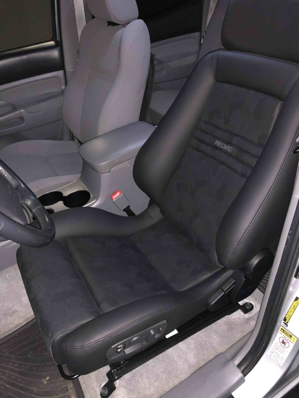

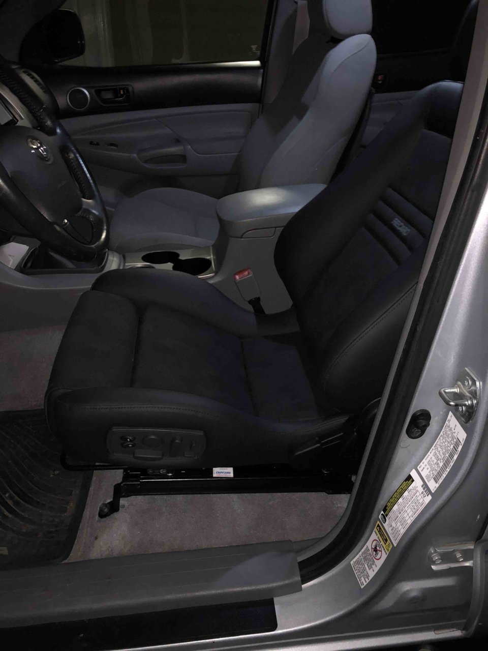

    I installed a Recaro Ergomed with a planted seat bracket and Recaro sliders on a 2007 Tacoma. The Tacoma did not have any power functions at the time. I pulled wire from a wiring panel installed under the hood. The panel is wired to the battery via a blue sea breaker. I used a relay installed under the seat and triggered by the accessory 12v power to shut off the seats when the vehicle is not in use. The wires run from the fuse panel through the firewall on the driver's side and sit along the main wiring harness under the plastic kick plate. The seat is awesome but I think I will raise the seat using a spacer. Hindsight for a lifted truck the side bolsters of the Ergomed are a little aggressive to climb over in a lift truck. I would use a flat bottom pad next time. The only problem I have is tripping the fuse when the heat and air are on and doing a seat adjustment. I could up the fuse but it came with a 10amp and I have just kept a set of 10amp fuses in the truck.

    I forgot to mention. My truck had the side impact airbags. Without the airbag I had to trick the system into believing it was still functioning to get the warning light to shut off. I used a 3ohm resistor to provide the resistance to kill the light by replacing the connection with the resistor. I also put th roll over sensor ziptied to the seat bracket so it will not move. The drivers side does not have the pressure sensor like the passenger seat. There was a kit to trick the computer for the passenger side you may need if you go that route. Good luck.

    Nice second gen. That seat looks awesome. I bet it was a pretty penny that bought it home.

    My old seat was killin' my back and was torn up from use. I looked for a long time for a set of seats. This seat was above my price point but the guy was really cool and met me in the the middle taking the edge off of the purchase. They were still expensive though. I do not think I will be able to buy a matching passenger seat. I had already run a bunch of wiring inside the truck to make buttons clean so soldering in an extra wire for aux power wasn't a big deal. Thanks.

    @chrslefty. The seat is nice and comfortable. I do stay much more stabile in the vehicle when it is bouncing around. I can not tell the difference between the vent seat and not running the vent. The heat in the Recaro seems to strobe but they get HOT, which is nice when the back is giving me hell. I like the oldschool Tri Color E-Tool case and frag case on your seat. That is a really nice truck.
