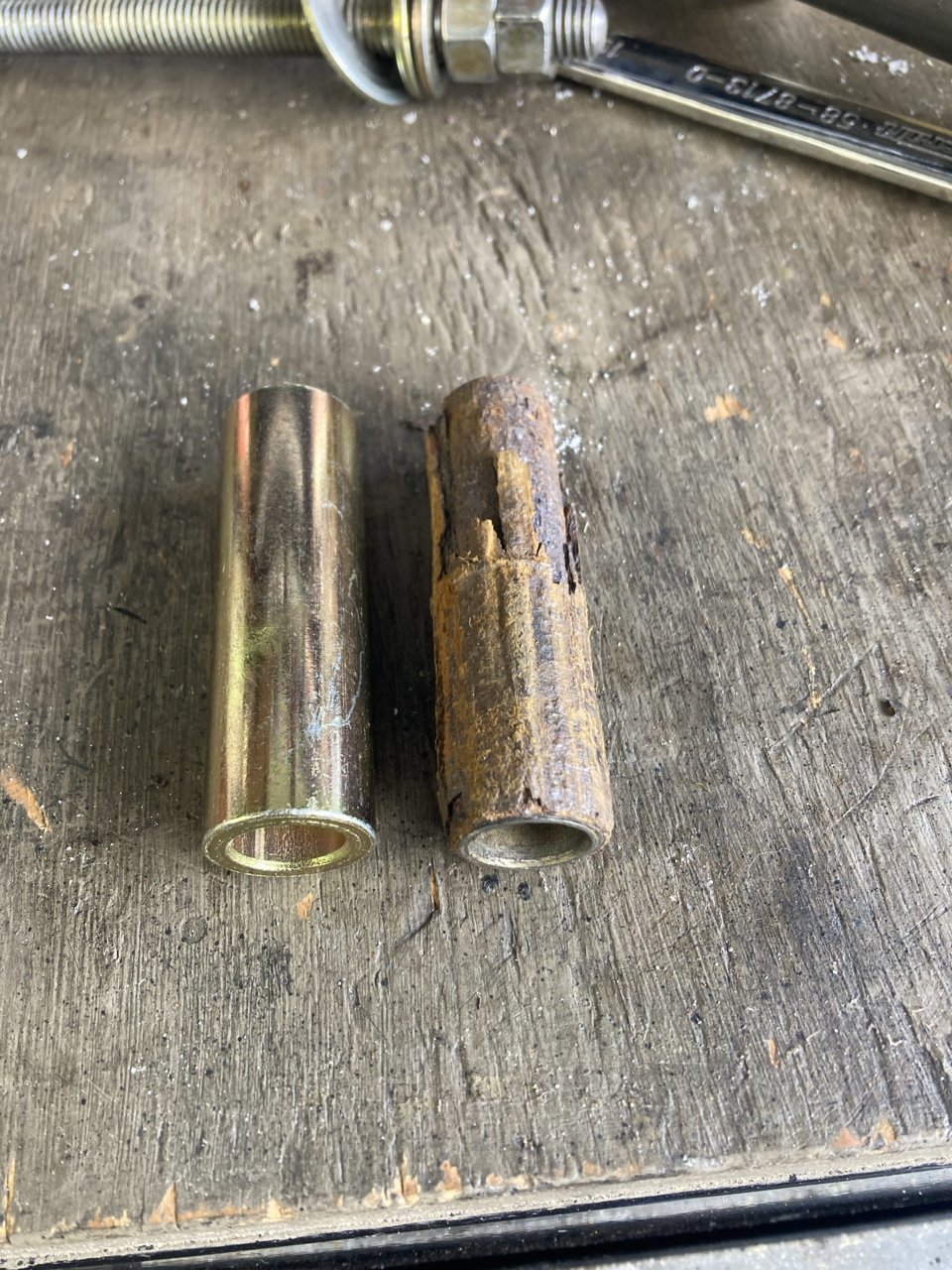

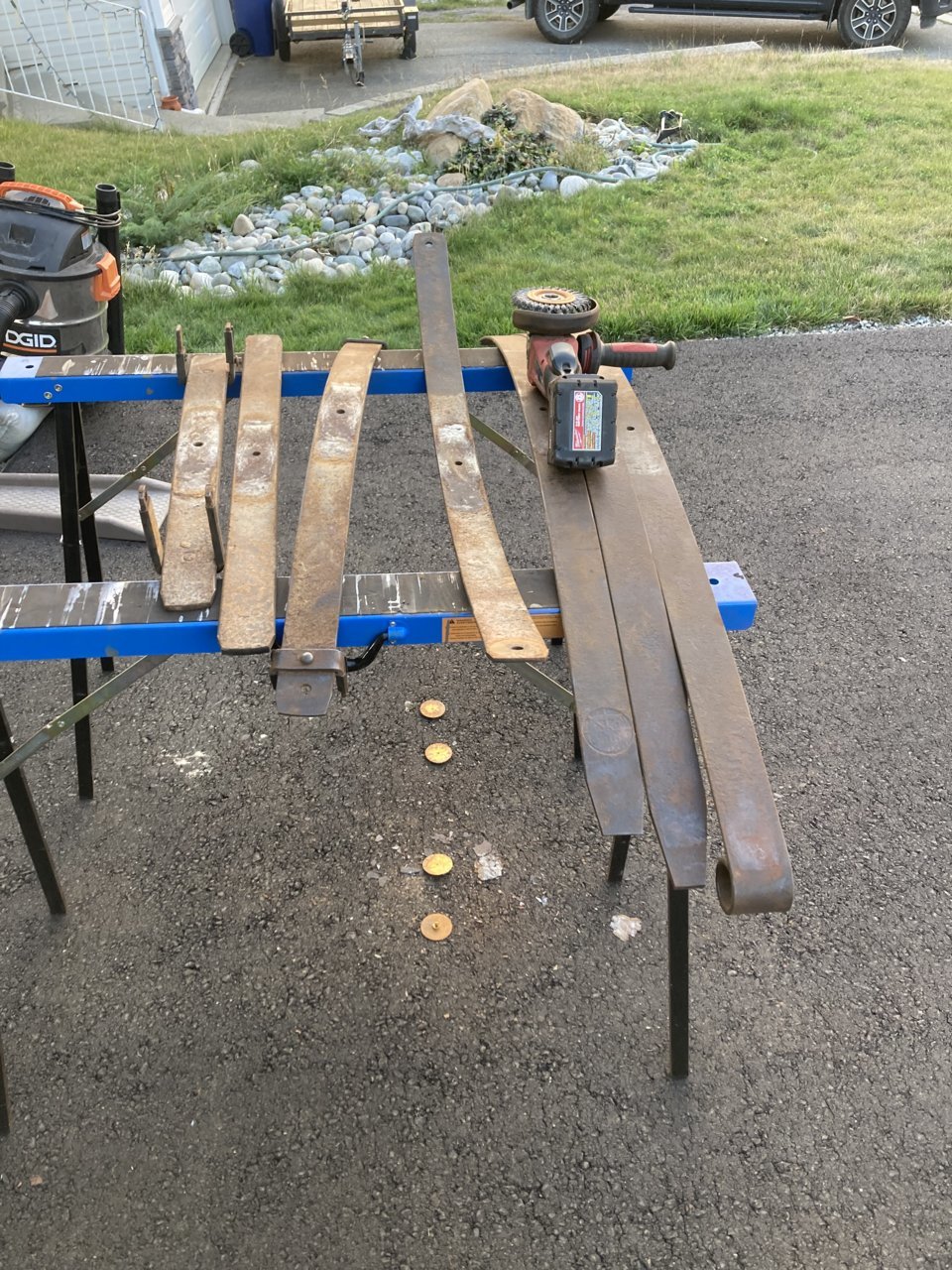

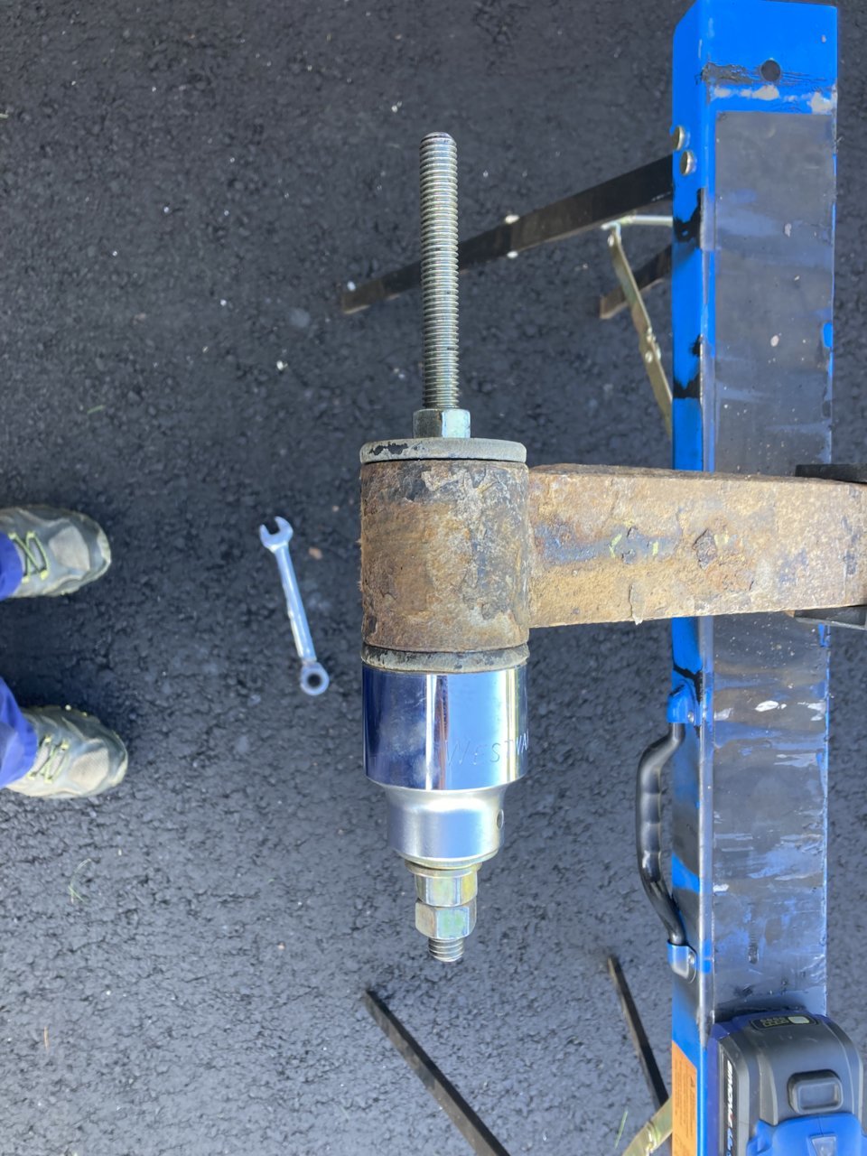

    Impressive to see the damage of 9 Canadian winters. Just rebuilt the Dakar leafs, removed the 3rd leaf and coated with POR-15. The front factory style bushings were seized in place and wouldn’t press out, they were still in good shape so left them in place. The sleeves of the rear poly bushings were disintegrating. For anyone doing this job, just order factory rear shackles from Toyota instead of cutting out the rubber bushings. Makes for a quick install of new poly bushings.
