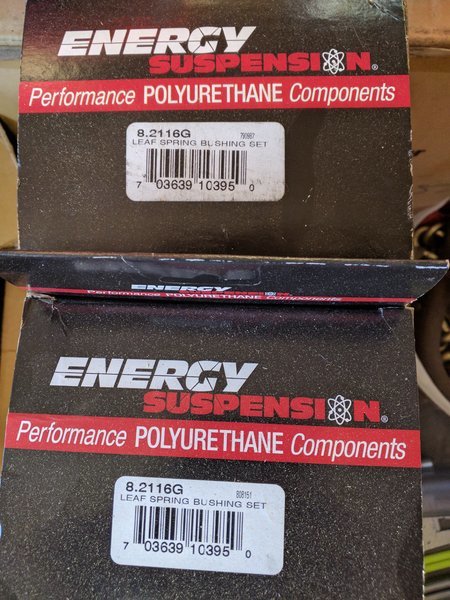

  9. Mar 19, 2017 at 10:43 AM
    #49
    Sandman614
    Oct 26, 2010
    #45273
    36,067
    Tim
    Garner, NC/Boone, NC
    '06 SR5 Off Road
    I can confirm that these bushings for the Dakars. Also added these liners to my pack held in place with 3M clear(acrylic) tape. I used 8in pieces on between the top 3 leafs, the ones without the hockey pucks. We'll see how it holds up after a weekend of offroading.
