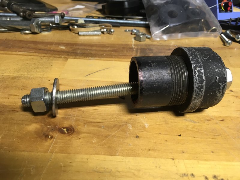

    Is that a 3/4 piece of pipe and cap you used as a puller I assume I'm going to run to the store tonight and make a puller in case I have troubles pressing the stock bushings out

    The pipe is 1.5" steel schedule 40. Matches the spring eye nicely. End cap isn't really necessary; you could use a thick piece of flat steel instead.

    Well everything went we well jacked the truck removed the tires and put it on jack stands, put a jack under the rear end and slowly let down on the springs, we had to unbolt the rear shock to give us clearance. Once it was low enough the best method was using a big socket and pounding the bushing out. After removing the bushings I lubed the inner bore and outer face and reinstalled the new bushings after that we were pretty home free, just reinstalled everything and torque once we had the tires on the ground. Went for a drive and no more squeaks so happy !! Thank you all for the help!!

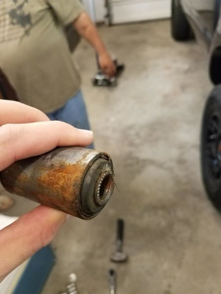

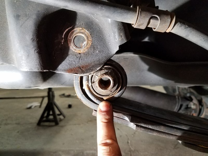

    Just did this, should have done it when I first installed these. Got rid of the rear clunk that the original bushings were creating with the leaf pack. It also rides a lot smoother in the rear, pretty much how it should.
