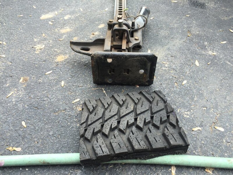

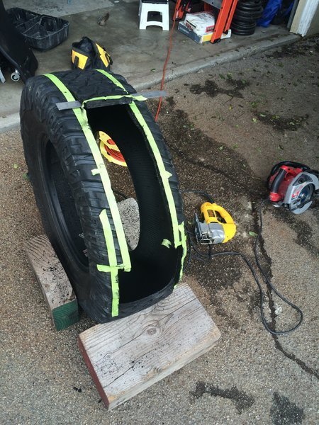

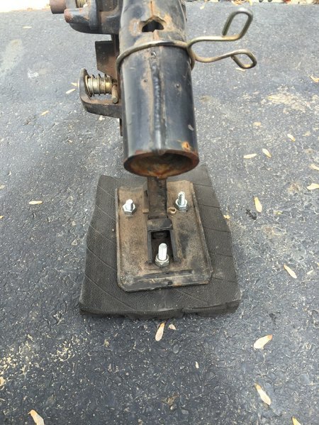

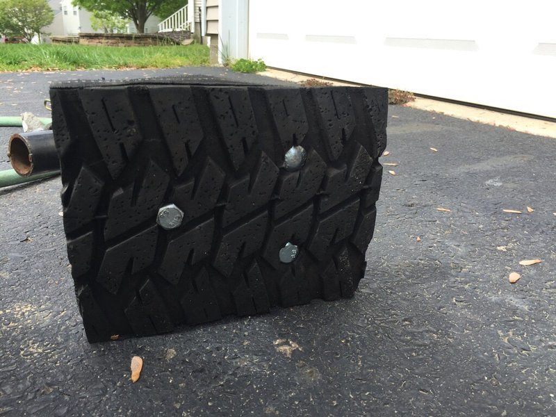

    @GHOST SHIP
    What's that little footy pad on your high lift?
  19. Nov 29, 2017 at 8:58 PM
    #119
    GHOST SHIP
    GHOST SHIP [OP] hates you.
    Mar 9, 2015
    #150537
    22,295
    GHOST
    Good eye. It's a piece of my old tire. I give credit of the idea to @geekhouse23 , but he said that he got it from someone else. I made a few for various members but it makes your Hi-Lift much more stable on concrete/asphalt without the fear of it slipping out from under the truck (causing the infamous hi-lift door ding). Here's a pic of my tire and some clues to how I cut it.
    And some from @geekhouse23 that gave me the idea:
    I cut mine a little closer than that and subsequent efforts are flush with the steel pad now that I've gotten better at cutting it neater.
