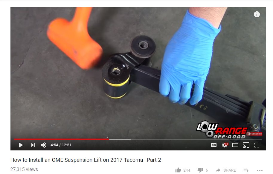

    Ah yeah, you can use the extra bushing for the shackle. It's a lot of work though. The bushing in the stock shackle is captured by the steel sleeve. The easiest way to get it out that I've seen so far is to burn out the rubber then use a combination of a cut-off wheel and sawzall to cut and distort the outer metal sleeve enough to where you can get it out. Not impossible, but you might say a curse word or two in the process.

    Ehhh screw that hahaha I figured if it was easier I would just do it. Wasn't sure if the other side was different where you can just pound it out one way. Ha I'm on the other side of the world from my Tacoma so makes it kind of hard to double check these things. Trying to having everything ready for when I get back next month. Someone on the Facebook Tacoma group talked about some Dakar's being older style and certain bushings not fitting. I didn't believe it til I saw the videos and now I'm paranoid about ordering those :rofl:

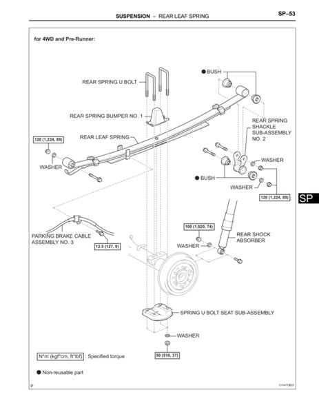

    Should be 89 ft/lbs, not 120.

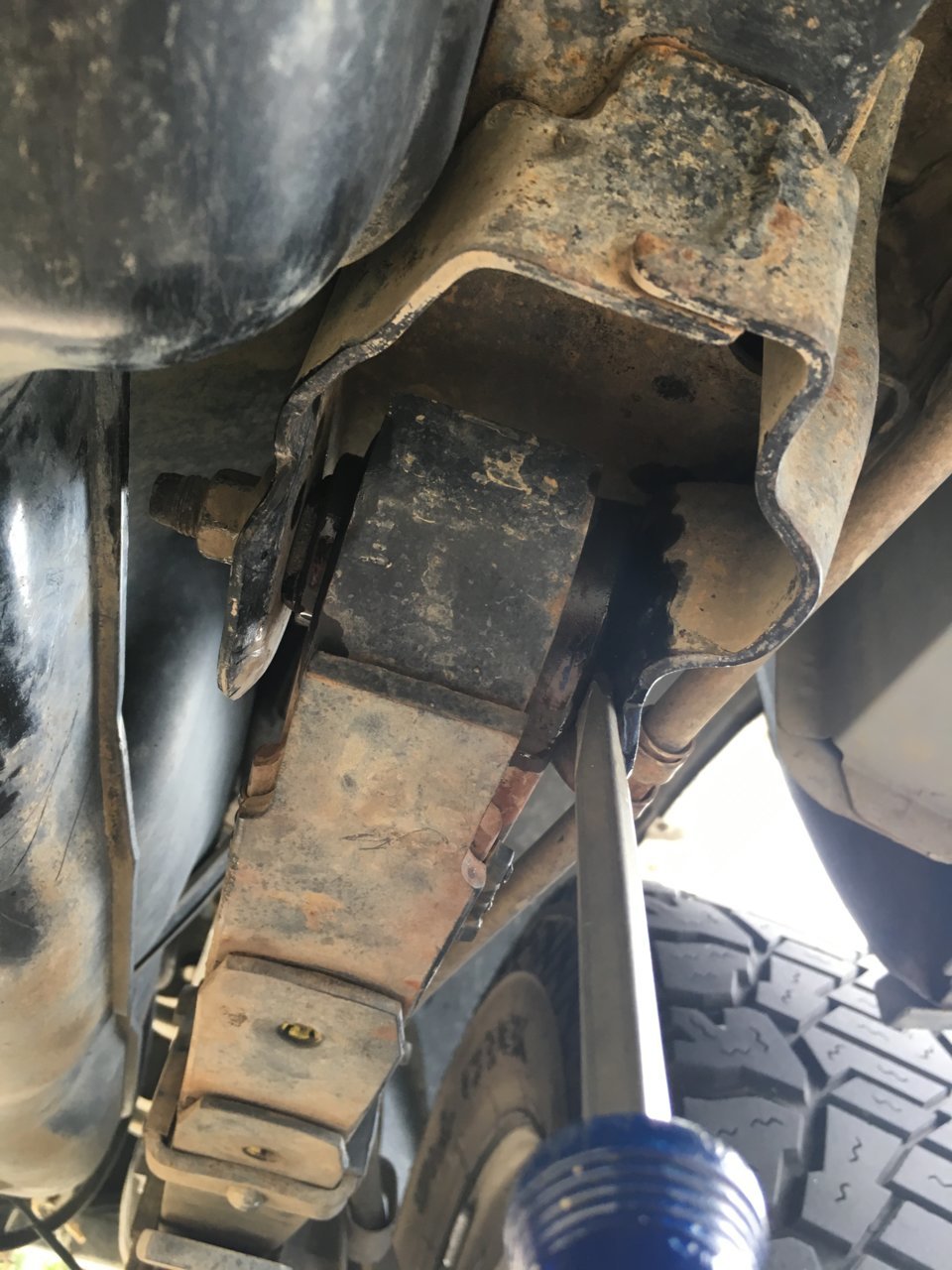

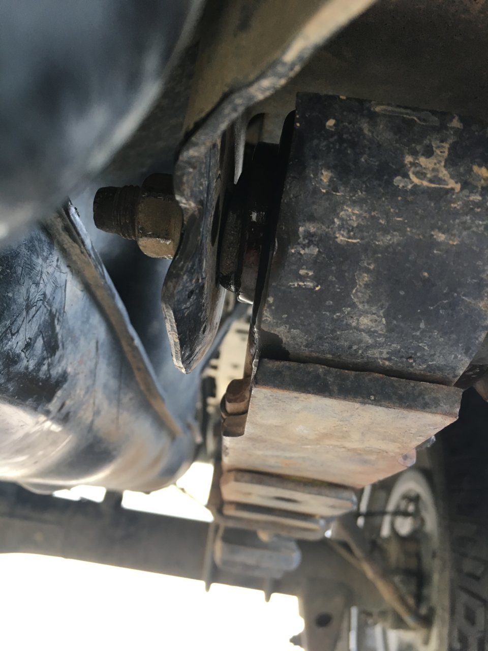

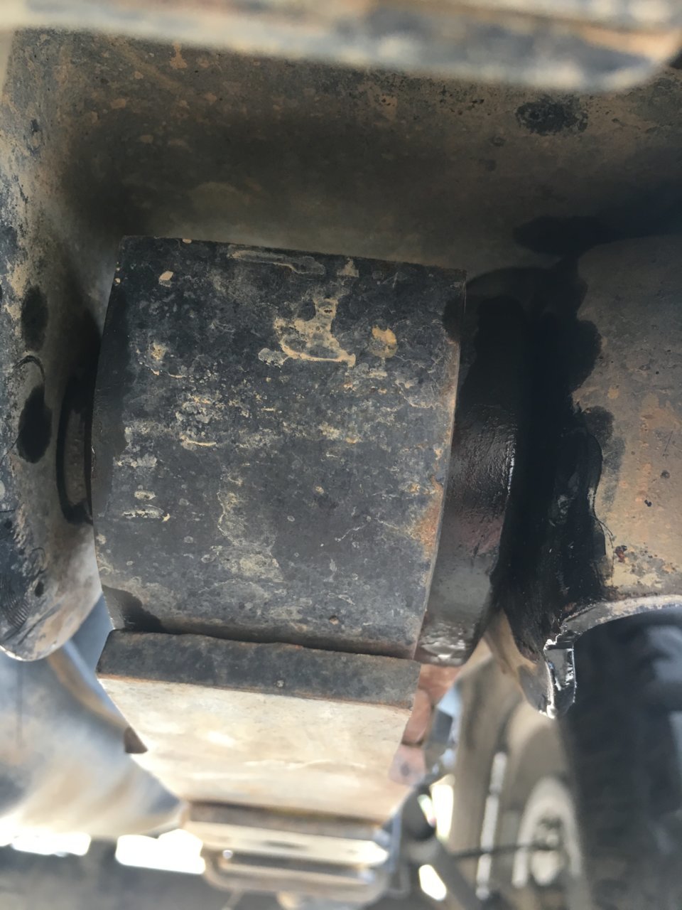

    If you look at the second picture, doesn’t it appear to show possibly too much space between the mounting hole/side of metal & where the new bushing would be?
    I’m winding if I should source some plastic washers or something along those lines to keep the leafs centered in there and help take up the extra room(which of course will put more wear on the bushings. Any thoughts?

    The new poly bushings fit pretty tight into the mount. There won't be room for a washer.

    The replacement bushings have a shoulder that sits outside the leaf spring eye. This takes up a little more room within the shackle and centers the front spring eye. IMO, you won't need any other kind of spacer. Putting too much tension on the front spring eye could cause binding and would rob you of a lot of the rotational travel and performance that these leaf packs offer.
    Secondly, removing the bolts would help a lot just to give you space to work and may actually be necessary. I had mentioned that if I had to do it again, I'd remove the pack from the truck completely just so I didn't have to twist and contort the complete the install. That may just be my old body talking since it takes me longer to recover from physical activity than it did when I was in my 20s, but a recommendation to consider nonetheless. In the long run, removing 4 nuts would be less of an inconvenience than the twisting and cursing and struggling to complete what should be an easy job.
