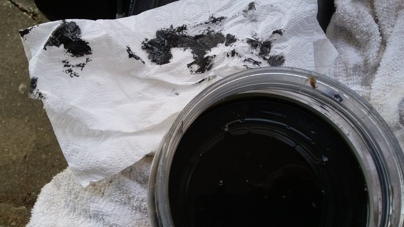

    Today I changed out my front diff fluid. Was expecting to see fairly clean fluid since I don't go wheeling very hard or very often. I do get into 4wd usually once a week tho.
    After changing fluid.. I tried the 4WD-hi on the go... smooth as silk.. no bang and or even a click.. right into 4wd and same with dis-engage on the fly. Now I need some under armor down there. The front diff is wide open and it's not as hefty as the rear diff. LOTS more parts to get messed up on rocks & curbs at the mall.

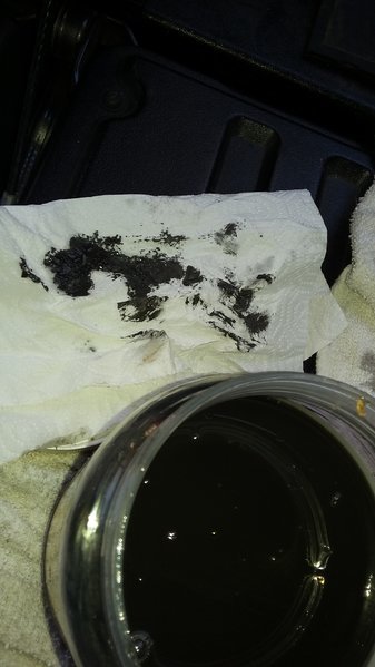

    Here's my observations. Just as much if not more gunk on the magnet. Fluid looked a bit darker than the rear, and the fluid level was low ... stuck finger in hole ... couldn't find the fluid. I drained it out into a container so I could be sure I put the same or more back in.
    FYI anyone wanting to do this. Get the washer kit from Amazon there's a special copper washer for the front diff drain and you need a breaker bar to get it out - I used a 16oz hammer on my 3/8 ratchet handle cause I couldn't find my 1/2 drive socket that fits. I put some dings on the handle.. Glad I didn't wait longer.. I was thinking about getting the torch out. So yeah 14K on the truck... front diff black gear oil... yeah not waiting. I'll do it again next fall and see if it looks better. That Amsoil gear oil is good for 100+K miles. Yeah right... not.
    Washer kit link: I bought extra crush washers from my local Toyota dealer.. since this kit is only for the drain plugs and not the fill plugs. Always good to have extra crush washers. Kind weird Toyota has 3 different style drain washers... but it is what it is.
    https://www.amazon.com/gp/product/B017V4BAXI/ref=oh_aui_search_detailpage?ie=UTF8&psc=1

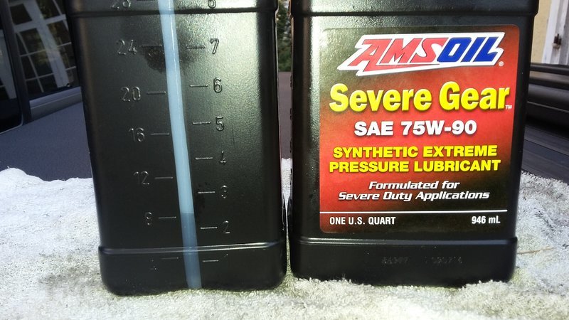

    The owners manual calls for 1.6 gts of gear oil.. I put that much in, don't think I got that much out for sure.
    Here's a pic or 2 of the gear oil after draining: That's black... and there's some crud off the magnet.
    This is what I put in there and what was left after the refill. Filled to over flow...you will need a pump. Well it makes it take 5 minutes with the pump. Takes longer to clean up after than to do the drain and fill.
