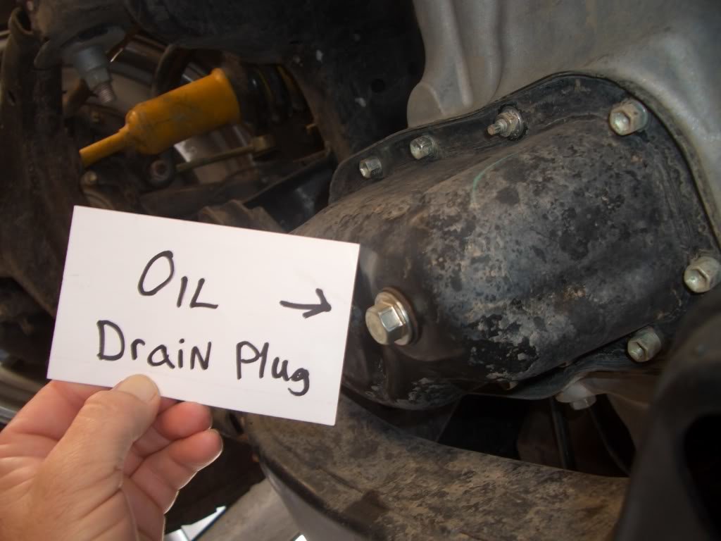

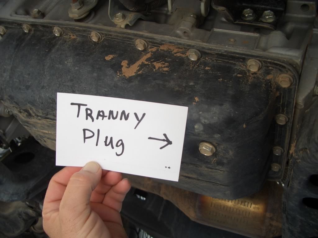

    did you drain the transmission? was the fluid red?
    Did it look like this
    or this
    Pictures from mr4x4

    The dipstick smears on the side of its sleeve as you draw it out. It pushes oil everywhere. Also, if you had just driven the truck, it's entirely possible the oil splashed around further farting up the reading.
    Give it a couple days. Nothing's wrong with your truck. Royal Purple is great oil.

    Welcome to I-drained-my-transmission-ville, population YOU.

    Thanks ktmrider i like to think I'm not that slow. Though I have seen it done on here before. Idk I tend to think oil changes are pretty easy but I'm going to take a little precaution on this and check how much oil was drained into my oil pan and if its 5.5 qts or so. then I'll just drain a little out of the truck. IDK, maybe I blacked out and put an extra qt in their. After that. . . Then I'll eat a sammich:D
  18. Dec 6, 2010 at 6:15 PM
    #18
    ktmrider
    ktmrider Senior Member
    Jul 20, 2009
    #19933
    4,963
    07 DCLB 4x4 Sport S/C
    Junk
    I know you said you had done it before, but in the next post you had you stated it was shifting funny so I just had to ask:)
