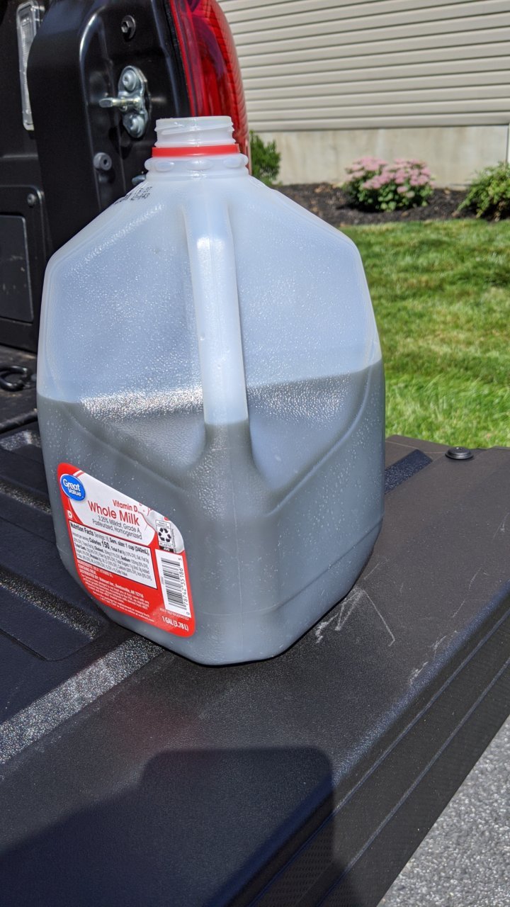

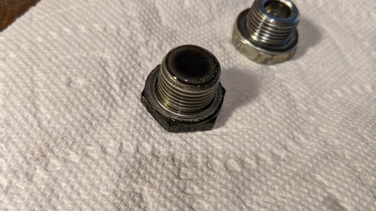

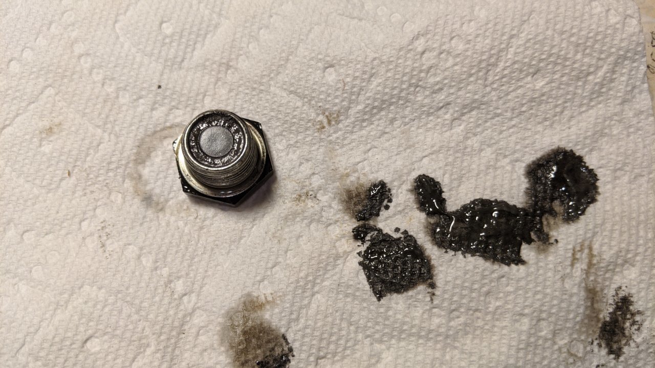

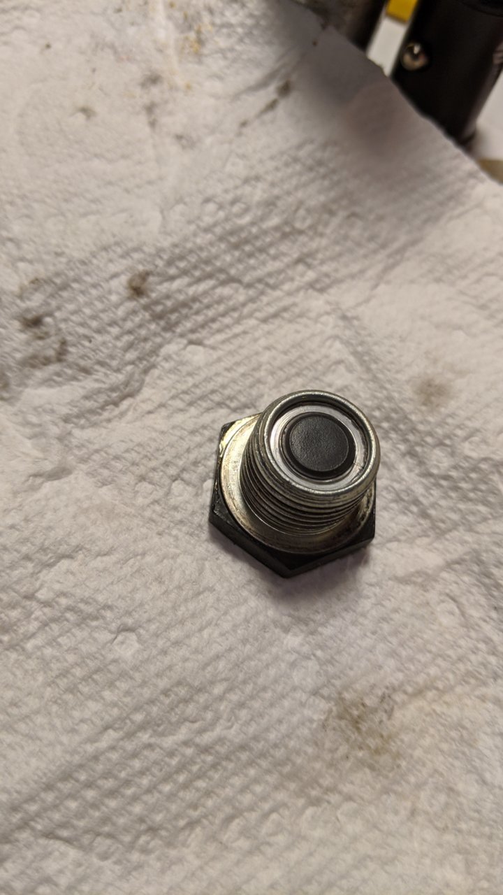

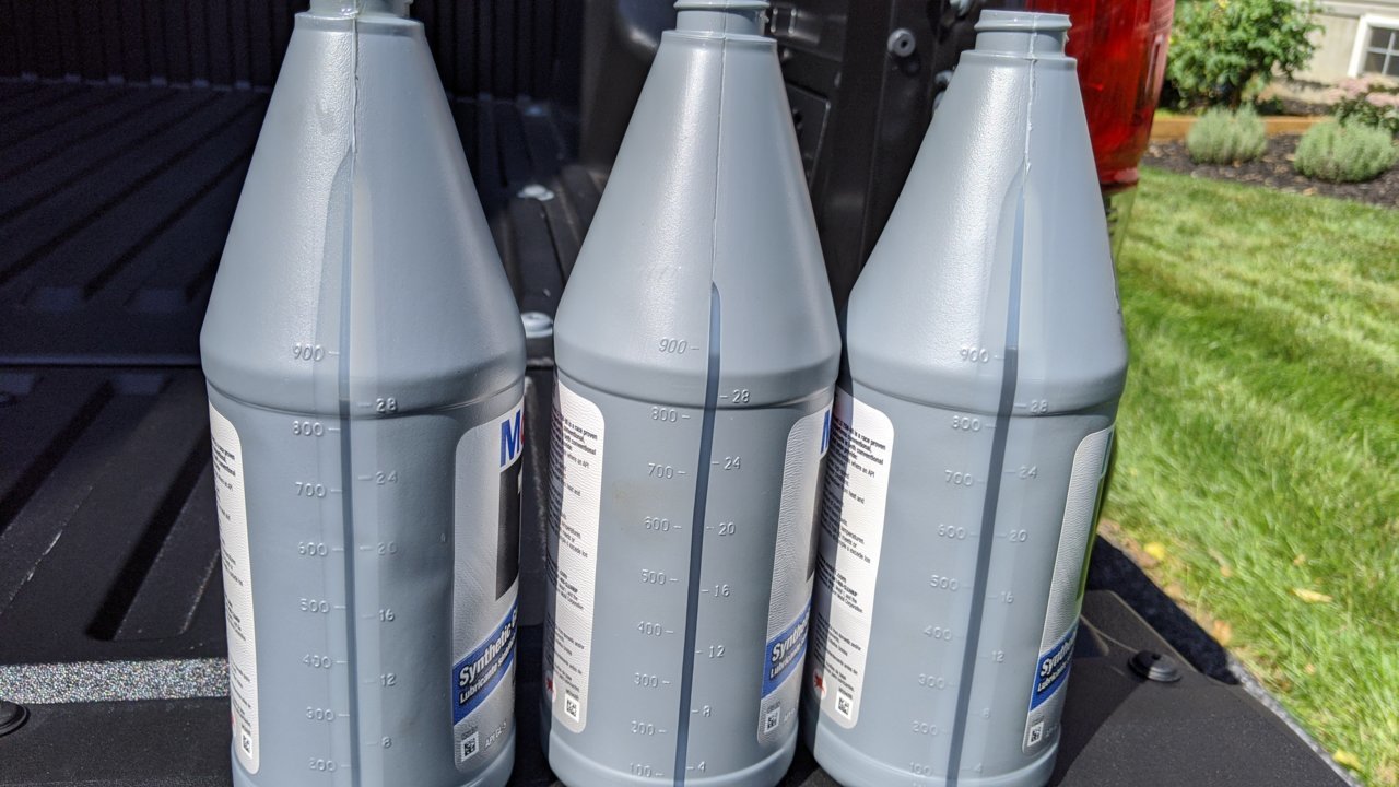

    After reading a bit here on TW and on Bobistheoilguy site, I decided to change the rear diff fluid on my new 2020 Tacoma 2.7 4x2. I drained out approx. 2.8 qts of the factory fluid and added exactly 3 qts of Mobil 1 75w-90 to bring it right up to the bottom of the fill port. The fluid was a little bit dirty as you can see in the pics. The magnetic drain plug had a little bit of that fine ferrous mud on it. No big metallic pieces that I saw. I doubt this change was necessary, but glad I did it as it was a tiny bit low from the factory, and good I'd think to get the break-in material out of circulation.IMG_20200905_112832.jpg IMG_20200905_113349.jpg IMG_20200905_103753.jpg IMG_20200905_103950.jpg IMG_20200905_104131.jpg
