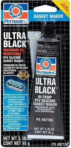

    It looks like some sort of rubberized felt.
    I have Permatex Ultra Black Hi-Temp RTV silicone gasket maker.
    It was orange FIPG. Yup, I'll torque the bolts to 6 ft-lbs.

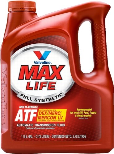

    Removed all the old RTV and put a thick bead of Ultra RTV (no gasket). Torque the bolt to 7 ft-lbs. Letting it cure overnight. Filling it MaxLife.
