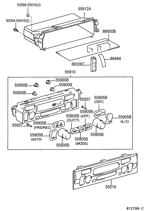

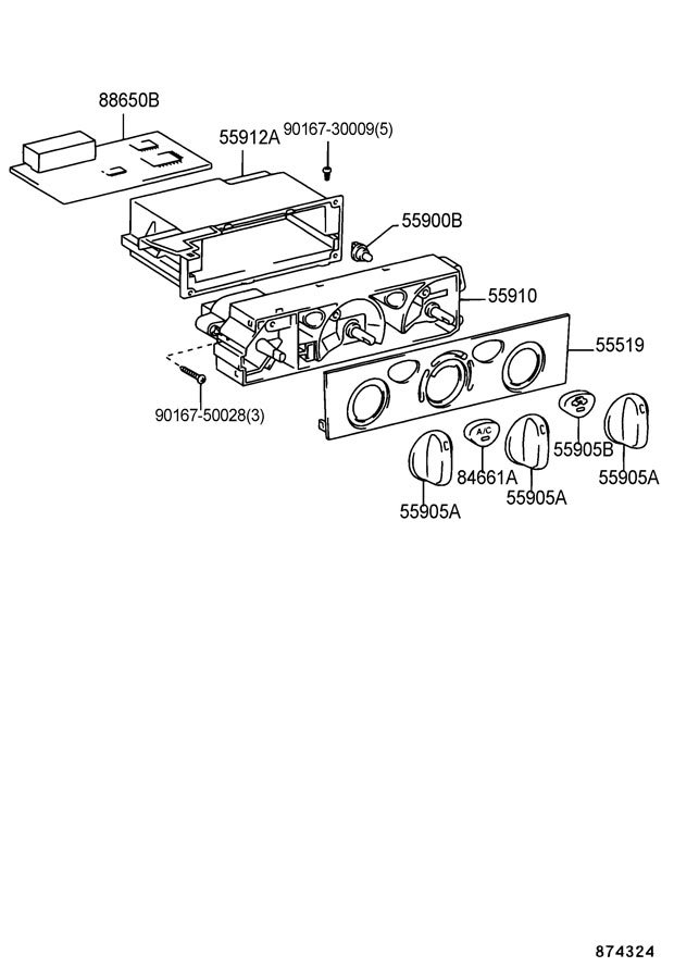

    Below are some pictures of the climate control plate that I took off the dash from my 2002 SR5 DC 4x4. On the back are orange/amber tint sticker-things over each of the areas where the light shows through. Has anyone taken these off to allow just the white to show through (or another color)? I'm afraid to scrape it off without knowing how it will look afterwards.

    Welcome just go and buy the climate control cover off a 02 4Runner it's white. Scraping off the orange is a pain and if your not careful you can mess it up so just buy a 4Runner cover and be done. Then you can change the lights to whatever color you want. Link

    part # 55519 will not fit in my '01, it looks like a very different configuration
    EDIT: my bad, upon a second look #5551935330 should work fine

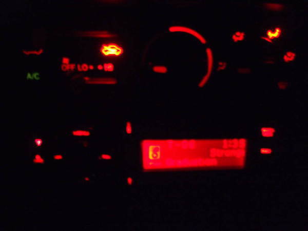

    I haven't done it but I test fitted one from my girls friends Runner and it fits.
