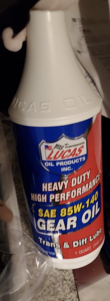

    I have EGCS bushing in mine. They recommend Lucas 85W-140. Bottle looks like this.D86C6FE1-0F93-43E9-A6A6-8C3B5A4BE4EC.jpg

    Don’t use 140 it’s too thick for stock diffs. It will increase likelyhood of seals popping.
    The bushing doesn’t change anything, just use a quality gl5 oil.
    typically 75w90.

    Yes. Use your favorite 75W-90 in the rear diff and in the transfer case. So a little extra work because of the unique oil in the front diff. All are easy to change. I just refreshed the fluid in all 3 on my 2nd gen.
    edit - I’ve had no seal issues in the front. Simply sharing what EGCS advised me to use. I’m happy with their recommendation.
