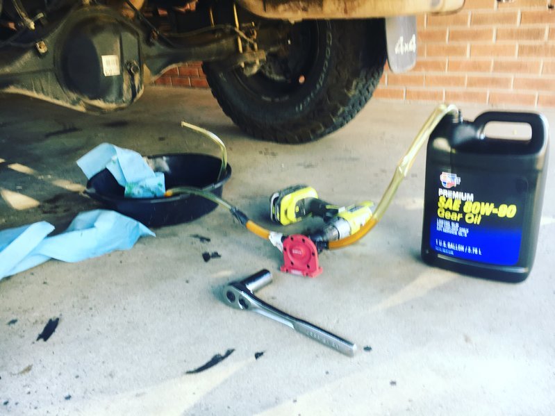

    crolison
    crolison Well-Known Member
    May 17, 2011
    #56801
    3,157
    Ar vah da, CO
    POS
    This drill pump was well worth the $, especially with the front diff.

    Any reason you use 80w90 instead of 75w90? Just curious

    i believe its gl-4 75w90 for transfer case and trans and gl-5 75w85 for diffs
  13. Nov 22, 2016 at 9:52 AM
    eon_blue
    Mar 4, 2016
    #180213
    69,574
    Azusa, CA
    Must be a 2nd gen thing, for 1st gens (1995-2004) it's 75w90 for all 4 (diffs, t-case and transmission).

    Break in fluid / what they had in a gallon
