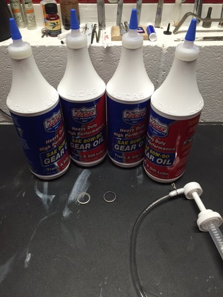

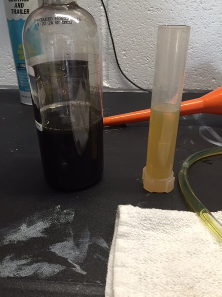

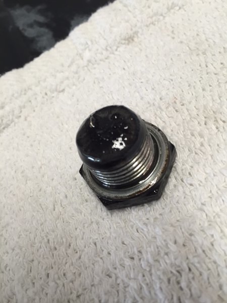

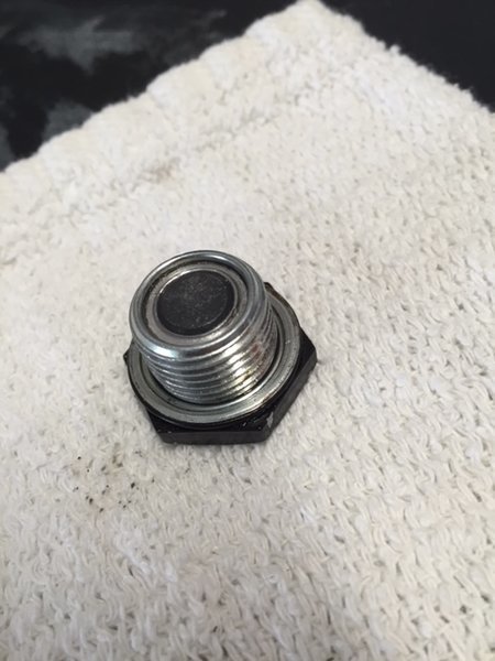

    Just changed the rear differential on my 2013 Baja, 50,000 miles, for the first time. Hope the oil I bought is ok, Autozone by me didn't have the exact weight the book called for...Did get two new crush washers. Hardest part of the whole process was trying to get the fill plug off. I was pulling so hard with a breaker bar that when it gave, I hit myself right in the face. But it's done, made pretty good mess too.

    Also, you can see how dark that oil is. I never dunk it and it only sees the trails a couple times a year, some light hauling.

    Are you guys ok with doing the front dif, rear dif and transfer case all with 80w-90 Lucas Gear Oil (non synthetic)?

    Yes but they came in a washer kit. Kits were around $3.59 ea, I needed 1 of the 6 washers in the kits and bought two kits. I figure I will need the rest of the washers sooner or later
