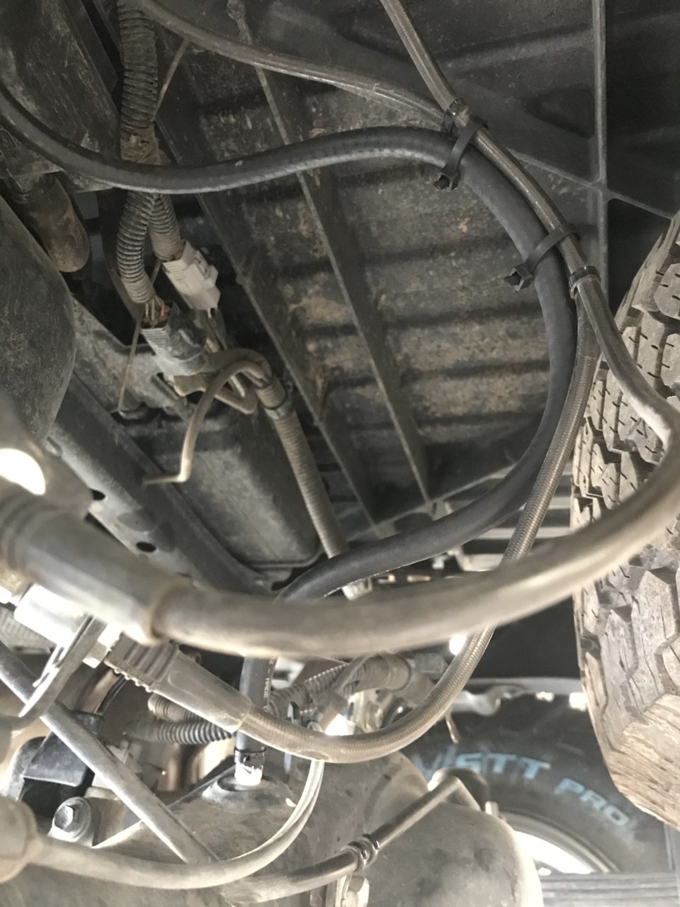

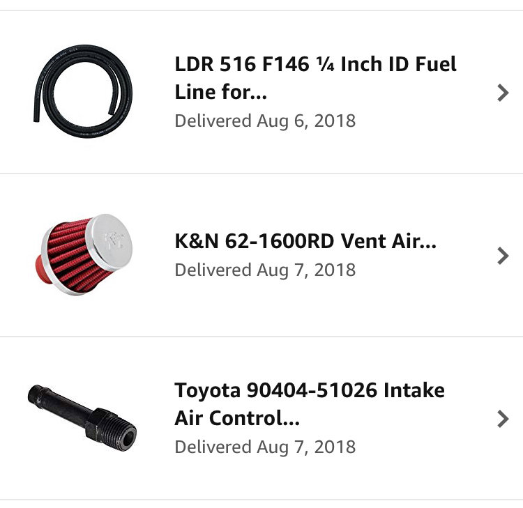

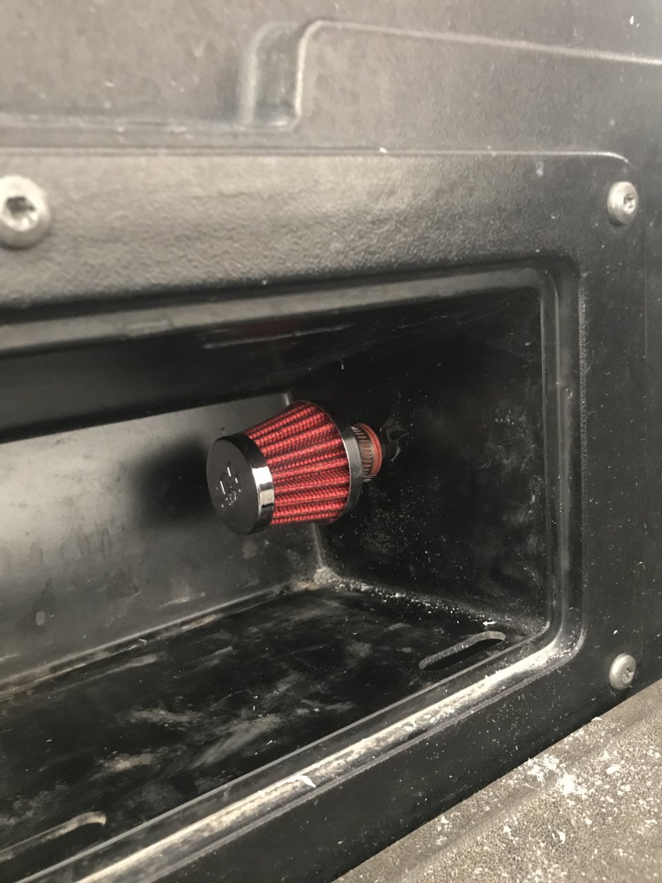

    This was literally SO EZ. Can’t thank you guys enough. Did a rear breather while I was back there too! No idea when this was done last. Truck has 131k. 2008.

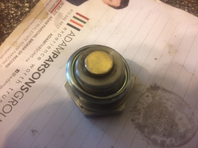

    Did a 30K drain and fill on rear diff. replaced original drain plug with a gold plug AP-05 stainless magnetic.
    The magnet in original plug couldn't even pick up a 24 mm socket, the one in the gold plug was strong enough to pick up the socket and wrench..
    https://goldplug.com/shop/ap05/
    Drove for about 30 minutes before hand so fluid would be warm and left to drain for another 30 minutes.
    Used Amsoil severe gear 75/90 (whats also in the transfer case on front diff
    Gold plug does make a regular hex nut replacement for the 10mm allen key front diff drain plug..might be the solution to the complaints about the 10mm version being hard to remove.

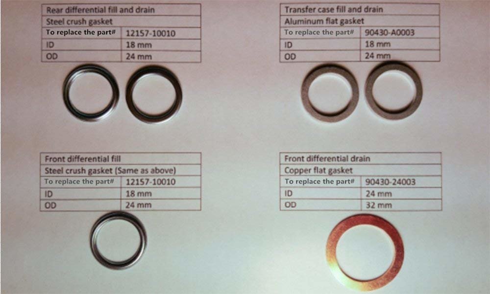

    i went with the oem style steel crush washer on the gold plug for the rear diff... the one it comes with is aluminum..
    I did use the aluminum washer they provide on the transfer case since that is what the factory uses.

    handy picture for reference , shows all the washers , part numbers and locations for front and rear diffs and transfer case.
