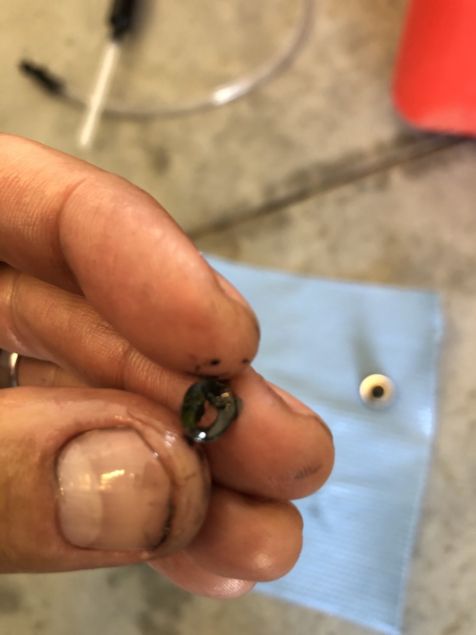

    Finally got to the rear diff and found this on my magnet:

    Good thing the magnet was holding it… Looks like a washer?

    It has a cupped shape to it and is irregular...def not a washer. Shorn off of something...cause for concern perhaps
