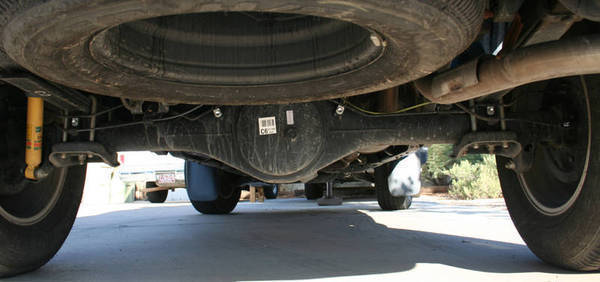

    basically yes, the only difference for each model is determining wether or not you have the limited slip diff (non-TRD SR5's, and Sports).
    ...and if syou do have the Limited slip, remembering to add the LSD additive.
    O/R packaged trucks have a locker/open diff thus not requiring LSD additive.

    most LSD's have C6 sticker.
