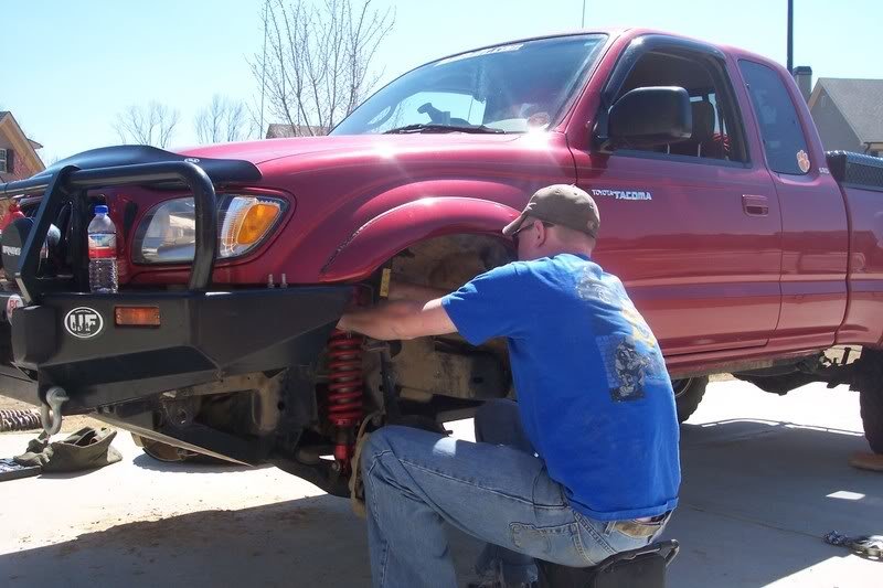

    2015 Tundra
    a little trick i learned while installing my coilovers...at least for the 1st gens...if you need to push the upper control arm/spindle down you can place the bottle jack upside down with the base against the inside of the fender and the top against the upper control arm and jack it "down" until you can get the coilover in place and lined up correctly :D
    hard to tell but im using it in this pic
