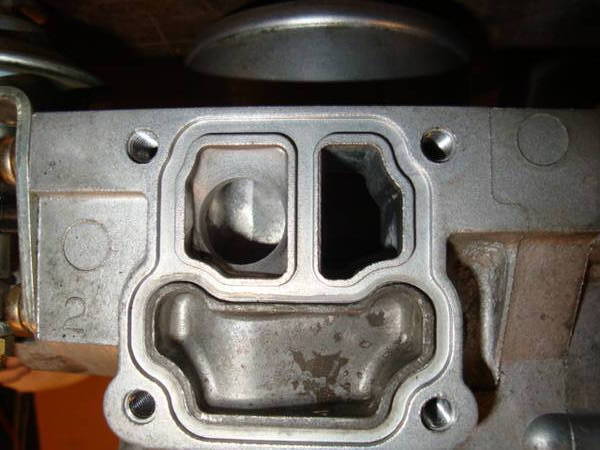

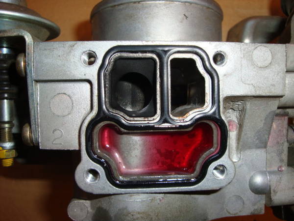

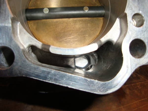

  19. Jun 21, 2012 at 5:32 PM
    #19
    scocar
    scocar hypotenoper
    Nov 11, 2009
    #25814
    39,437
    Denso K16TR11 all around. Don't mess around with different plugs.
    Get a gauge like this, which you need to get between the pronged electrode tips:
    All the gaps were fine out of the box when I got mine recently, but you should check.
    For the throttle body, take it off and clean it on your bench. Much easier, and you can do a much more thorough job. You should get two gaskets: the aluminum crush gasket between the TB and intake plenum, and the rubber one for the IAC valve at the bottom of the TB, which you should take off. Otherwise, when you spray cleaner into the TB, it will drain into the IAC, concentrating all that lovely black goo in there and fouling it worse.
    More pics in my gallery. I thought I had the part numbers for the gaskets in there, too, but I guess I didn't upload to TW.
  20. Jun 21, 2012 at 5:41 PM
    #20
    Robertgeejr1
    Robertgeejr1 Well-Known Member
    Dec 21, 2011
    #69167
    773
    Robert
    Aorora, Ill, yeah!
    1996 Toyota Tacoma SR5 4x4
    I have done all the hi-pro mods for a life time, since I got this truck at a great price, I will be happy with showroom new.
    very good pics! you will shit when you see how dirty they get! I spent the better part of 2 days cleaning mine. get some cheap toothbrushes
