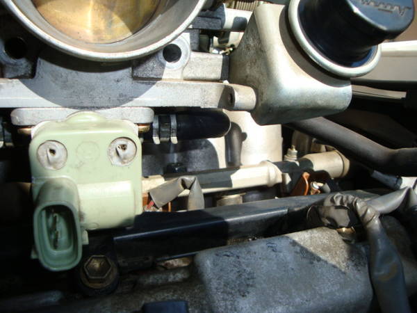

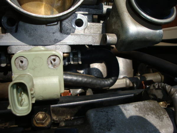

    http://www.tacomaworld.com/forum/1st-gen-tacomas/5696-2001-2004-tacoma-factory-service-manual.html
    The trickiest part is reconnecting the two little coolant hoses when you put it back on. there is not a lot of play, and it is hard to orient them correctly until the TB is back on. Reuse the original clamps, and make sure the prongs are facing you so you can grab them and adjust the hoses after the TB is in place.
    Here it is kinked before adjustment.
    Here is is after loosening the clamps and unkinking the hose.
  19. Jun 21, 2012 at 7:48 PM

    he is right about this, this was the bitch part.
