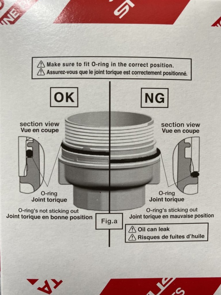

    Apparently if the metal tube in the middle comes out, the whole housing should be replaced.

    Here is a picture of the O-Ring position.

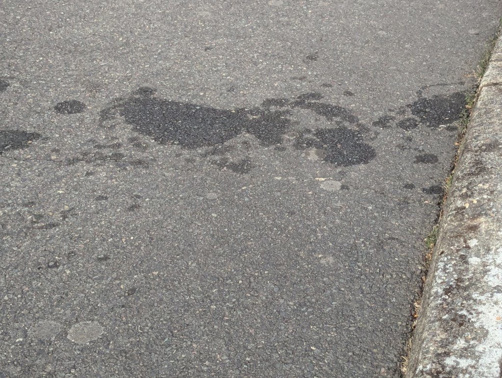

    I change my fluids in my street (residential neighborhood with very little traffic). When I am finished, I have smaller stains than what is under my neighbor's junker work van. Just wanted to post this picture to prove a funnel is a great tool.

    Illustration on filter box shows how to seat the o-ring.

    6) Install the filter housing o-ring correctly as shown on the filter box. Avoid over-tightening the filter housing when re-installing.
