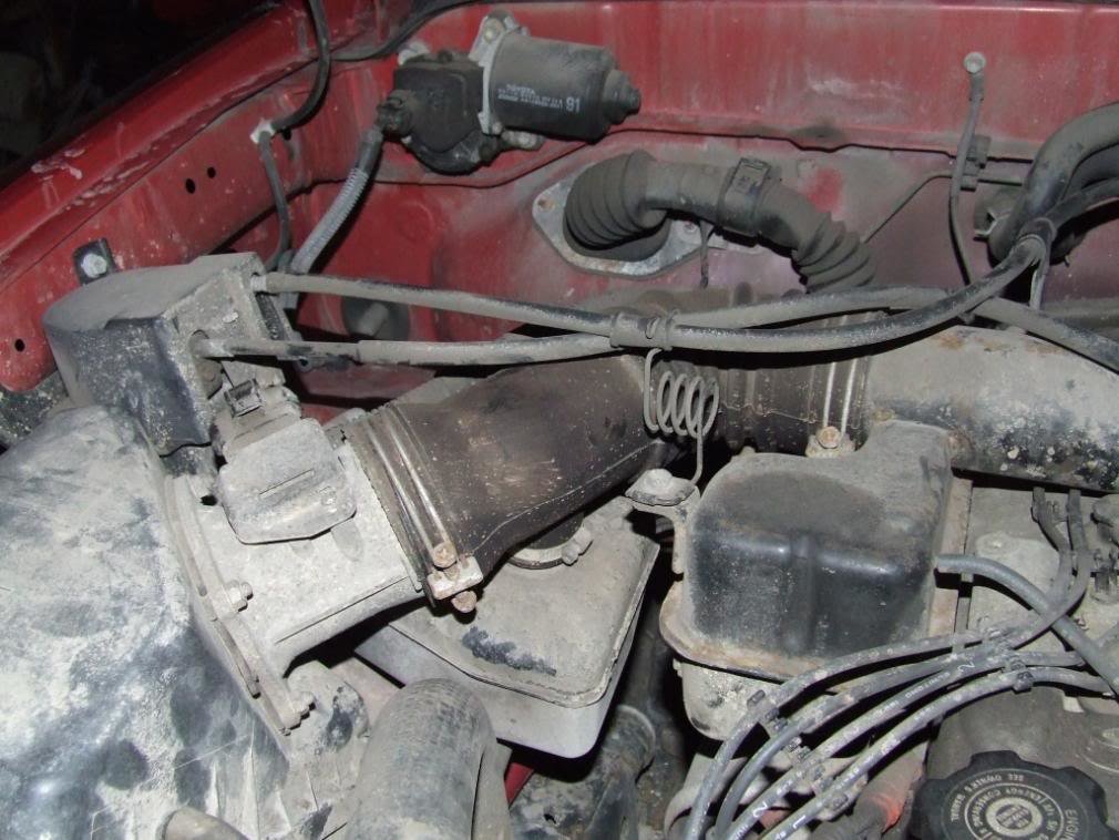

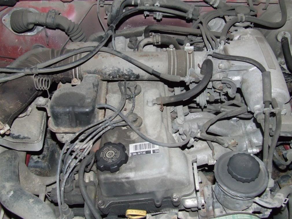

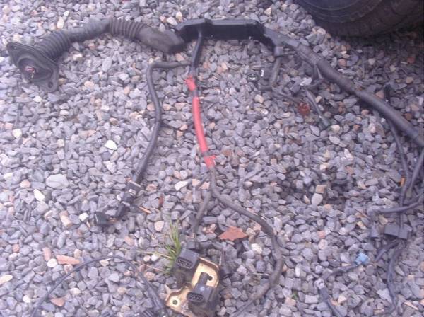

    ben, the 2.4 came with those on the left front motor but i have no plug in from my wire harness to plug them in i can up load some pics to show you wat i mean if you want

    Pics are always helpfull. Do you have the hareness from the 2.4 also?
    And those would be where the plugs attach to.
  15. Sep 23, 2009 at 8:28 AM
    Maxola89
    Maxola89 [OP] Active Member
    Sep 23, 2009
    #23191
    27
    Norton, VT
    2000 Tacoma 4WD Short Bed
    2.7 swap for a 2.4
    yes but it was cut right before it goes in the dash brb
  16. Sep 23, 2009 at 9:15 AM
    #16
    Maxola89
    Sep 23, 2009
    #23191
    27
    Norton, VT
    2.7 swap for a 2.4
    ok theres a few i put up
