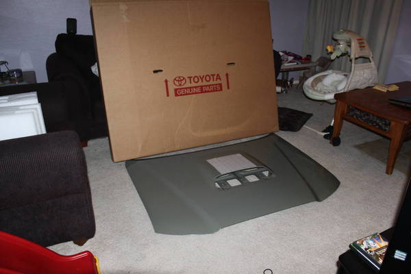

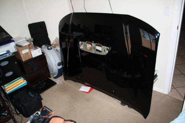

    before paint
    ready for the scoop and mesh filter

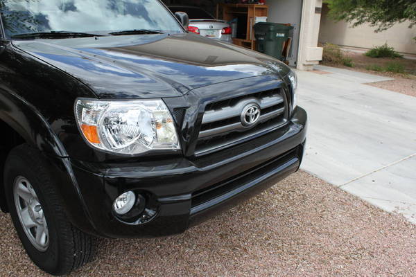

    before
    after
    Actually managed it by myself
