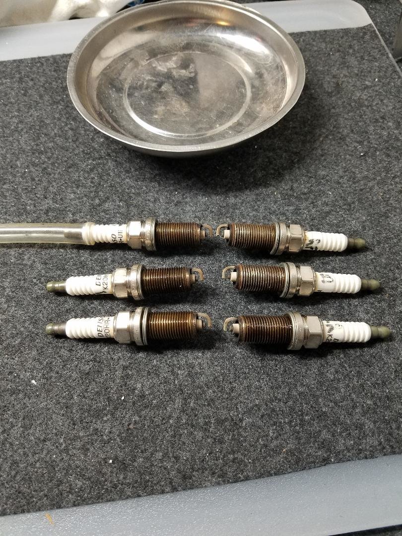

    outdoorgb
    outdoorgb (.)(.)
    Jul 30, 2014
    #135065
    882
    Burbs of Oregon
    2014 DCSB TRD Sport Silver Sky...
    60K plugs.jpg I did it three times on my 2006, and now twice on my 2014.
    Extensions are needed but here is a wanna-be pro tip.
    Use a foot long piece of 3/8" plastic tubing to take out old plugs and put in new. Sure, some sockets have the rubber insert for plugs. Using the tubing ensures a nice hand start to the thread.
