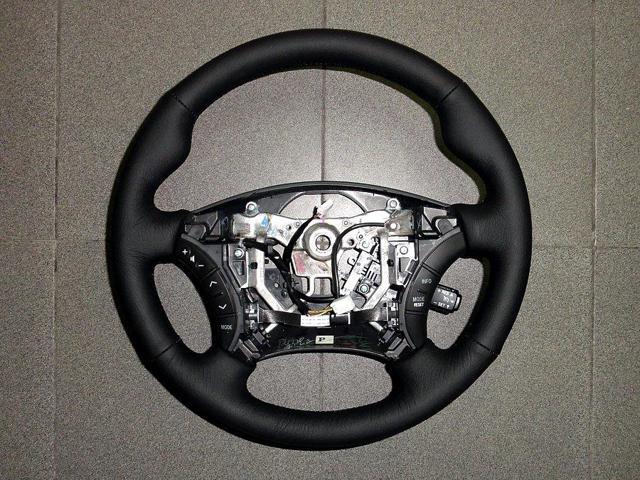

    Quick question, my dad picked up a beat up 2002 Tacoma and we've been slowly nursing it back to health (motor swap and new paint job!) but something that bothers me is the steering wheel, it looks ghetto AF.
    I'm able to source OEM steering wheels but I've been watching clips online of aftermarket wheel swaps and they all seem to require complete disassembly of the wheel basically down to a bare steering column.
    Is this necessary? I'm only trying to change the outer part of the wheel, and plan on using the airbag I already have. I linked a picture of the current wheel and what part I'm trying to change. I'm not trying to accidentally mess up sensitive parts like the clock spring so I'm hoping this is an easy swap.

    You want to use an original 2001-2004 1st gen steering wheel? Tearing down the column is only if you want to use the 2005+ steering wheel you linked with the audio controls and Bluetooth.
    If you want to use a 1st gen steering wheel it’s as easy as unbolting the one bolt connecting it to the shaft, using a steering wheel puller, and putting a new one on.

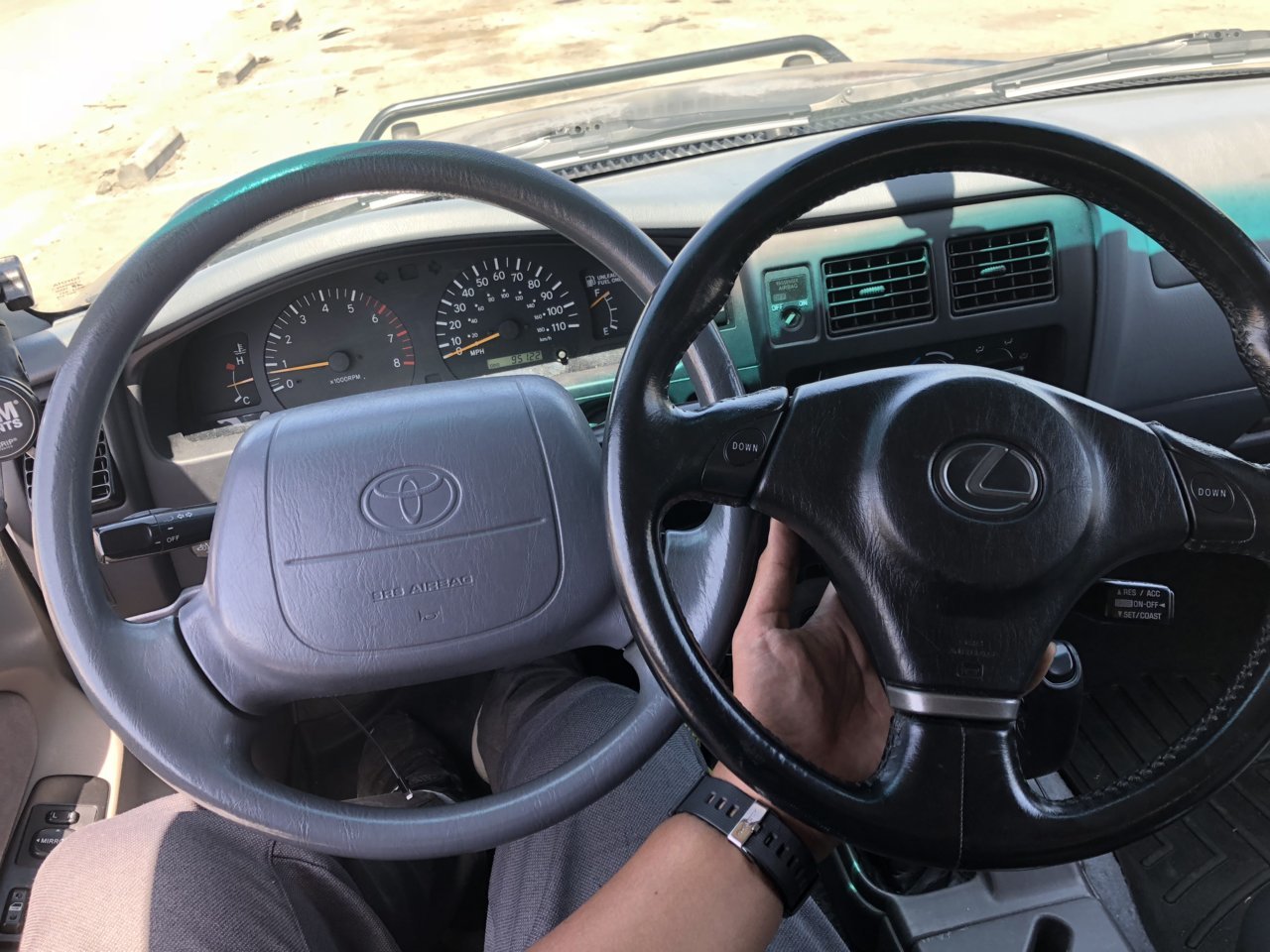

    I put a Lexus IS300 steering wheel on my truck. I just had to swap the clock spring to control the airbag.

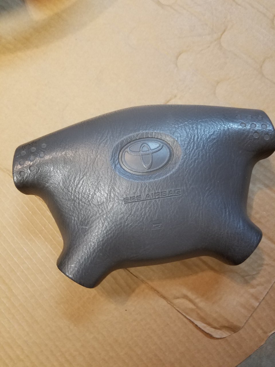

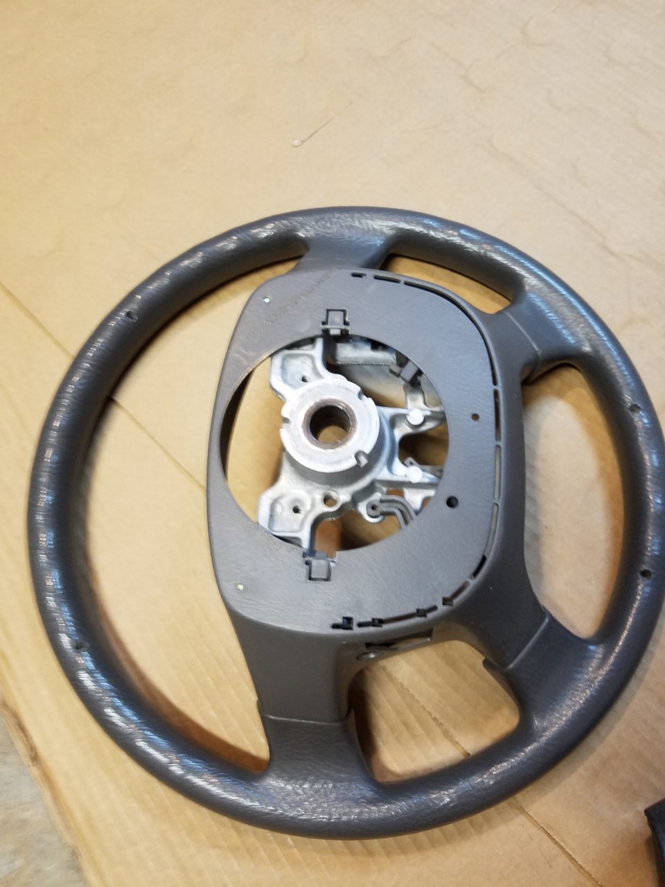

    I have this one I'll sell for $50+shipping without airbbag. $100 with.

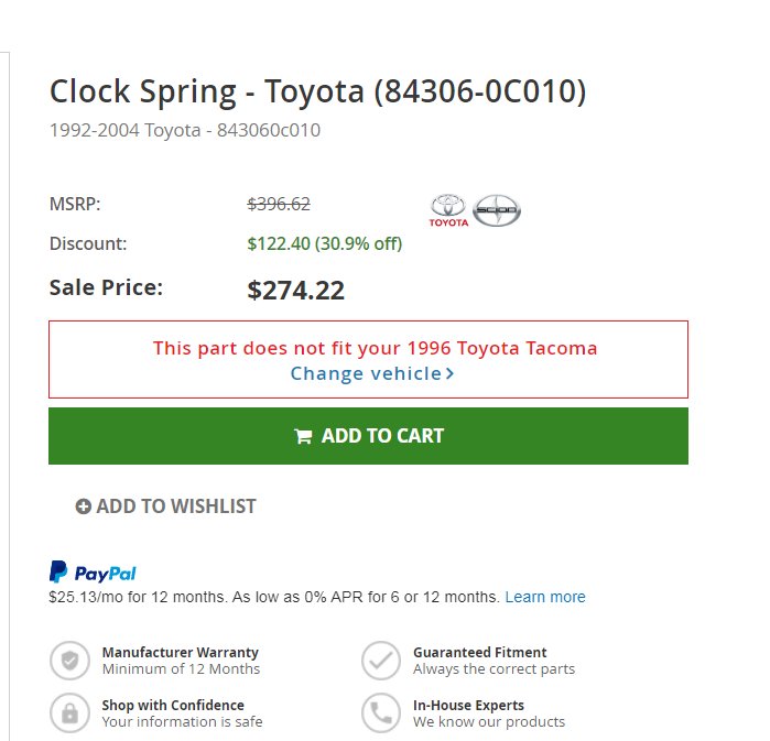

    I want to say no based on what toyota parts shows (see below image) but then again... :notsure:
    Clock Spring
    1992-2004 Toyota - 843060c010 (this one shows for my VIN)
    Clock Spring
    1995-1997 Toyota Tacoma - 8430604040
    *discontinued*
    I'd call your local parts counter in the morning, give them your VIN and ask them for the part# of the clock spring.
