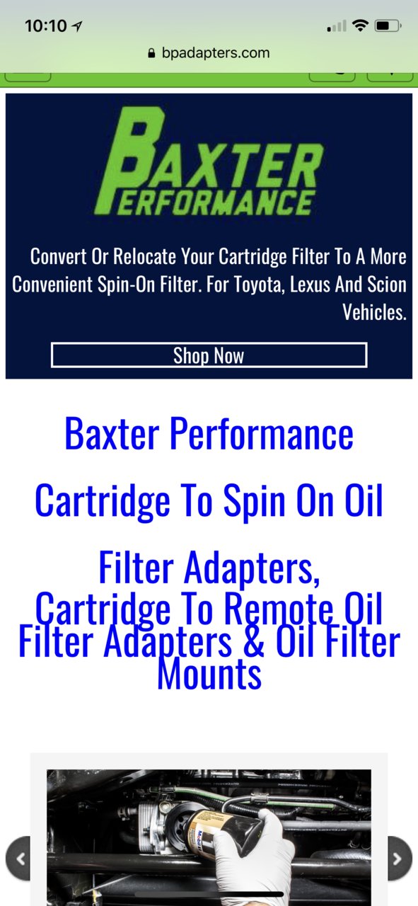

    You can spend a couple hundred bucks and eliminate the cartridge filter to spin on, and relocate it.
    Question is, is getting rid of the aggravation every 10k miles worth a couple hundred bucks?
    Check out bpadapters.
    Cartridge filters have been around for awhile. Chevy put them on their small blocks with 4 bolt mains for many years.
    I would like to hear if there is any argument that cartridge filters are more or less effective at removing contamination than spin-on.

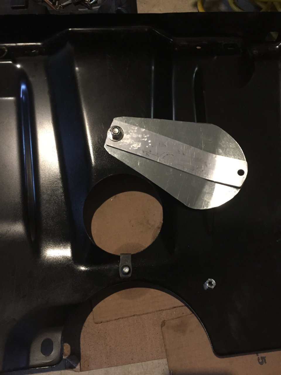

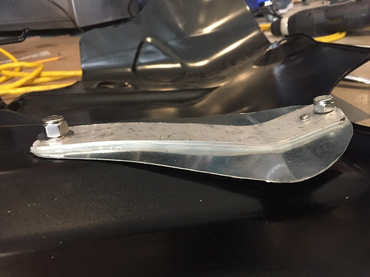

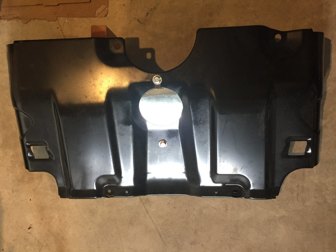

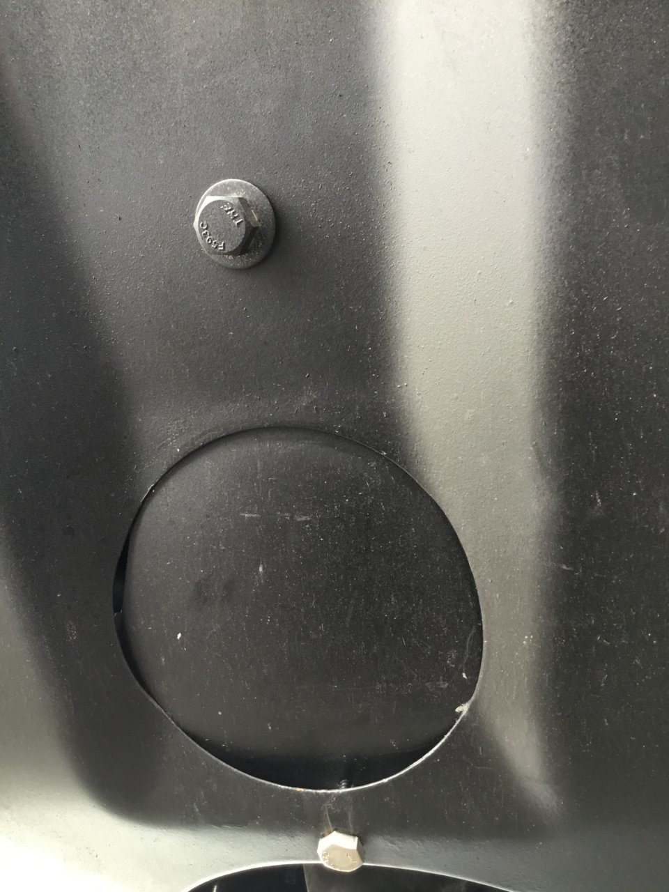

    It’s easy to cut an access hole in the deflector. No more bolts to remove.
  16. Sep 3, 2018 at 6:42 PM
    #16
    Amanelot
    Amanelot Member
    Jul 29, 2018
    #260931
    1,869
    Texas
    2016 MGM TRD Sport DCSB
    Are there any downsides to this?
  17. Sep 3, 2018 at 7:21 PM
    #17
    OregontoBajaCA
    OregontoBajaCA 2025 DC OR High Bread
    Dec 6, 2017
    #237812
    834
    2025 OR DC iF Max
    I haven’t experienced any? It’s just a thin shield. If it gets damaged, no big deal. You can then just buy a real skid plate.
    Used scrap metal in the garage.
