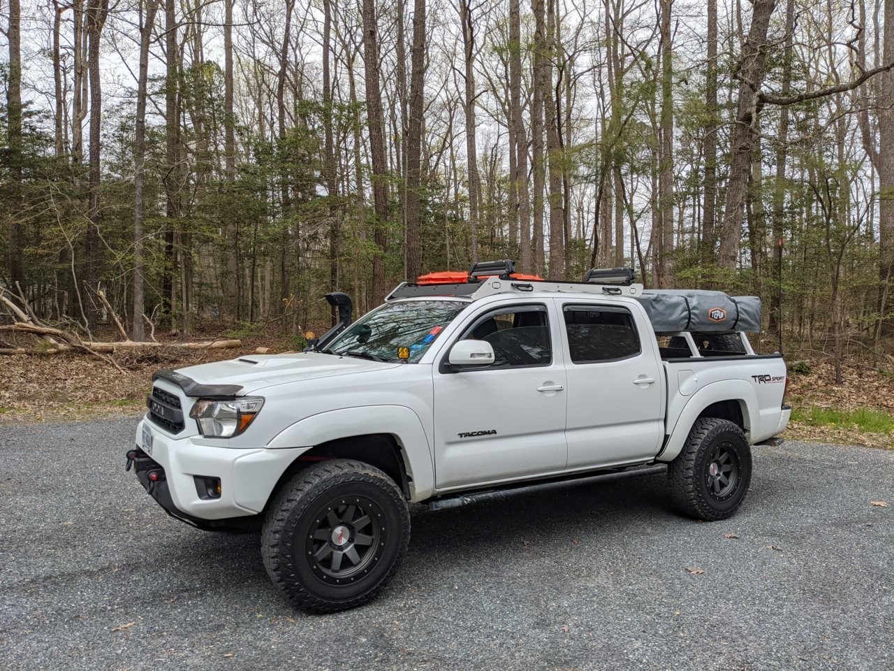

    Hello TW, I figured I have enough mods under my belt to open up a build thread for my truck. I have a 2015 Super White Trd Sport Double cab short bed. This is my third vehicle, but first pick-up. I've always been a fan of Toyota's, as i previously owned a 3rd gen T4R which was my first car. Tacoma's have always had my eye, so after i graduated college and got a decent paying job, I went out and bought myself something nice.
    List of Mods/Parts
    Suspension:
    Front 5100s @0
    OME 887
    Headstrong 1/4in lean spacer
    Elka 2.5s non resis CoilOvers
    JBA UCAs
    ICON Progressive Rear AAL
    ICON RXTs Stage 2
    Fox 2.0 rear RR w CD adjustors
    Roost Shield on Pass.
    Archive Garage U Bolt Flip w Speed Bumps
    +2in rear brake lines
    Wheels/Tires:
    SCS SR8's 17" Gunmetal
    265/70/r17 Falken Wildpeak AT3/W
    255/80r17 Cooper ST Maxx
    TRD Center Caps
    Interior:
    Hondo Radio Knobs
    AC outlet
    GTX-455 Rearview Mirror
    A Pillar Ram Mount
    Glove box & C.C. Organizers
    MESO Red map light, and white dome light
    MESO 6 gang Overhead switch panel
    Birddawg Industries Tech Deck Extreme
    iPad Ram mount
    Exterior:
    TRD Pro Grille
    OEM Bug Shield
    Dobinsons Snorkel
    AVS In-Channel vent visors
    Front tint
    OEM Roof Rack
    Martin Offroad Roof Rack
    upTOP OverLand AAP
    upTOP scenePODs
    Pelican Vault v770
    OEM Bed Step
    OEM Bed Mat
    Softopper - Grey
    Kore 8in rise Bed bars
    Tepui Kukenam Sky 3
    KB VooDoo Tailgate Cap
    WaterPort
    Custom Swingout Tailgate
    • Flip down table
    • Spare mount
    • SSO backup camera relocate
    Armor and Recovery:
    Mobtown Front Recovery Bar
    BPF "TRD" Stamped front skid
    Mobtown Front Alluminum Skid
    Mobtown Bolt On Sliders
    Coastal Offroad Rear Aluminum bumper
    Coastal Offroad single swingout
    Lighting:
    TRD Pro Headlights
    Ultimate Headlight Mod
    Baja Designs Squadron Sports Combo in Amber
    Baja Designs Squadron Sports WC Fog Mounts
    Cali Raised Side Shooters
    Cali Raised Ditch Light Brackets
    LED bed lights
    21in Amazon Lightbar behind grille
    DIY raptor lights
    Jumper's 5 Cree LED reverse lights
    Rigid Chase Red
    Baja Designs Rock light x4 (Roof Rack)
    Comms:
    Uniden Pro505xl CB
    Rago Fab CB mount
    3ft FireStik
    Midland GMRS
    Midland stubby gmrs antenna
    Current Photo
    A couple of photos from when I brought her home from the dealership including the first mod, the SaltLife sticker.
    Not much changed over the first year of ownership. I've taken her on the beach a few times but no hardcore trails or anything of that nature. She is a pavement pounder and will be the DD for a quite a long time.
    Uncle Sam gave me some cash back so I had the front windows tinted to 35%, and the storm trooper syndrome set in. EVERYTHING MUST BE BLACK. I also did the badges at some point. Removed them, sanded them down, and painted them Graphite grey with Krylon Fusion paint. I like the look of the grey badges with the TRD pro grille I had the dealer throw in when I bought the truck.
    The next mod was replacing the chrome headlights which started to drive me crazy after I had the window tint done. I went with the TRDpro headlights, and like the look a lot. I considered doing the BHLM but I prefer OEM quality especially on a new truck that isn't paid off yet.
    Here is a side by side comparison of the headlights. Not much light in the photo, but they are darker in person.

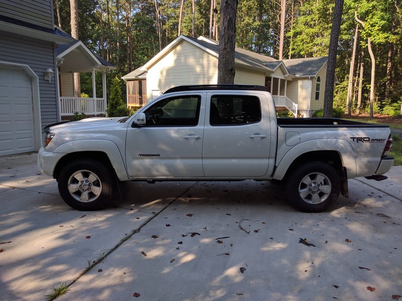

    I just ordered a set of Falken Wild Peak AT3/W in 265/70r17 along with some 5100's for up front to level the truck out. The dealer found nail in one of my tires and since I would rather have an AT tire anyways, I figured I would just go ahead and buy 4 new tires. I'll post some pictures once I have them installed! BTW, Dealer wanted 300 bucks to install a new Bridgestone HT tire. All four Falkens I bought were 750 mounted, from a local tire shop. They are also doing the Billies up front and have done quite a few sets on Tacoma's and other Full size trucks.
    Before 5100's and tires
    After 5100's @ 1.75 and 265/70r17 Falken AT3/W's

    5100's and 265/70r17 Falken AT3/W installed today!
    I have my alignment scheduled for tomorrow. I can visually see positive camber so figured its best to get it done ASAP. These tires look much more aggressive in person. They have raised lettering on side (i chose to face this side out) and then smooth lettering on the opposite. No white letters on either side.

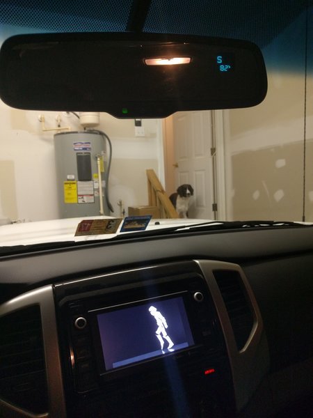

    Last weekend I installed a new GTX-455 mirror and played around with some images on the factory entune.

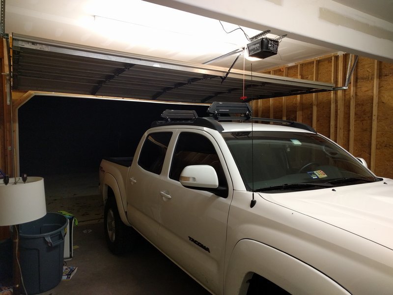

    I have a fishing trip with some buddies down in Hatteras this weekend and we decided on just taking 2 Tacos. The other choice would have been a 1500 Chevy work truck... So kinda of an easy decision. The other truck is a 2014 Sport with I think is a Rough Country 4.5 spacer lift and 33s.
    My dad gave me his spare ski (fishing rod) rack off his truck and I bought some Mighty Mounts from Yakima to bolt them to the factory roof rack bars.
    Not as sleek as I want but it's functional. The racks are pretty dated, notice the factory Ford logo on them.

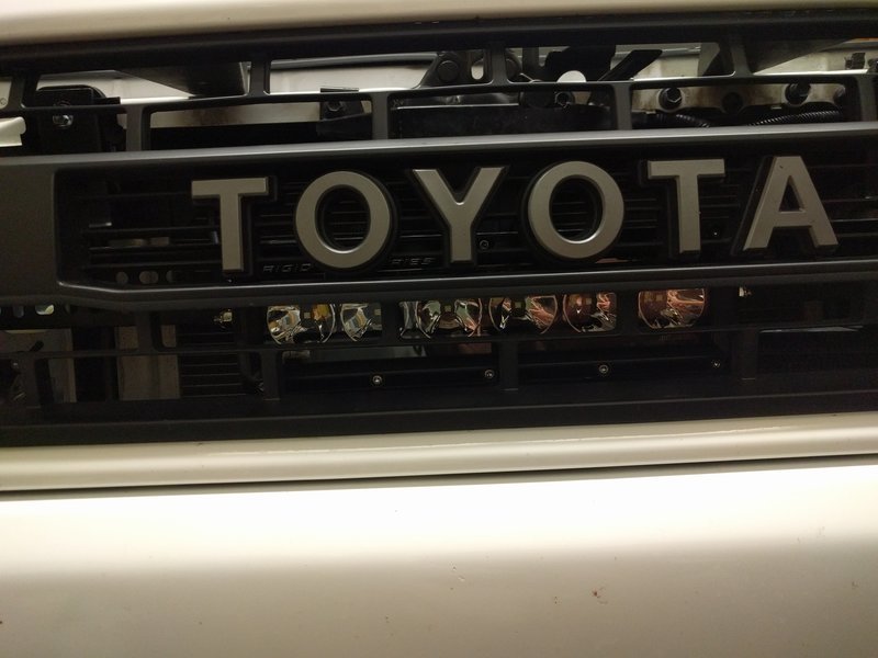

    Not that anyone actually watches this build, but I've been working on a Behind the grille light bar mount. Everything is mocked up, now I just need to get the spacing and positioning correct so my light bar fits nice and flush.
    I'm using a 10 inch Rigid Radiance bar with the amber backlight.
    The bracket on the passenger side has some flex to it as it needs a backplate to keep it sturdy. I also need to cut out a section in the middle so it will sit flush against the hood release support. I want to put a hole for a third bolt there.

    I mounted up the LED bar and ran the wires so everything is ready for SPDT switch I ordered. The switches supplied by Rigid are dorky in my opinion.

    Drilled the center support hole to add the third bolt in the hood latch support. Added a 1 inch spacer, washers, and rubber washers.
    And moved the bar a bit off center so all of 6 LEDs have a clear shot straight. I didn't want to cut the Pro grille up for obvious reasons. Aiming this thing is a PITA. I need to go on a dark, level trail.
