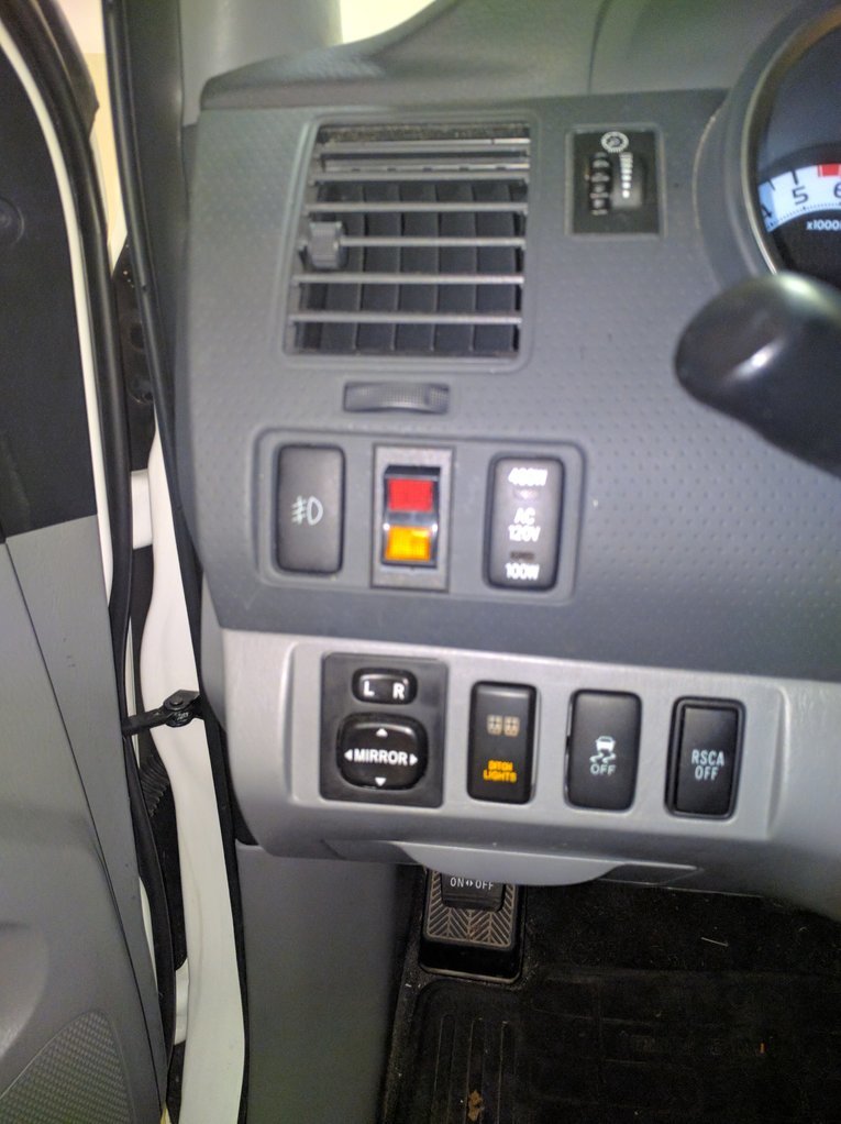

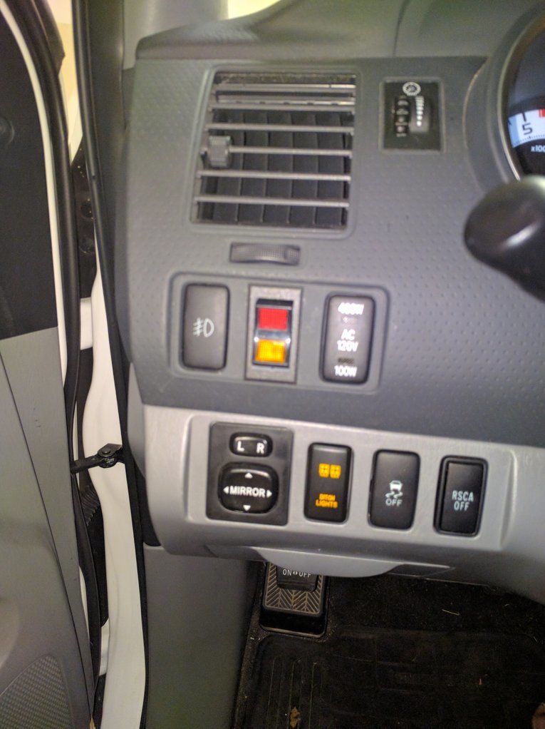

    After blowing three fuses, contemplating pleading insanity, I realized the relay harness sent to me by Cali Raised was wired backwards.
    Once I realized Black and Blue were flipped, I was able to get my OEM style switch rigged and tested. The Relay is wired hot to the battery. I need to look at getting a fuse block soon!
    Parking lights On and Switch Off
    Parking lights On and Switch on.

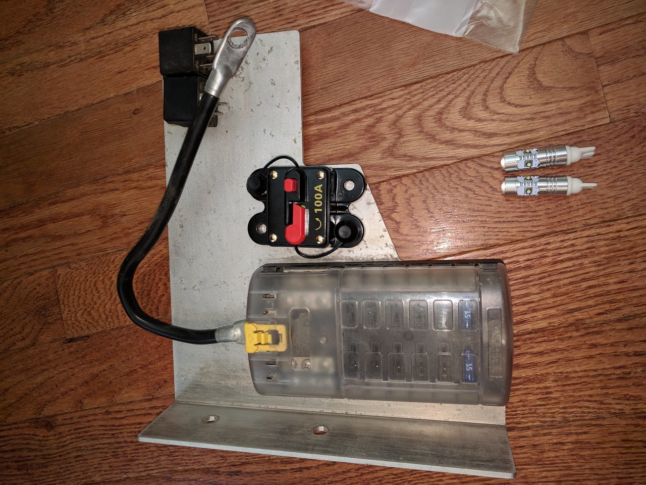

    Jumper Reverse LEDs ordered. Hoping that satisfy my backup lighting needs without having to install aux pods back there.
    Also bought an auxillary fuse block mounting plate and Blue Seas 12 accessory fuse block from a fellow member. Time to get the wiring nice and tidy under the hood.

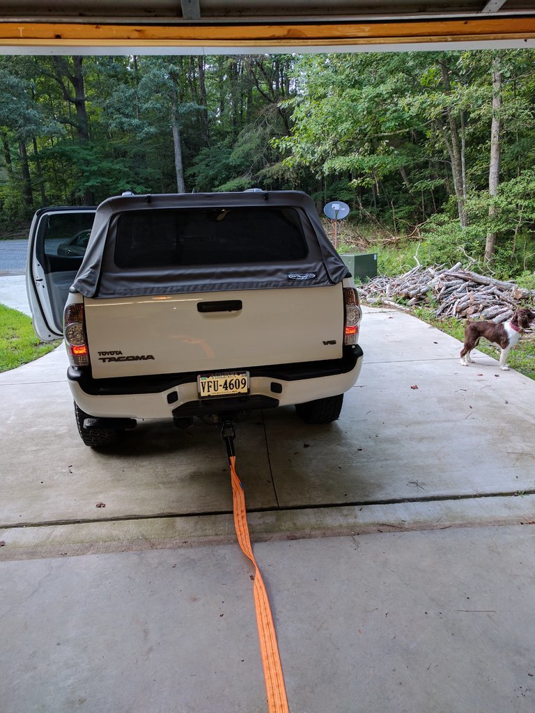

    D ring for the hitch came in, along with my strap my recovery game is getting stronger.

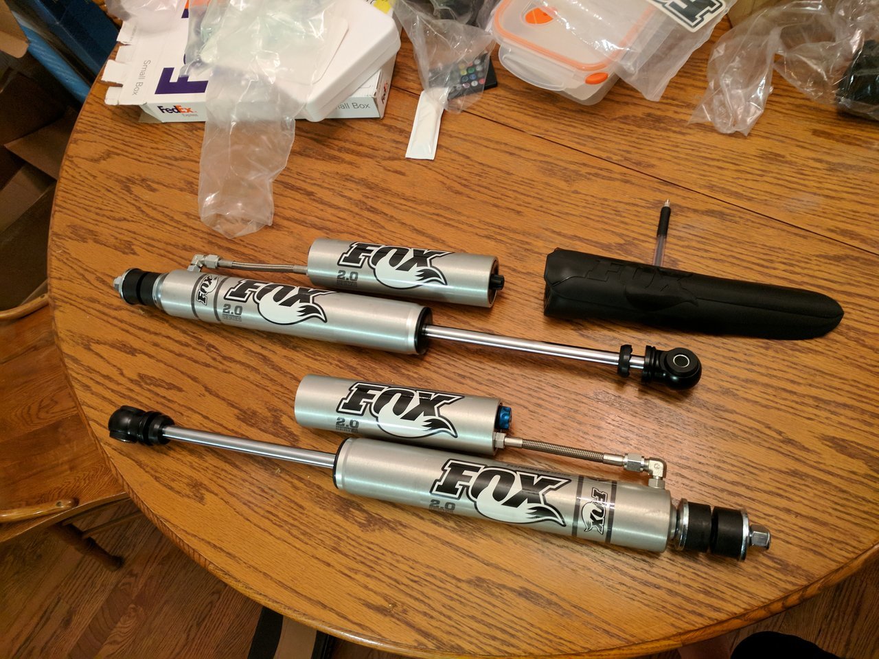

    Fox Group buy is ongoing. I might be jumping on some 2.0s RR with CD adjustors. That should complete the lift with the exception of new bumpstops but that'll be awhile.

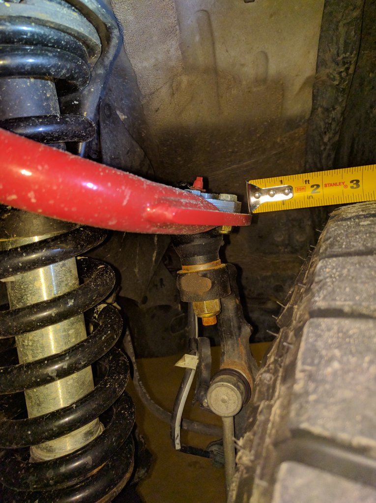

    Do your wheels clear your UCA just fine? I was looking at the JBA UCAs and it said that wheels with 4.5" BS was required, but RAY SR8s only have 4-4.3" of BS (16-17").

    Yep, no issues whatsoever. Also, mine are SCS SR8s, not SCS RAY 10s.

    This is with the wheels straight. I haven't noticed any rubbing on the UCAs when turning though. My truck also doesn't see hard core trails so I haven't pushed the suspension to the max.

    I'm pretty sure I said SR8s...but thanks for the pic. Looks like your tires are 10.4" wide and the size I want is about 11.2". Should work just fine. Did they net you a good amount of caster?

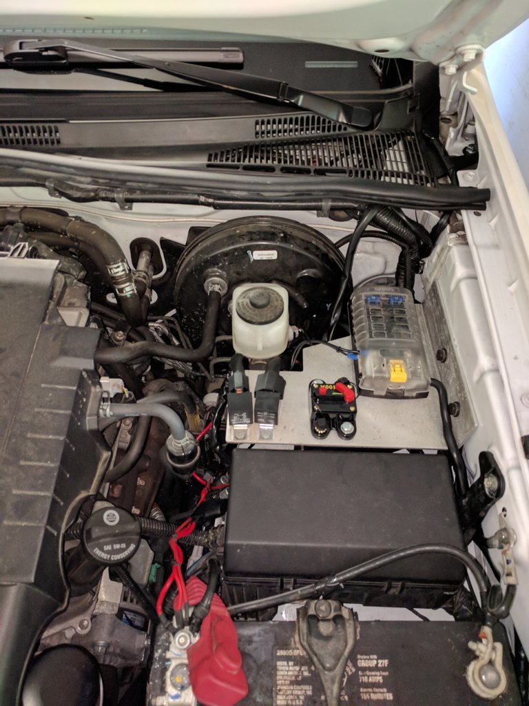

    Finally got started on the aux fuse setup. Now I need to figure out how to crimp the power wire I have.

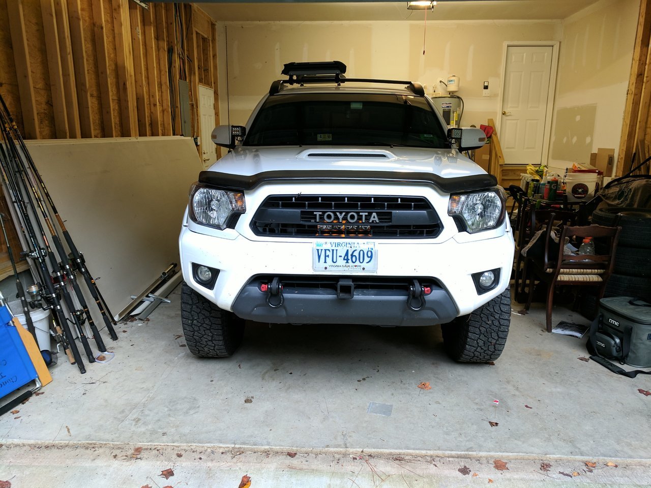

    Mobtown Recovery Bar installed!
