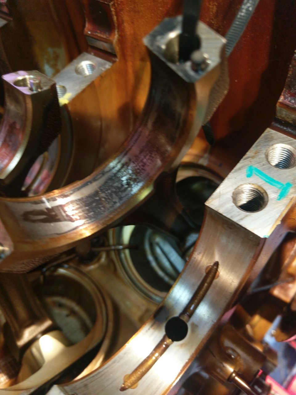

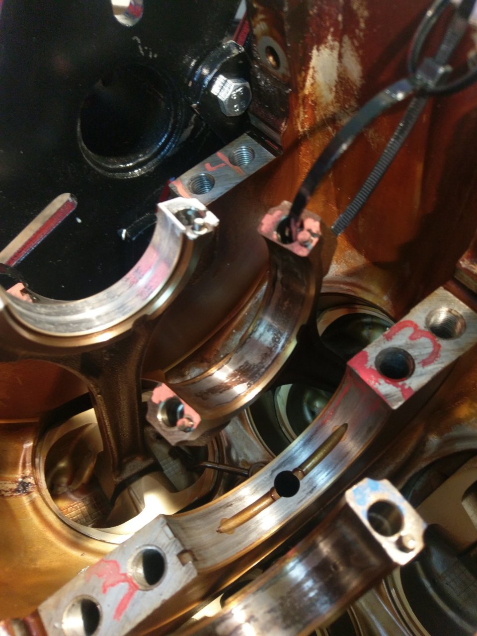

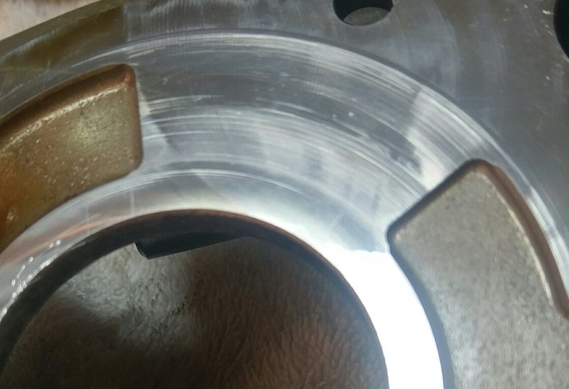

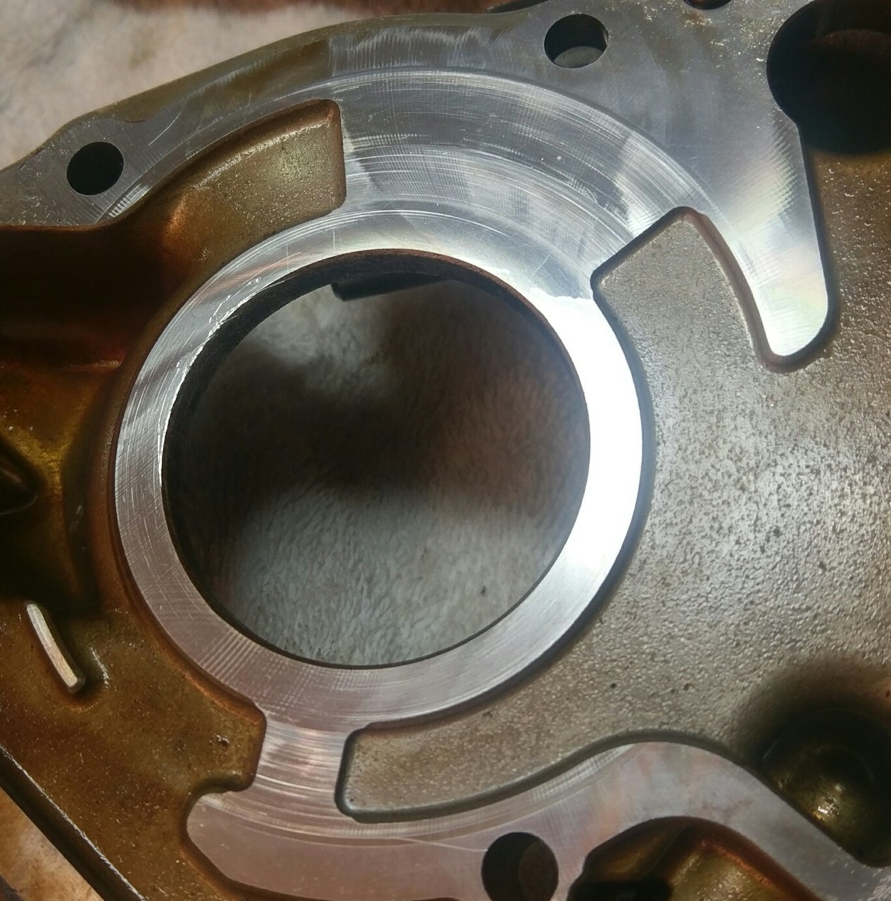

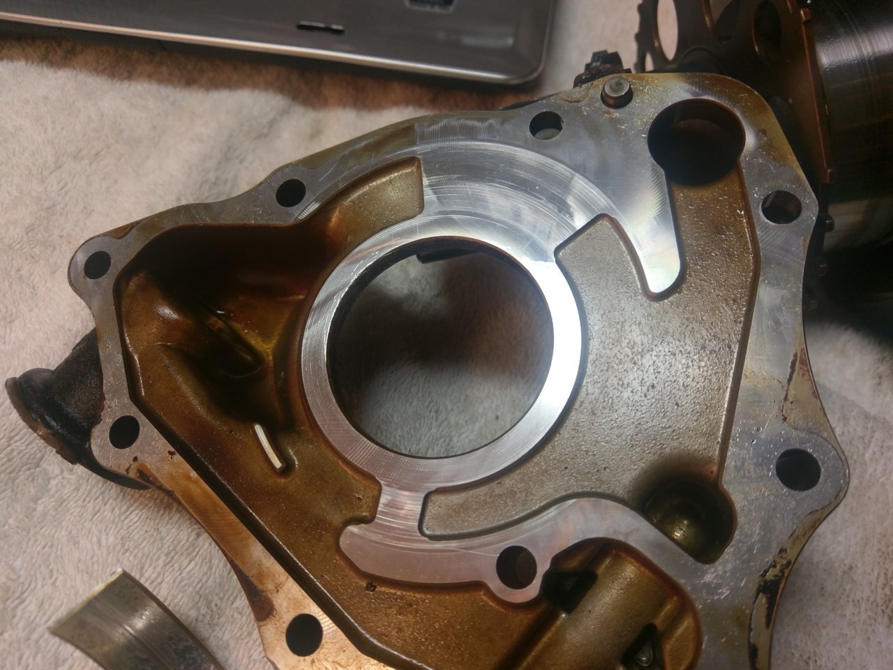

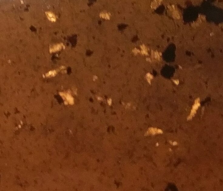

    This 1GR-FE had a good amount of aluminum in the oil and filter (see pic). Also has little plastic shards from worn tensioner. When I tore it down I found scaring on the rod bearings also. I think I found the original problem. The oil pump cover (pic) has some scaring.
    What do you guys think? If the aluminum isn't from the oil pump, where else can it be from.

    I would think that is the culprit. Looks to be worn is it grooved? It looks like it is.
    What do the gears look like?

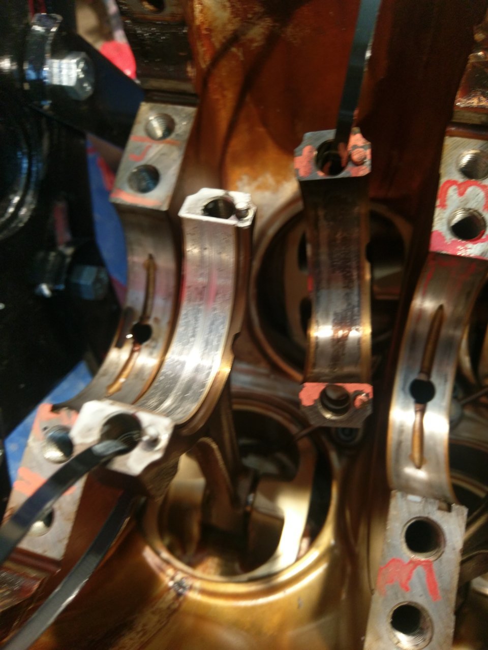

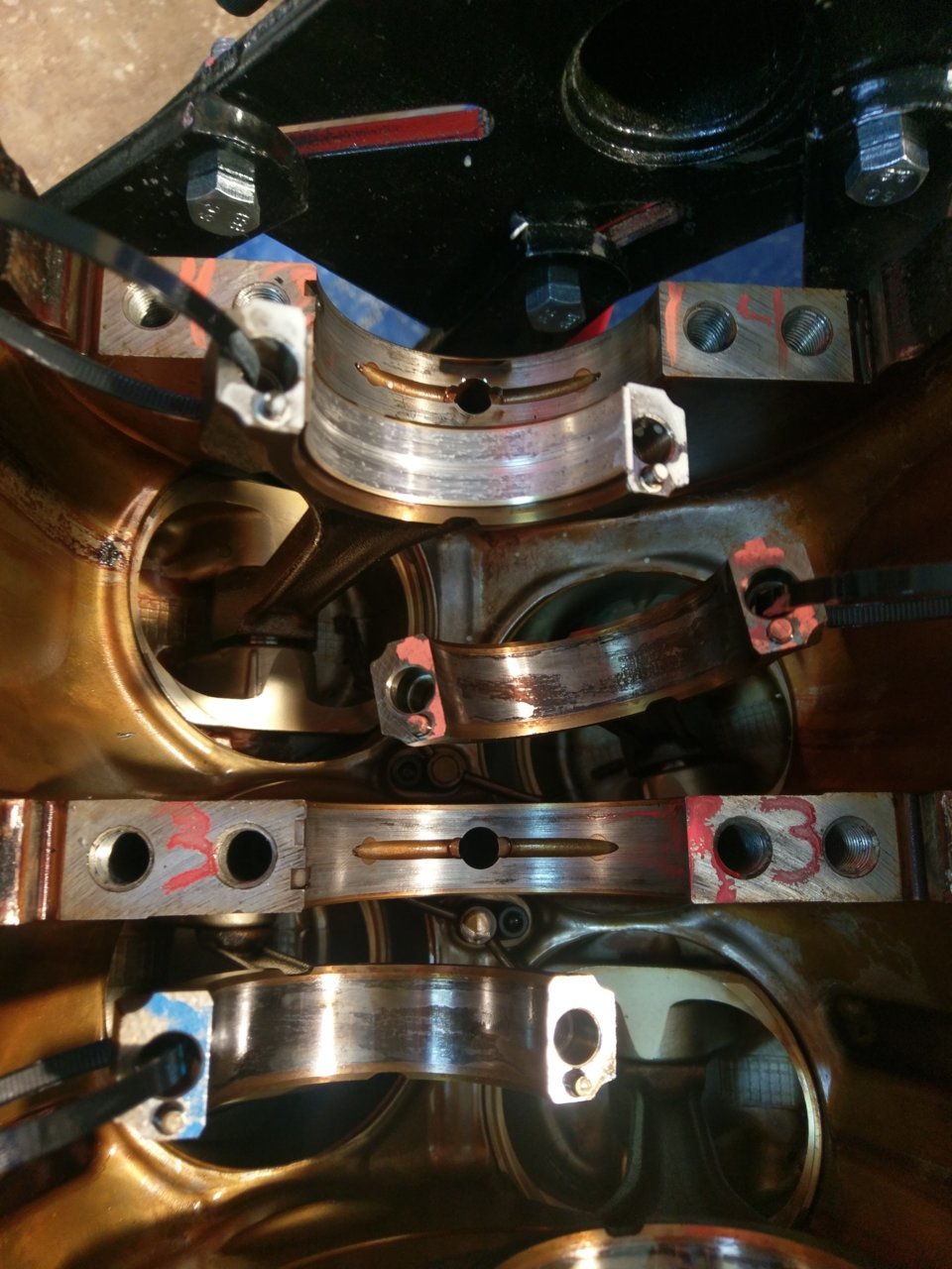

    Which weight oil do you use?

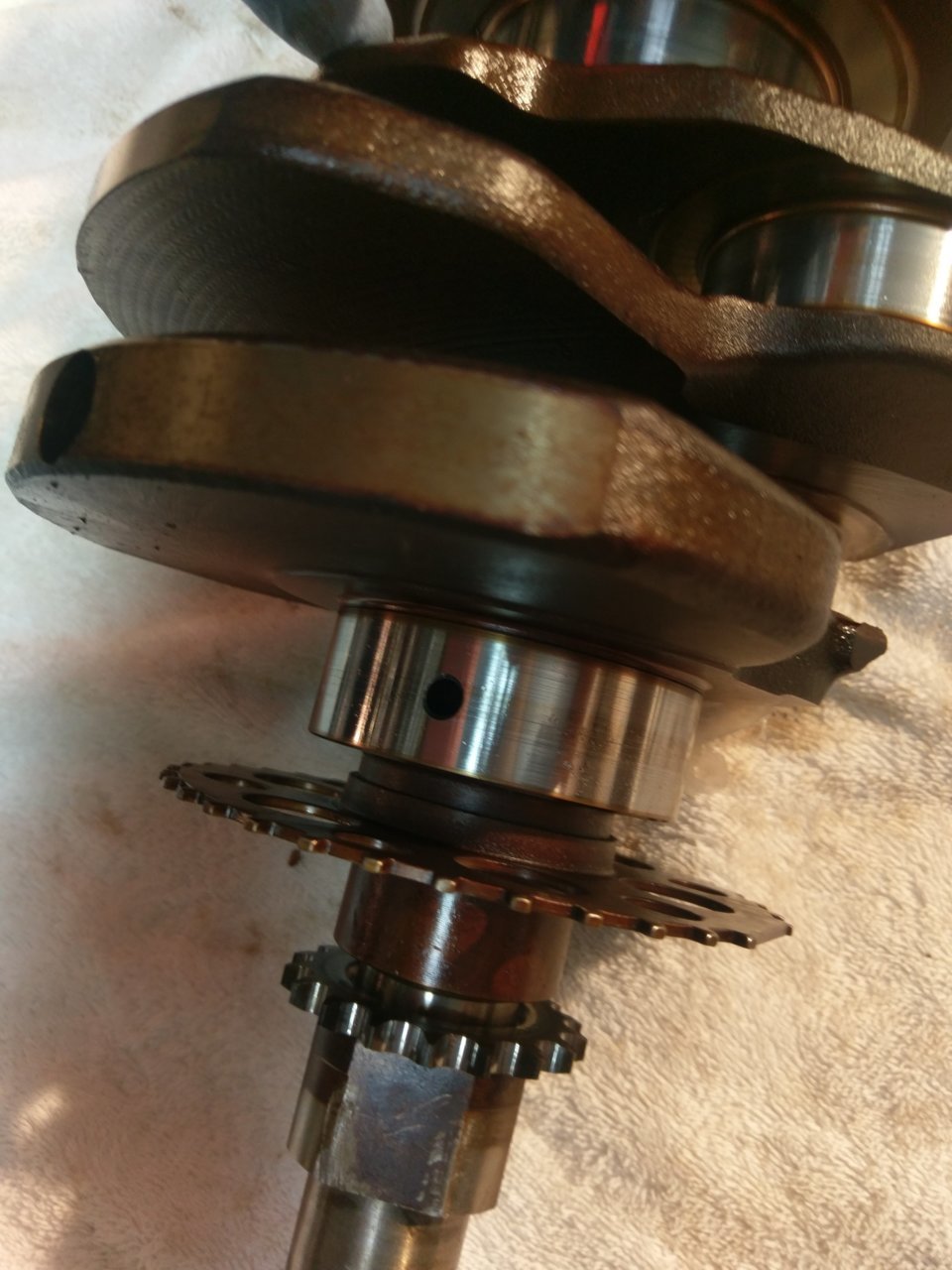

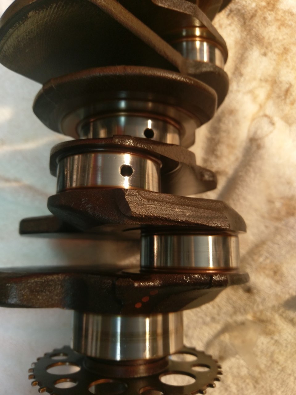

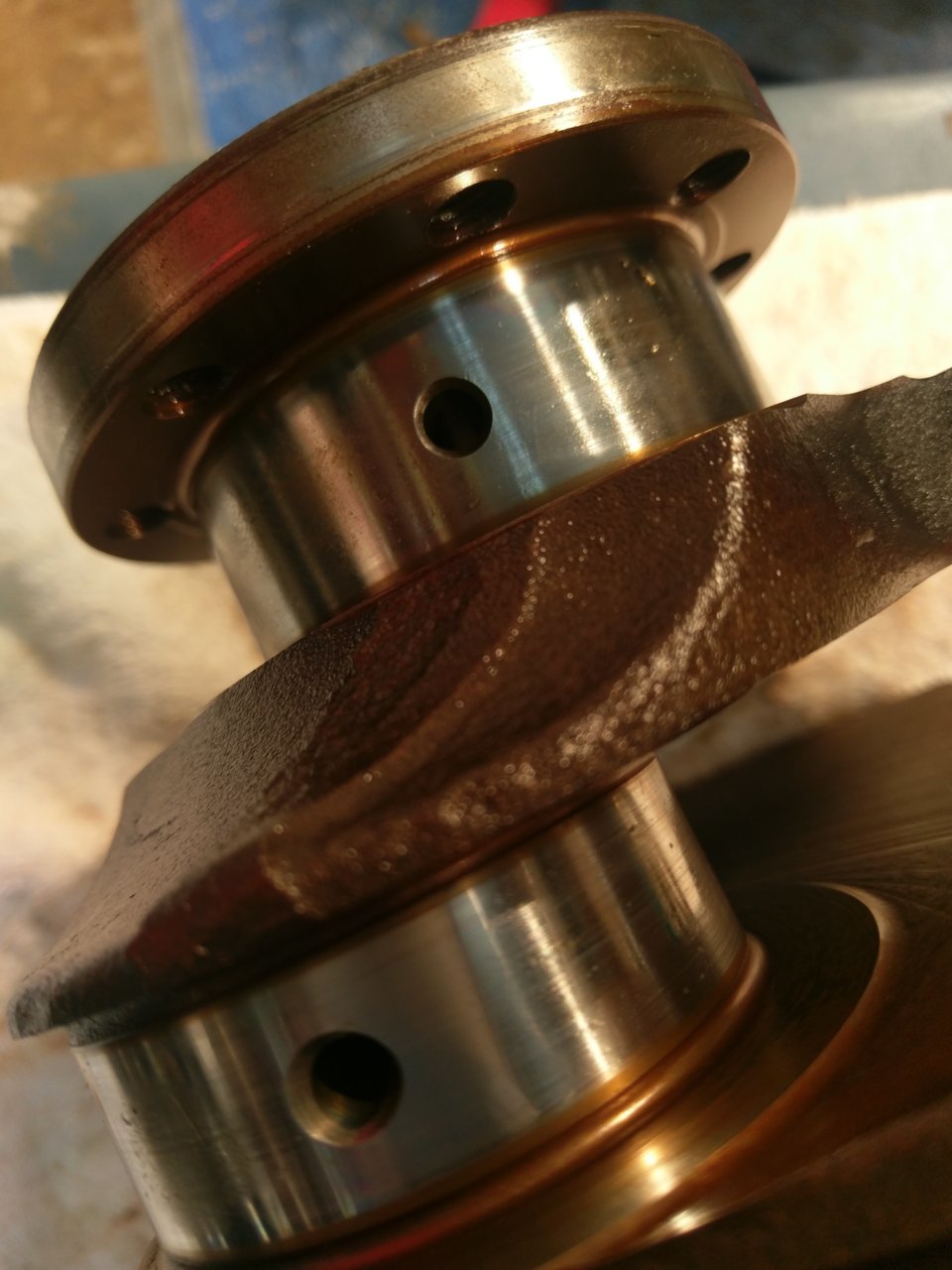

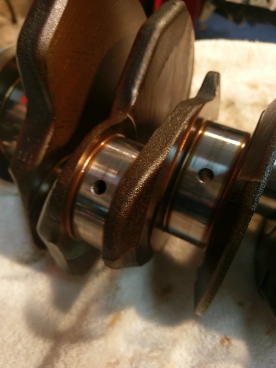

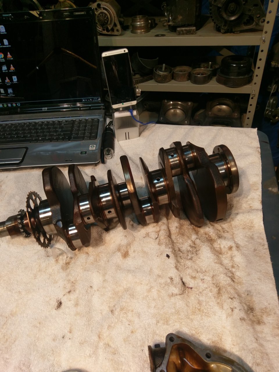

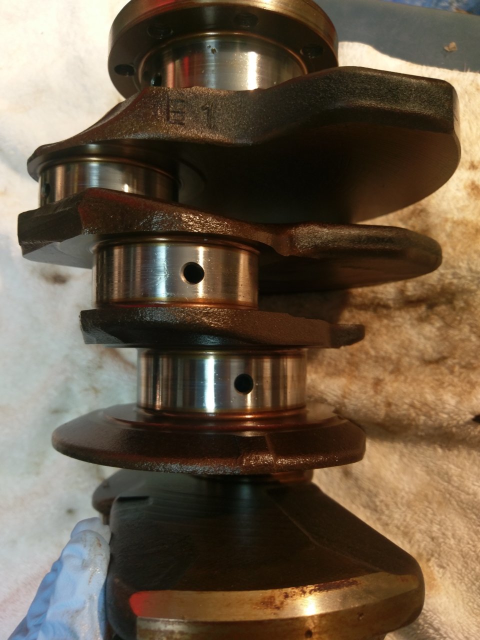

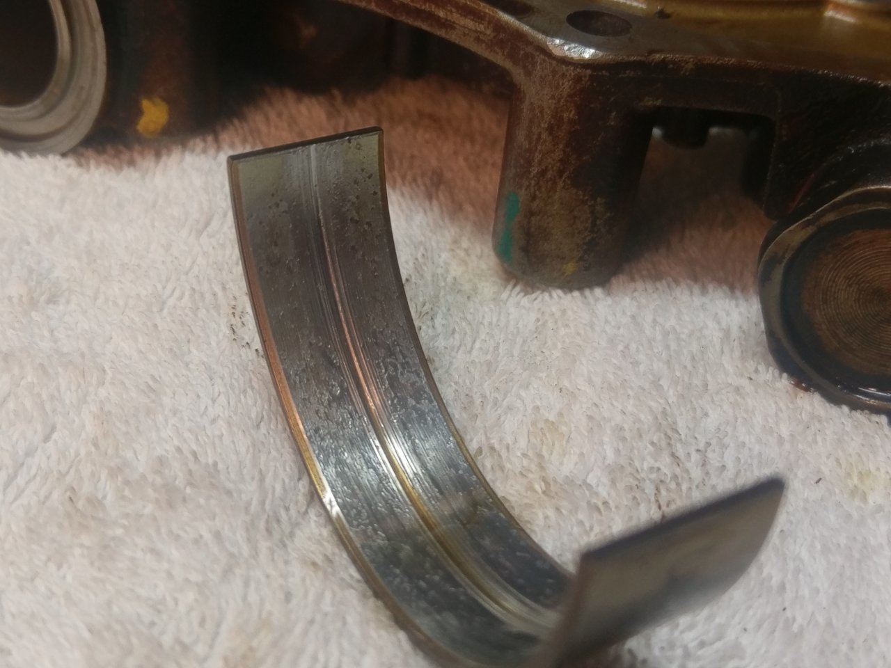

    Bearing material it seems. How do the rod journals look?
    Have you pulled the main caps to inspect the main journals and bearings?

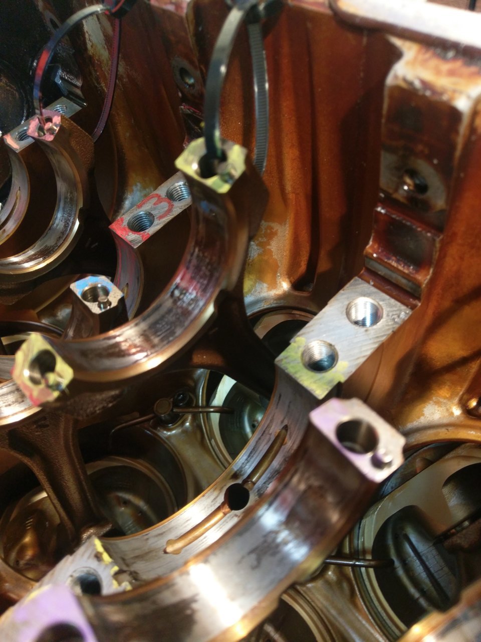

    The last picture appears to show a (smoked) main bearing.

    He said rod.

    Damn. Looks like it was run w/o oil for a while

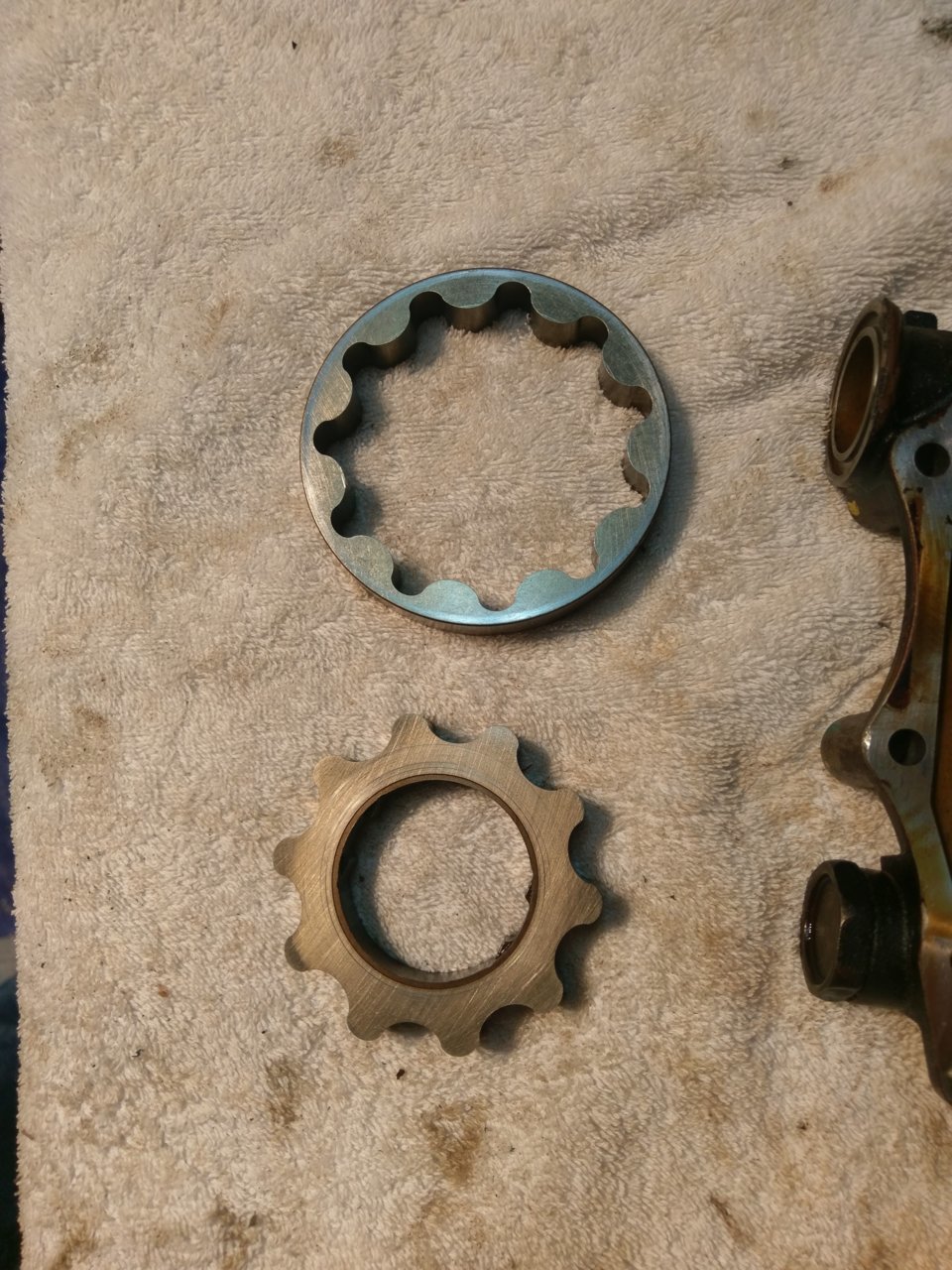

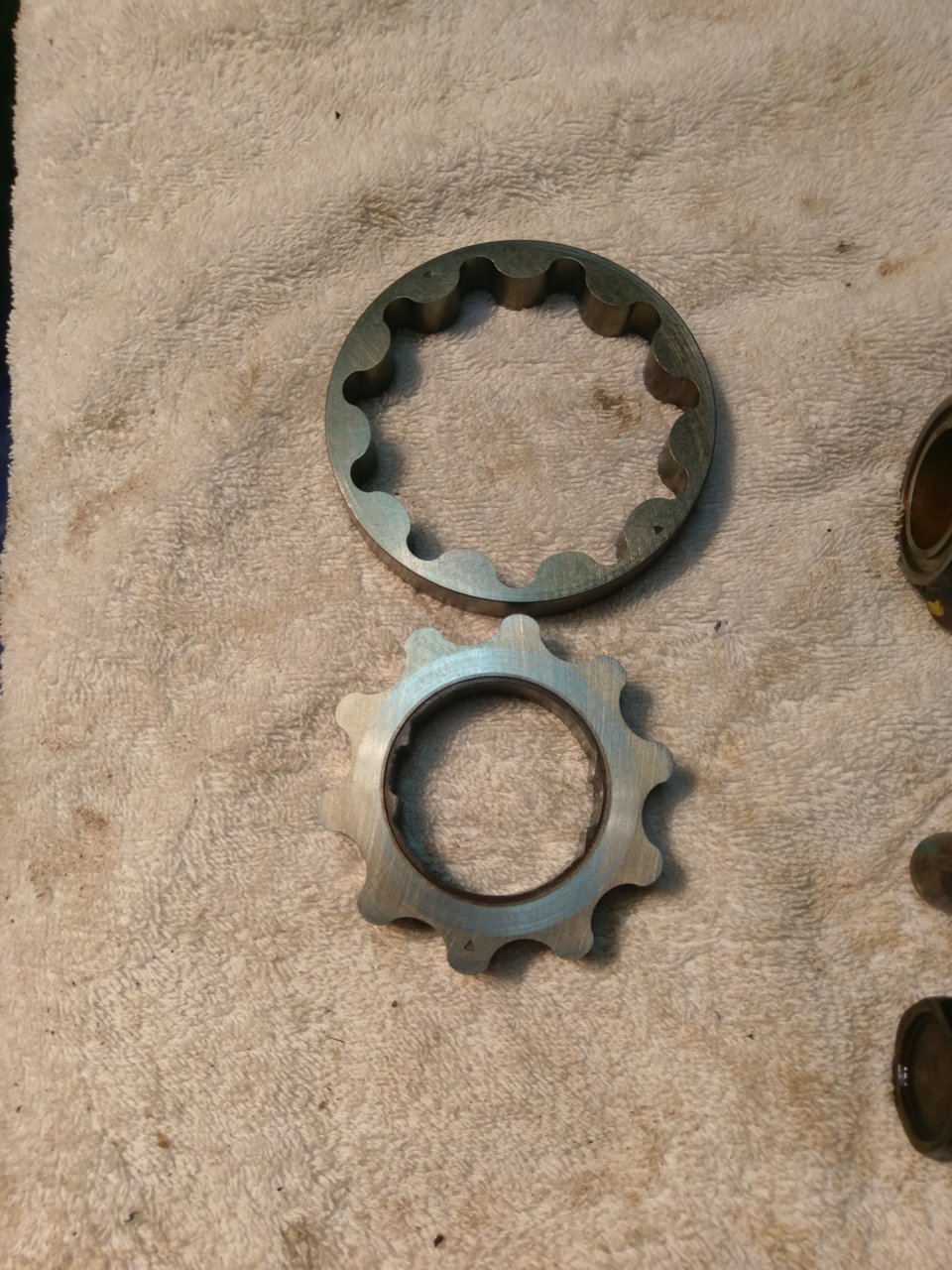

    The gears look good, I'll grab some pics. The grooves you can feel with a pic, barely with your finger, the surface is smoothed out in that area.

    Yes, is disassembled. I'll take some pics.

    This is just screen caps from video. I video, paint mark, bag, tag, and document every tear down , probably more so than CSI on TV, lol! Anyone teach me how to turn like 10 hours of video into one of those cool fast rapid still shot things, I'll show you how tear down a 1GR-FE.
    (as per Toyota spec)
