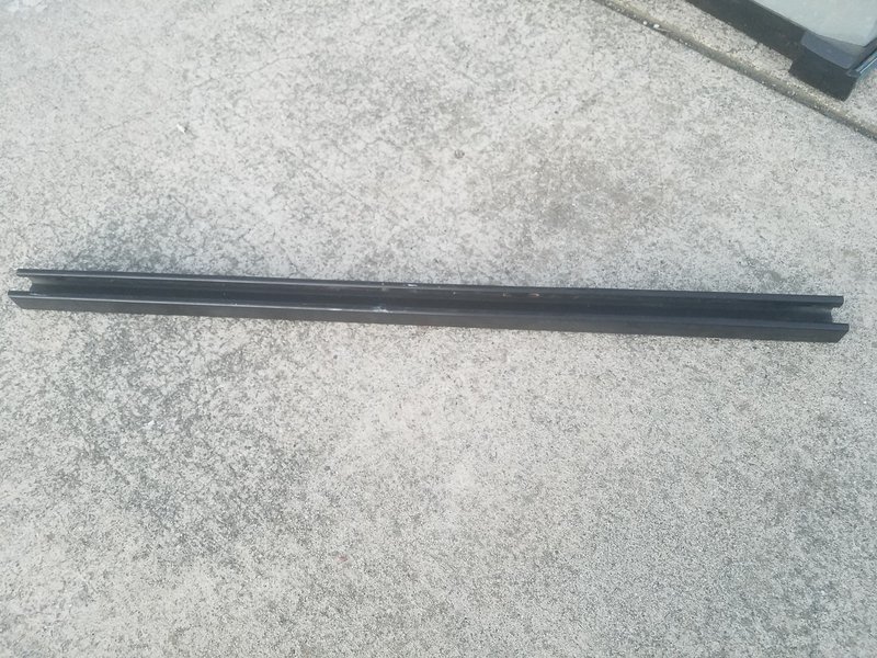

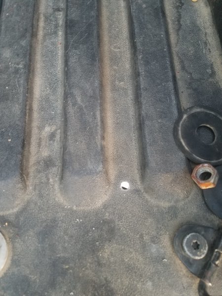

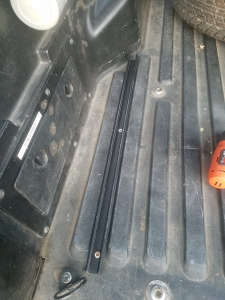

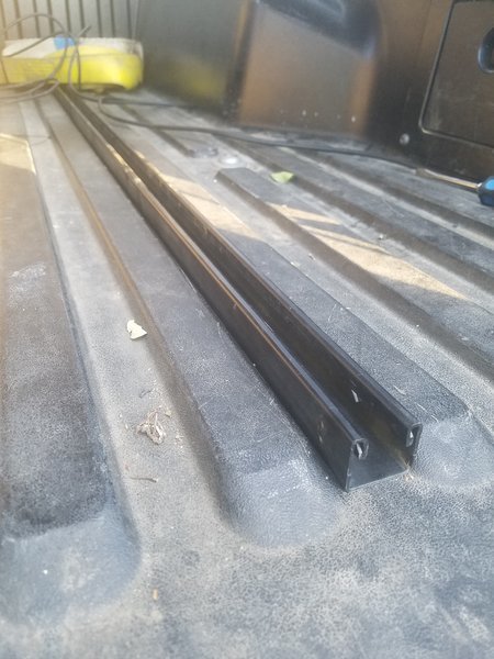

    Bed rail mounted to bottom of truck bed
    Got antsy about a project i've been thinking about doing for a while, so i did it lol.
    Took the bed rail off the bed (the rail below the rear window since i never had a use for it anyways)
    cut it in half
    figured out where i wanted them (each side of the bed in line with the edge of the wheel wells so they were "out of the way" but easy to get to and use) and drilled through the existing holes in the rails
    and then mounted them with some hardware i had laying around (those are bolts, not screws. they just have screw heads on them lol)
    now i just need to drill an additional hole at the far end of each one so i can secure that end down also. Probably going to use eye bolts and get some extra T slot nuts to throw in them to use as tie downs.
    i know i could have went and bought a rail tie down system but why not just use the rail i already have thats not being used

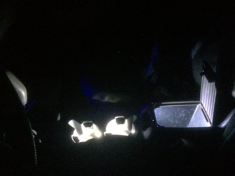

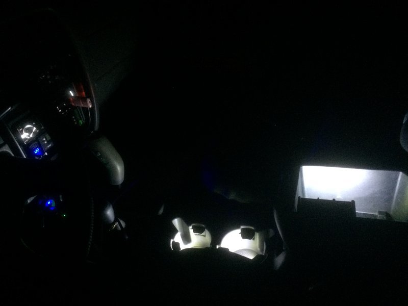

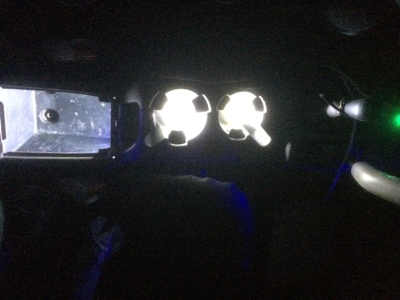

    kangs and thanngs
    Led cup holders and bottom/top compartments in center console. Bought the led strip at a surplus place and cut each section out for each place. Completely disassembled center console and hid wires.
    Total cost 9$ for leds
    Everything else I had
    Solder
    Wire
    Switch
    Connectors
    5 minute appoxy

    Woah that's sick, but are they super bright!? I feel like they would be too bright :spy:

    The center console (upper and lower) is the perfect amount of light. The cup holders are a bit bright at the moment. When I put the clear lenses over the holes it will defuse the light and then the cup holders will tame down bit.
