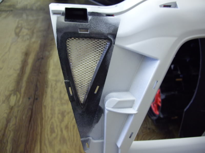

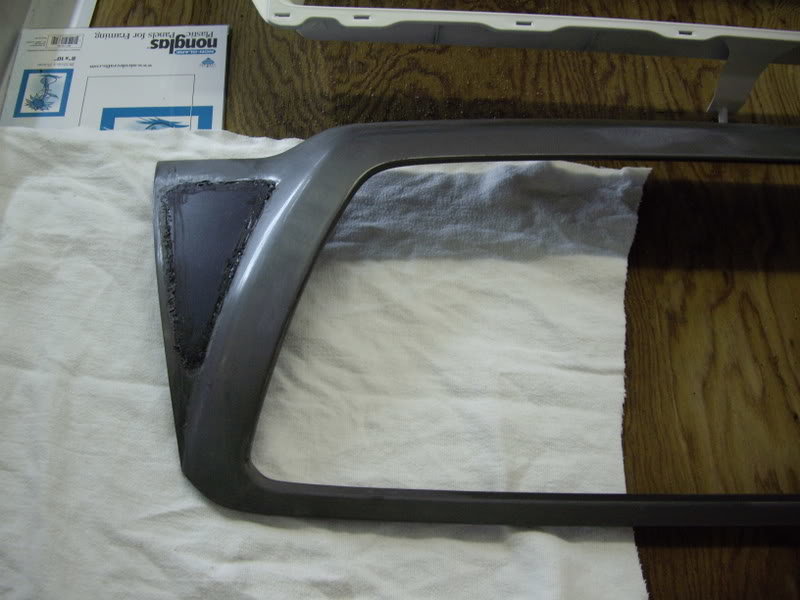

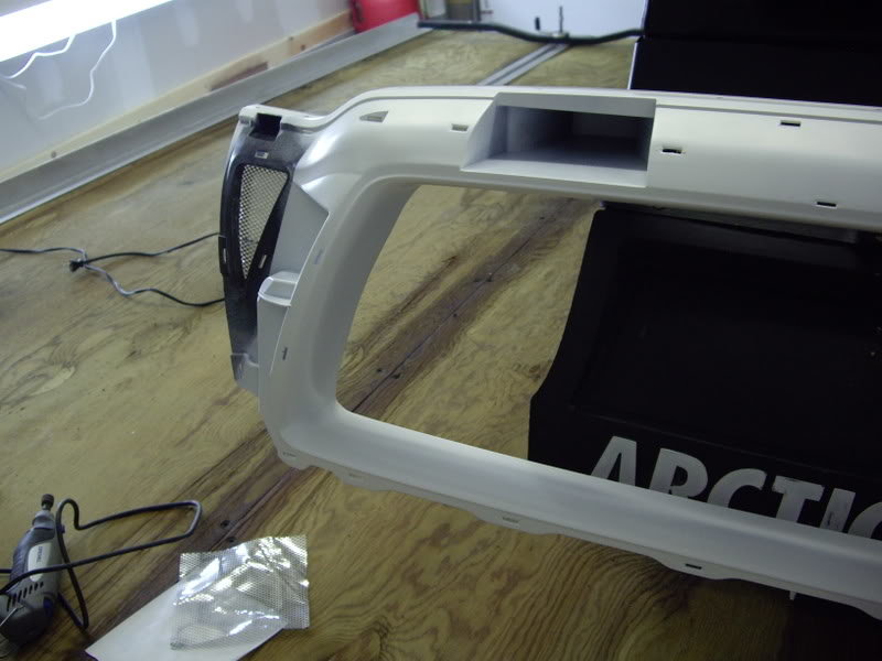

    Before I explain this mod that I am in the middle of, with two different versions of it, I have no clue where this mod got the name SATOSHI. Sounds more like something fishy off a Japanese menu. That said, now I will explain what I did so far with pics included.
    I have 3 spare grills to experiment with before I actually do it with the one on my Tacoma. I separated the outer shell from the inner one which I cut out the center to install a fine mesh grill similar to Grillcraft.

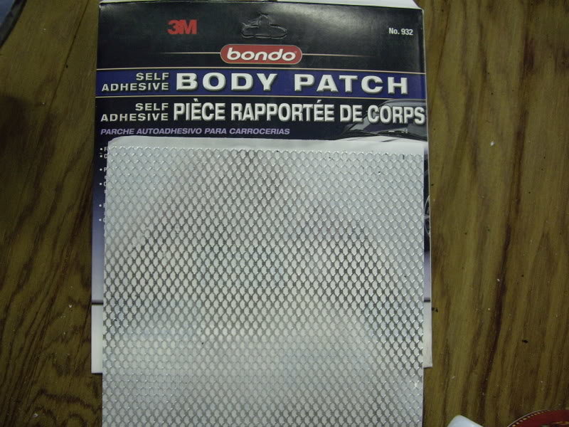

    The two fake side vents were cut out and replaced with 3M mesh patches, similar in design to the grill I am using. Its a lot cheaper than what T-Rex and other grill suppliers get for theirs. T-Rex costs $109. vs 3M $4.00. You can even get mesh grills in bulk for alot less than what T-Rex charges.
    I filled in the sides of the inner grill after cutting out the center section. In the second version, I filled in the side vents eliminating the fake grills altogether. I discovered pockets on the upper part of the inner shell that could be a great place to put driving lights. Located in back of the shell upper mounts. Another mod later on this one.
    Original factory paint was obtained from expresspaint.com. Told them the paint code and they shipped it out for $11.95 per can. So far I am into this for under 30 bucks including the body fill. There is approximately 5 hours doing the mod itself.
