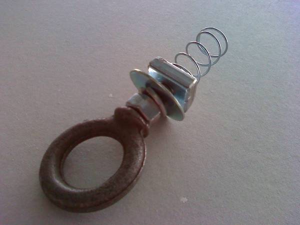

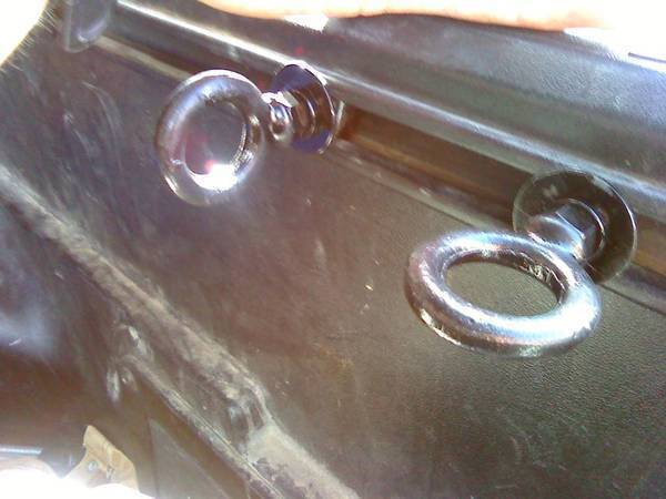

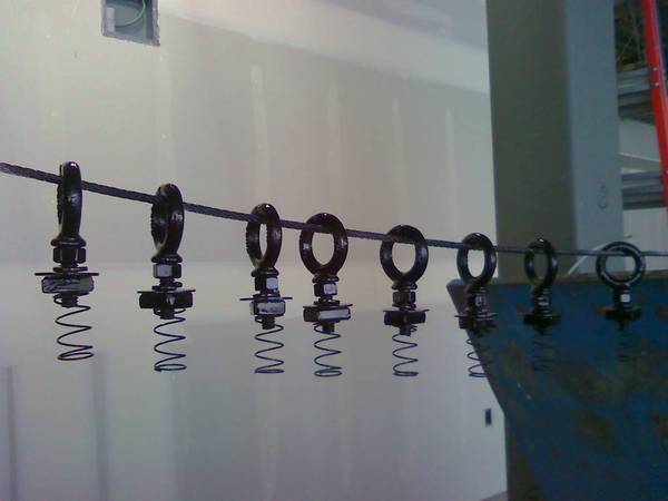

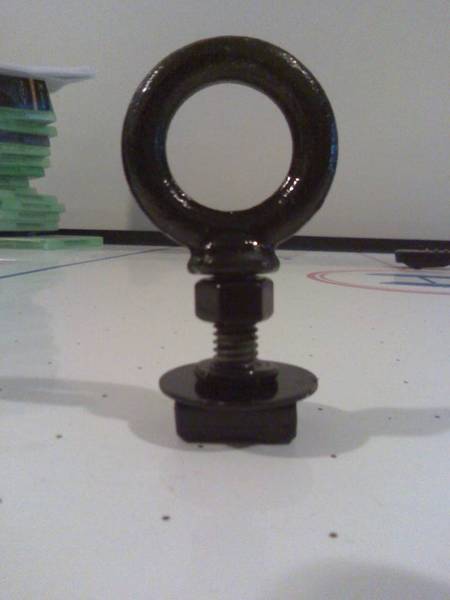

    I was bored at work today, hanging cable tray sucks. Decided since I have the perfect supply of materials and a grinder and bandsaw that I'd make some bedrail tiedowns. The weakest part (not counting the bedrail) is the nut rated at 1200 pounds, and the eyebolts are good for 1550 pounds
    "working weight". No more plastic tiedown cleats, fully adjustable, add as many tiedowns as you like.
    Thinking of mass producing these, how much would be a reasonable price to charge?
