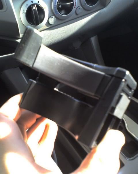

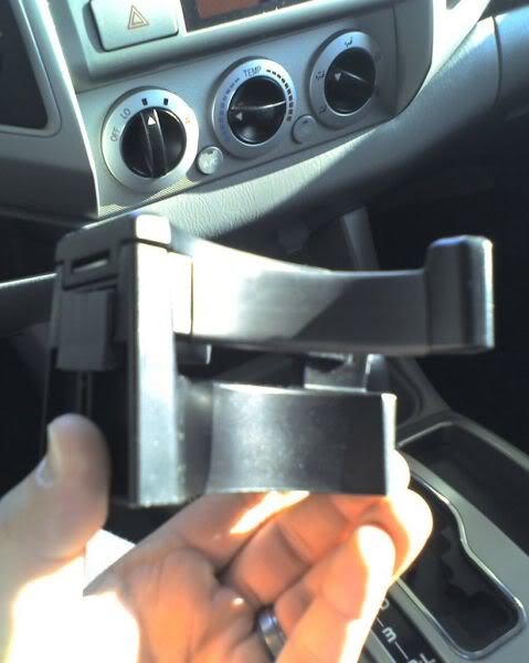

    Not sure about you but whenever I put a water bottle or similar bottle in the front cupholders the arm that swings out and is supposed to hold the bottle in place moves very easily and really doesn't do it the job way it is supposed to.
    I added 2 layers of shrink tubing on each arm and it actually holds it in place like it should. The arms can still close normally but not as easy.
    *In the pics you can also see some foam I added to the ends of the cupholder, this took away some of the interior rattles I had.
    RickTRDSport likes this.

    That is a pretty good idea. I hate those cup holders. They only seem to hold drinks from fast food places. Bottles just do not ever seem to fit.
